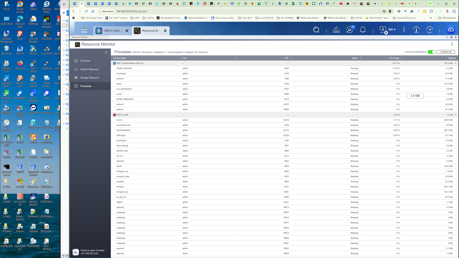

RTRR Daemon using over 17% CPU after HBS3 update

That NAS has for years run at 6-9 % CPU use. Since update of HBS 26-29% CPU use. When I stop and restart HBS CPU use goes back to 6-9%. Next day 26-29%. I will send logs for that one too.

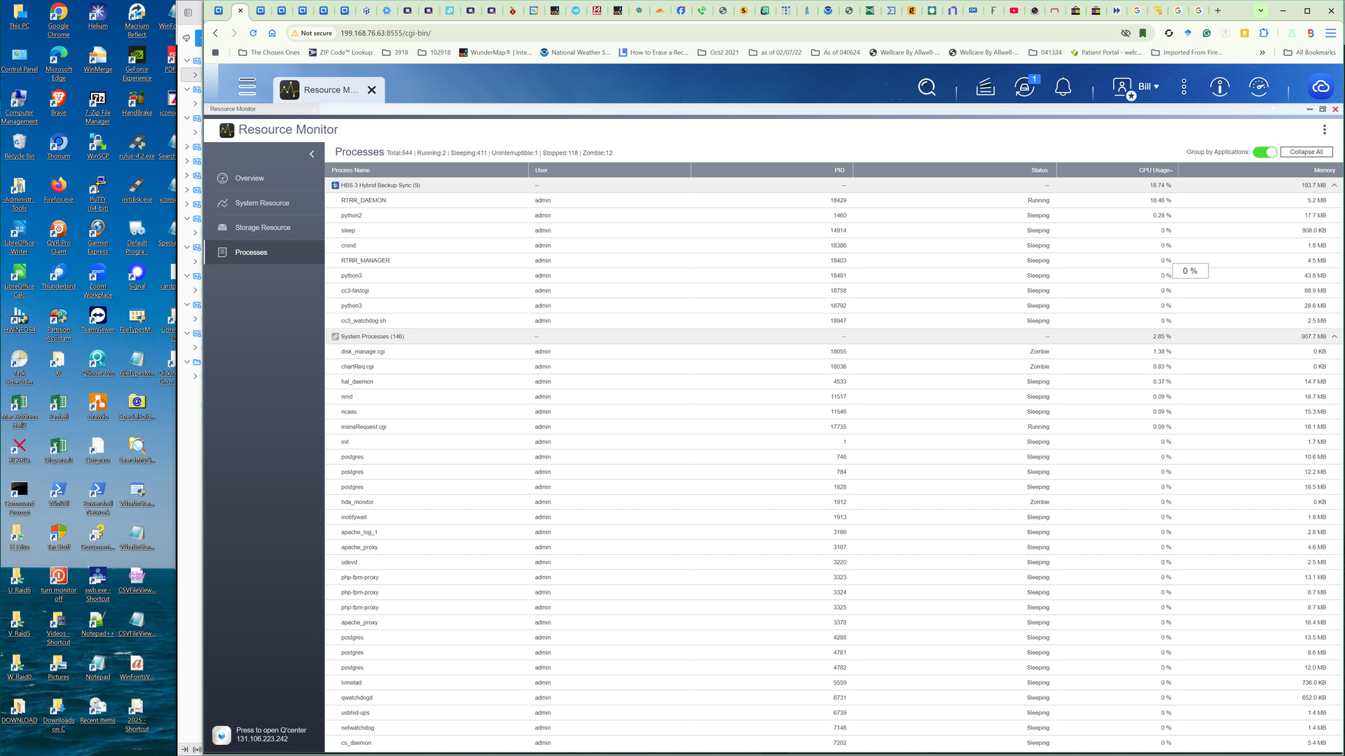

I spoke too soon. After 2 days, RTRR Daemon agin using 18% of CPU. New ports still working.

Spoke too soon again. After 2 days, RTRR was again using 17-18% cpu. This NAS had RTRR server turned off. I turned RTRR server on and after 2 days, total cpu use is ~7%. QVR-472XT. QTS 529..3499 latest version of HBS.
