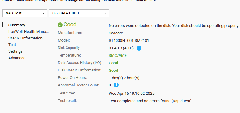

The new HDD seems healthy:

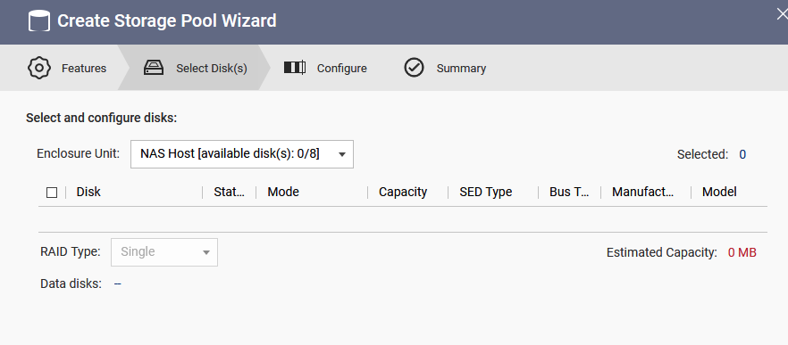

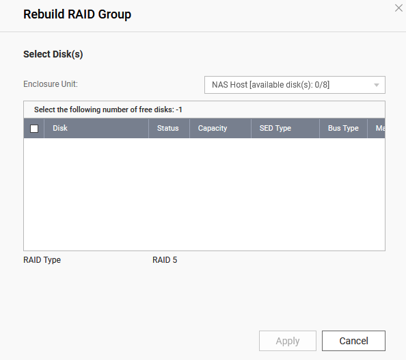

But, I cannot rebuild the RAID or create a new volume because, the the new HHD does not get listed on the relevant pages:
the fresh disk should have been swapped into the degraded RAID (when the busted disk is ejected) automatically, no user interaction would be required
I guess something went wrong when I first inserted the new drive as the HDD got partioned wrongly. I had to clear the HDD with
dd if=/dev/zero of=/dev/sda bs=512 count=1
and rebooted the qnap. After that the raid began rebuilding itself automatically.
