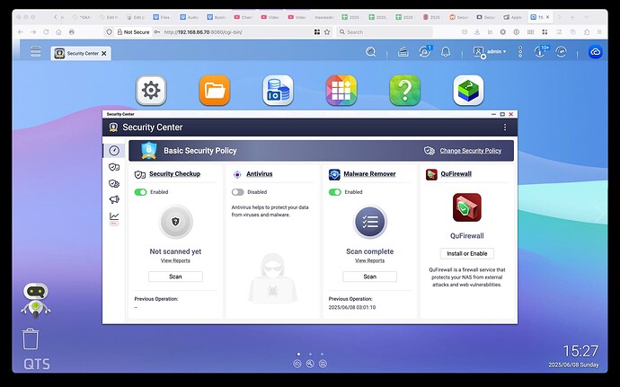

I have the same issue as Brodie, on my TS-231K (my TS-328 and TS-453Be seem to be fine). I start Security Check, it sits there at 0% complete for a few seconds, then quits with no indication of what’s wrong. Security Center and firmware are both at latest available versions. On a hunch, I did a file system check, which passed.

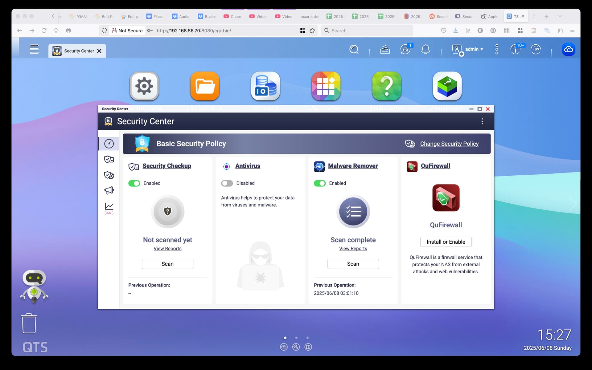

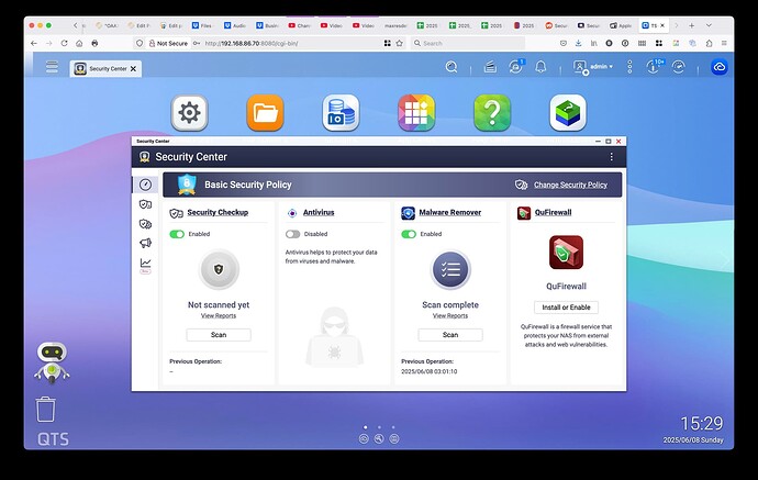

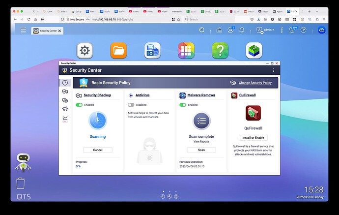

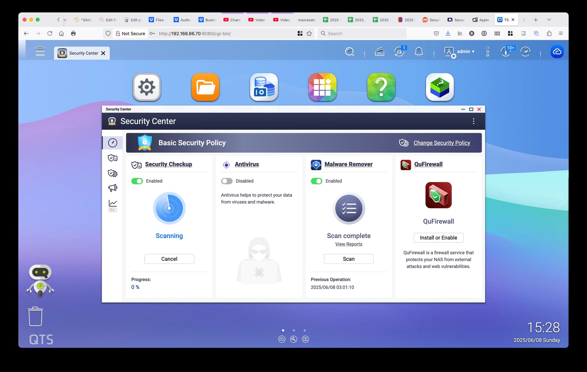

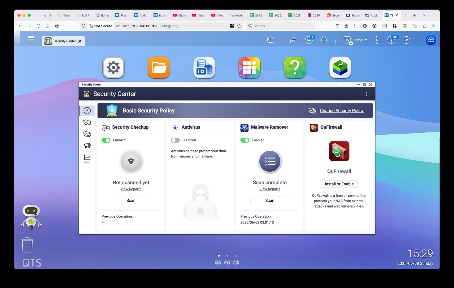

See attached “before”, “during” and “after” screenshots. It “runs” (if you can call it that) for 7 seconds, always at 0% completion, before it quits. It indicates “not scanned yet” because I’ve uninstalled and reinstalled Security Center in the process of trying to fix this, and existing scan logs apparently got wiped by the uninstall.
