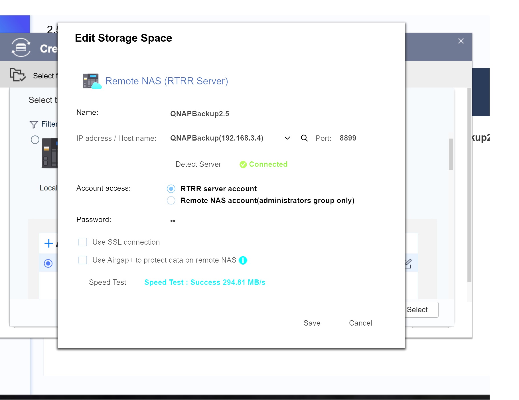

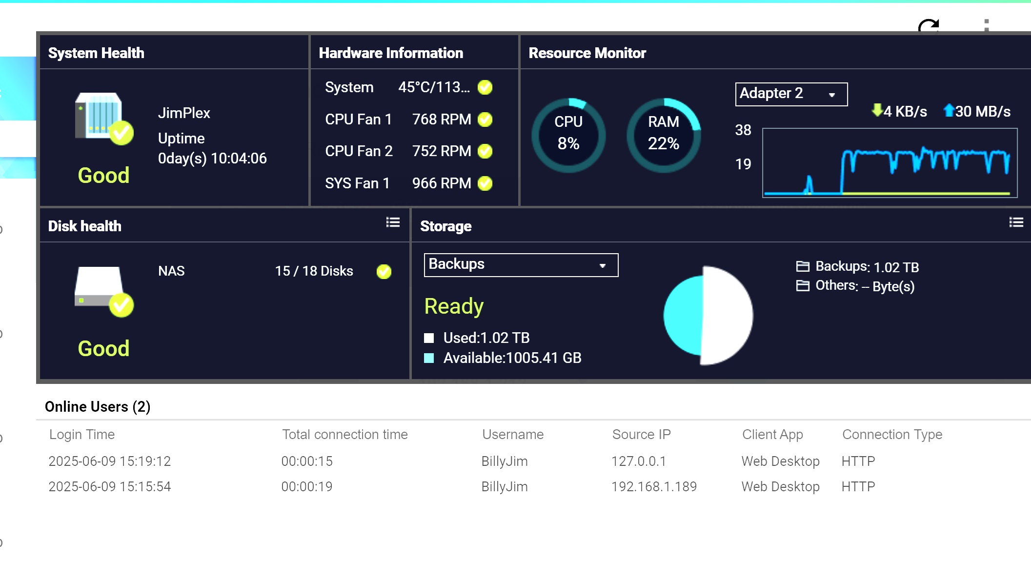

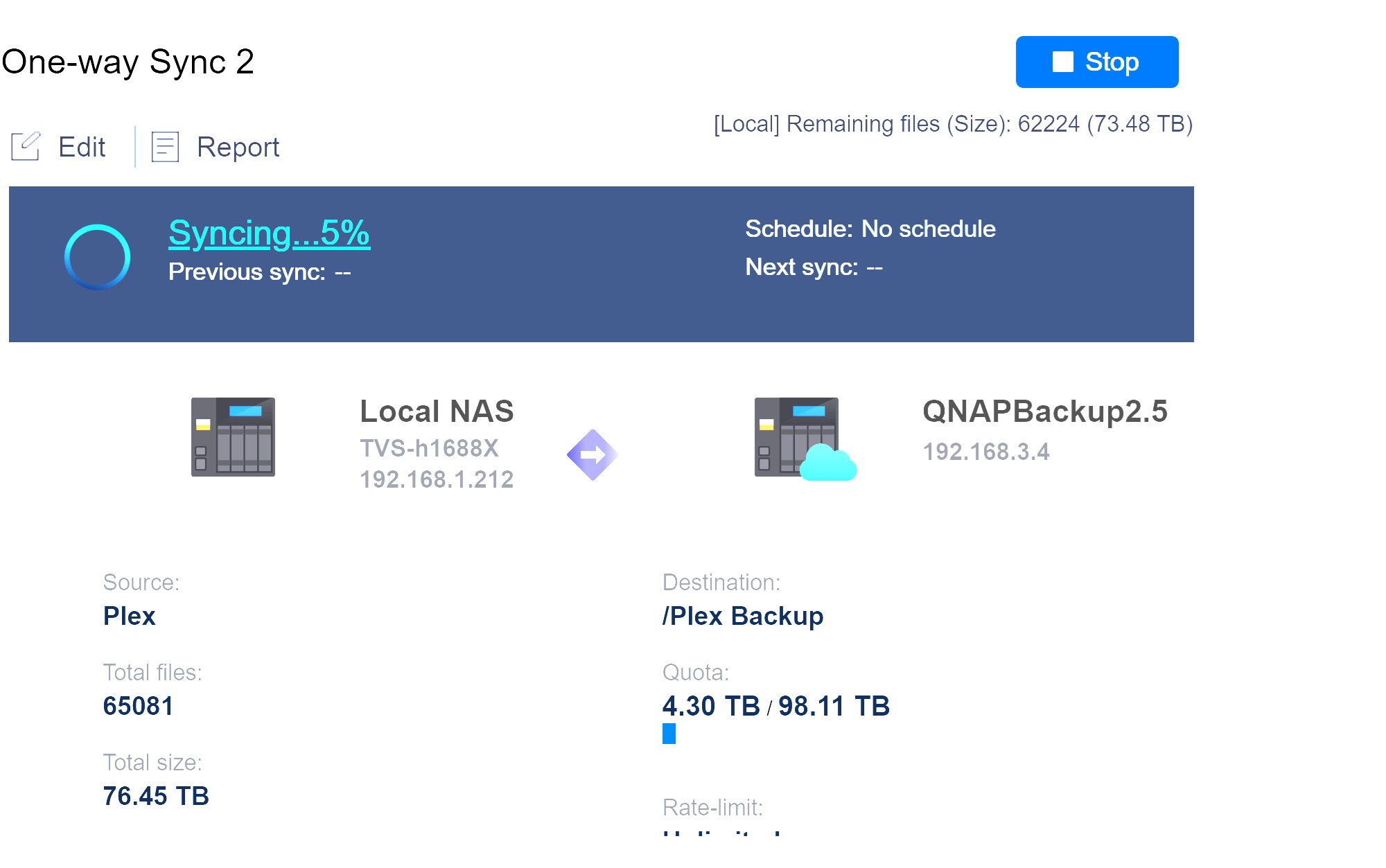

I did the upgrade and found out Plex is not fully compatible now. My 1288 has 48GB RAM, 2x1TB M.2 SSD Cache, 8x16TB RAID5, 3x250GB SSD RAID5 system pool. My 1688 has 128GB RAM, 2x2TB M.2 SSD Cache, 9x16TB RAID6, 3x500GB SSD RAID5 system pool. Both are running Hero 5.3.0. I also have a TV-869 8x16TB RAID6. HBS one-way sync from the 1688 to the 869 nets 100MB/s. to the 1288 60MB/s regardless of the interface used. The RTTR Speed test on the 1688 to the 1288 via the 10GB cards yields 1GB/s but the transfer is only 60MB/s.
UPdate Okay so now I’m attempting to sync from the 869 to the 1288. Both ports on the 869 are bonded and still only 60MB/s. It has to be an issue with Hero, doesn’t it? The sync from the 1688 to the 869 earlier netted 100MB/s. With 70TB of video to transfer I’m in for a LONG wait.

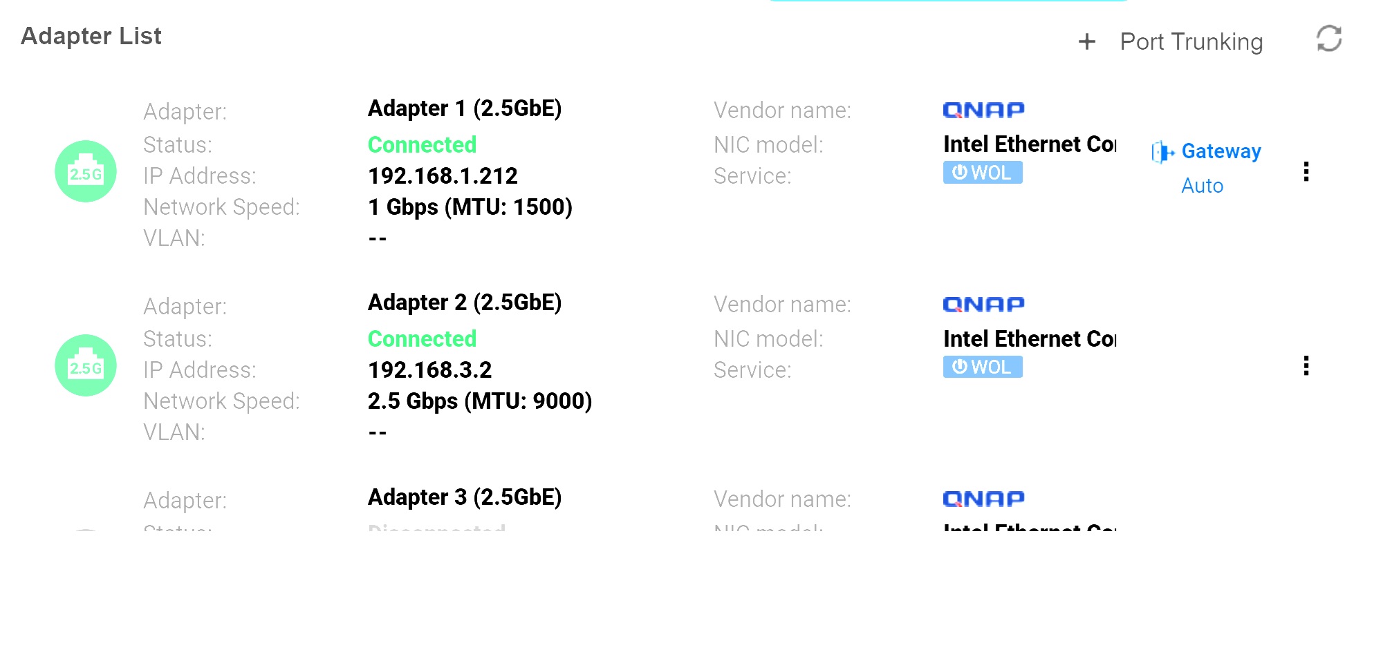

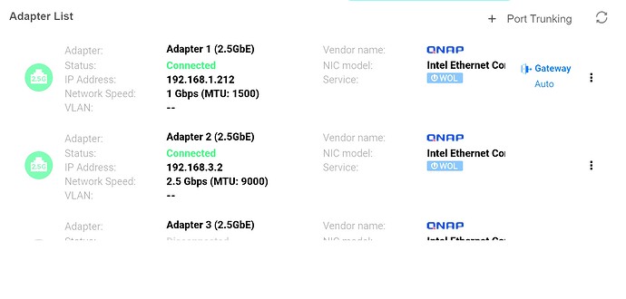

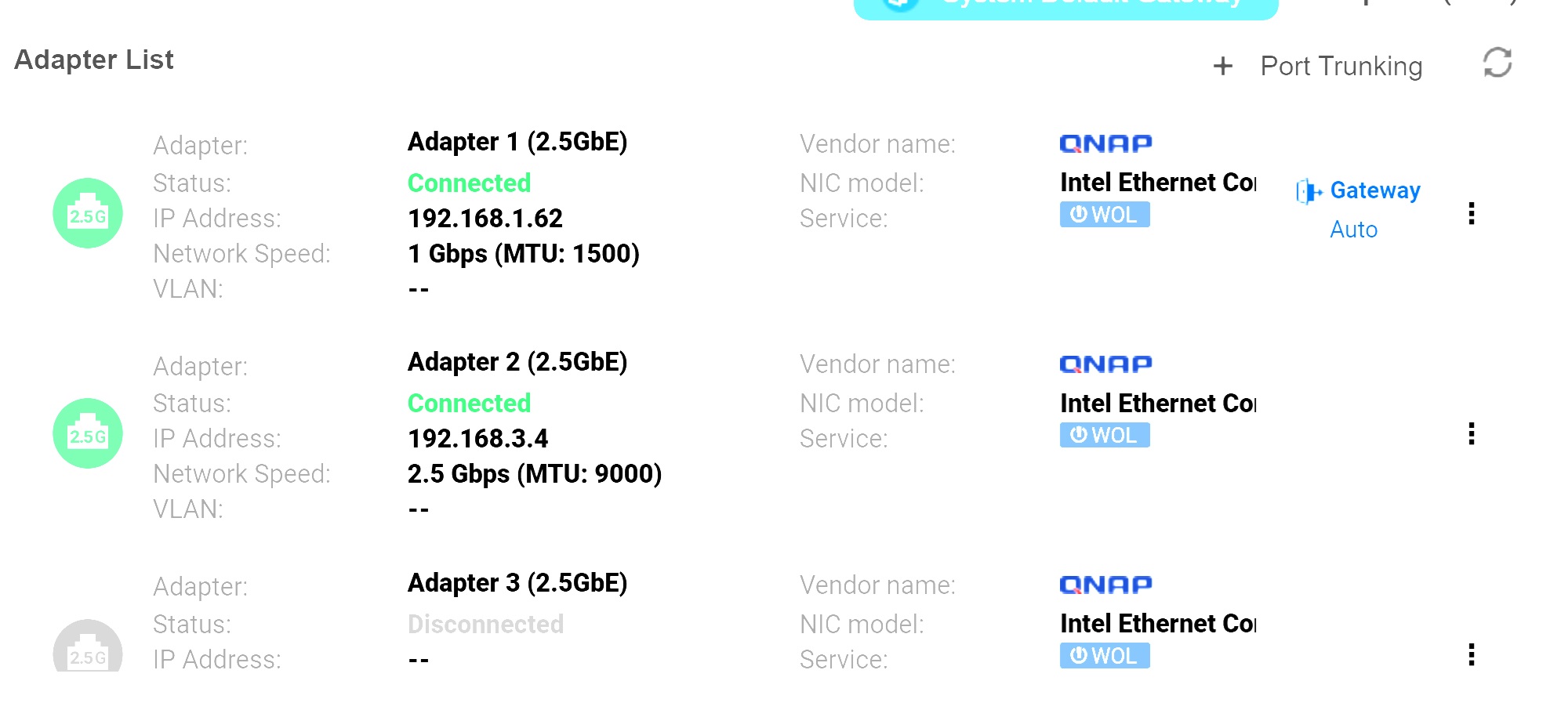

UPdate 2 Okay so now I’m attempting to sync from the 1688 to the 1288 via the 2.5GB port. Now I only get 30MB/s. The HBS speed test was 290MB/s Haven’t I eliminated hardware issues? It has to be an issue with Hero, on the 1288, doesn’t it? The sync from the 1688 to the 869 earlier netted 100MB/s. and it only has 1Gb port. I am open to suggestions. At this rate I figure about a month to transfer my library.

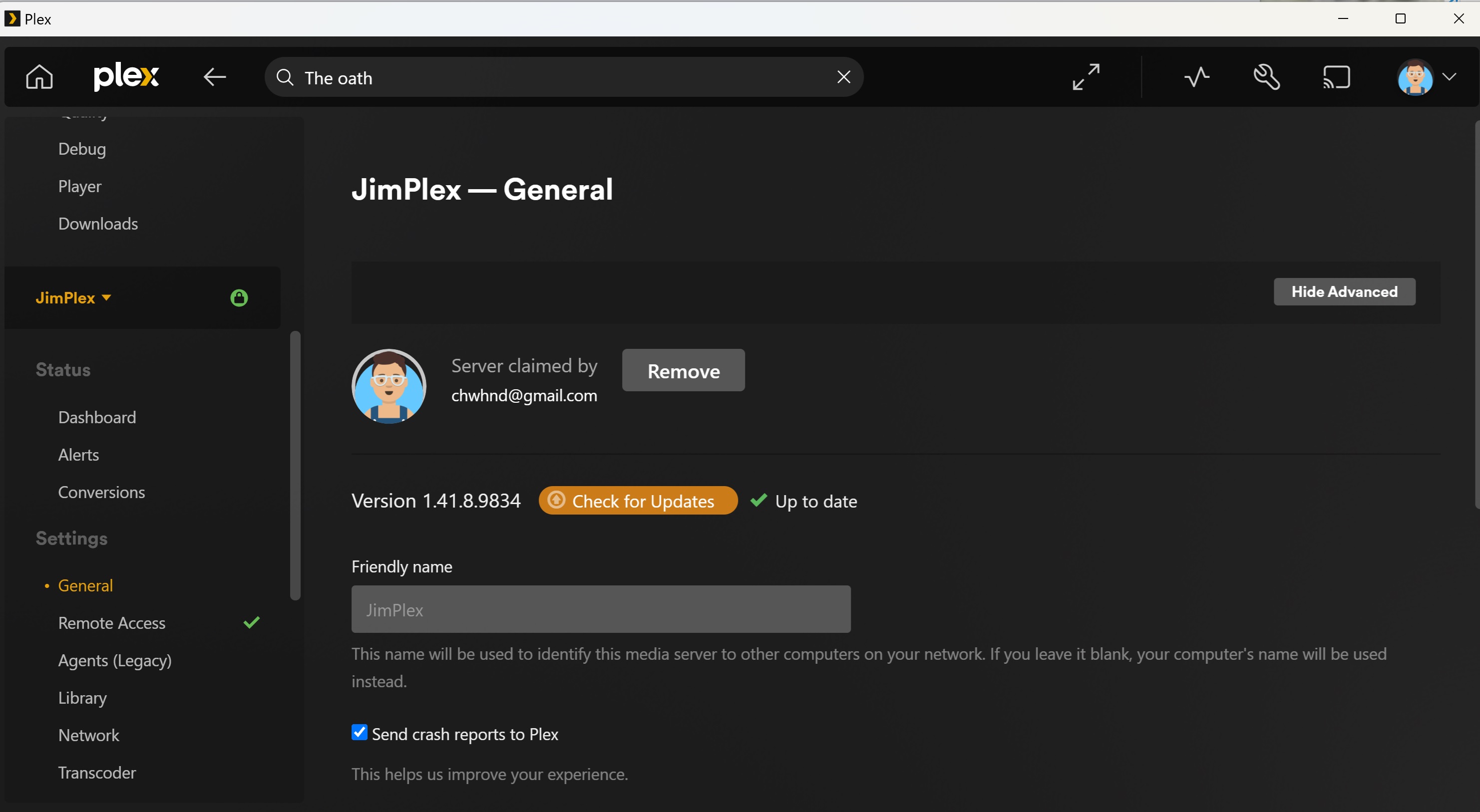

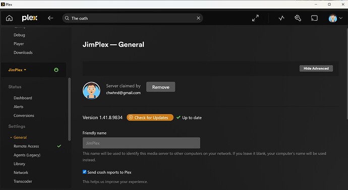

@NAS-JIM - you mentioned the upgrade is not fully compatible with Plex now? Can you elaborate on that? I have a TS-h1887XU-RP and I have a number of remote Plex users I wouldn’t want to disappoint.
Actually just a quote from the upgrade notes I haven’t noticed any issues whatsoever
I cannot find a reference to that
here’s what I see when I open plex
Are you using Plex.qpkg from the Plex website or the outdated qpkg from QNAP’s AppCenter ?
The general RC notes for 5.3.x have many features missing, my guess is all apps that are not found in below notice will cause this popup.
I believe I’m using the current version PlexMediaServer-1.41.8.9834-071366d65-x86_64

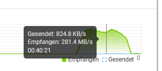

I did a bit of testing (added an intel x550-t2). The results suggest that the networkstack might be a part of the issue.
With Intel X550-T2 pc > nas is atleast at 280MB/s.
