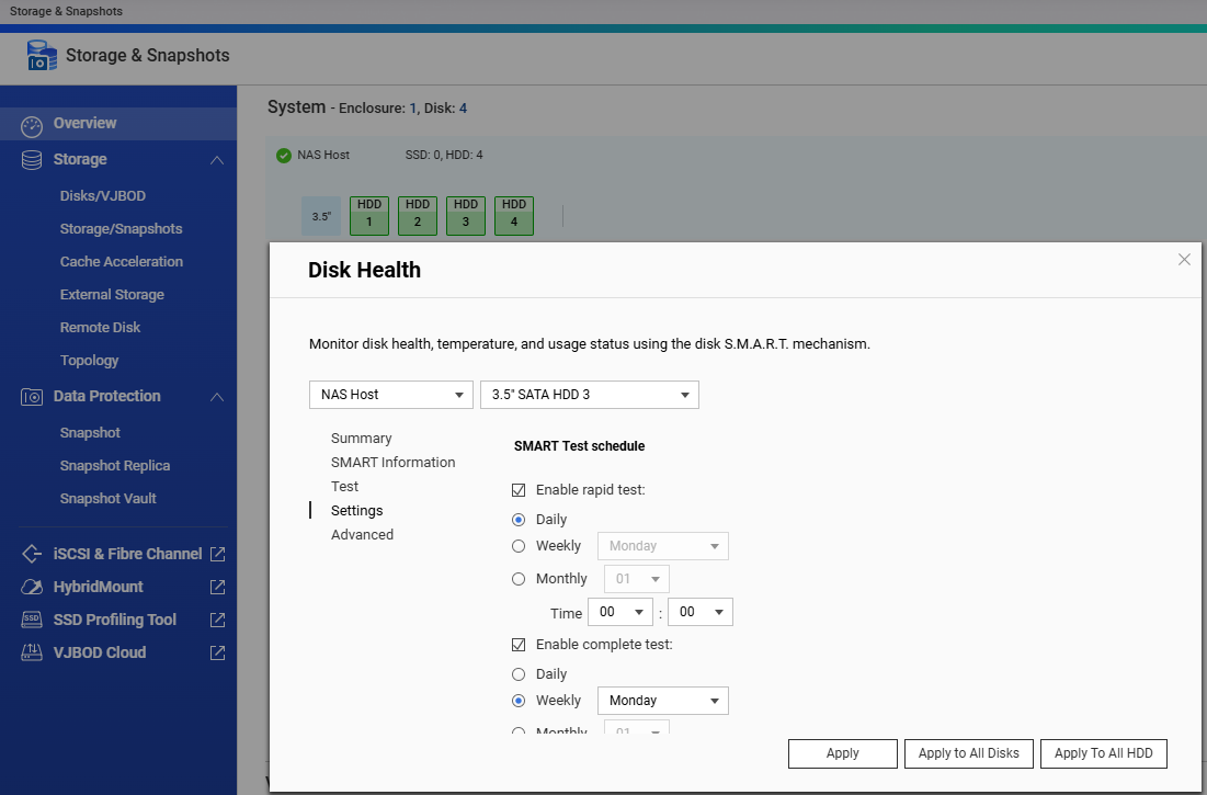

Folks,
I wonder if it is better to set the below SMART testing (Thorough) as daily or monthly?
Will this have a detrimental effect on the disk’s lifetime, or is it better not to run it since RAID will take care of the drive anyway?
Because this feature QNAP DA Drive Analyzer app can only be used with paid subscription for each drive only.
Any suggestion will be greatly appreciated.
Between the built in functions of the drive and the RAID monitoring of the NAS, you likely don’t need to run the tests too often, but it is really a personal user choice.
The quick test doesn’t take long or many resources, so I run this weekly.
The full test can take quite long depending on the size and speed of the drives and NAS that you have, but I find, for my purposes, that it is worthwhile to run monthly.
Of course if you run into or suspect other drive issues you can change the frequency of the testing as required.
