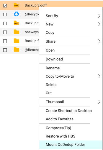

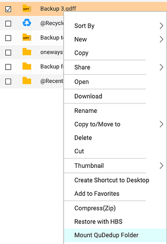

  1. Mount the File: In FileStation, right-click your .qdff file and select “Mount QuDedup Folder”.

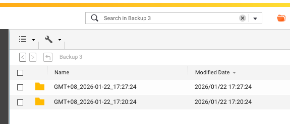

  2. Access Versions: Once mounted, you will see all backup timestamps as individual folders (e.g., GMT+08_2026-01-22...).
  3. Search: Use FileStation to search the exact file you want.

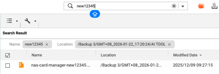

The idea is good and would be conceivable as a workaround. In fact, I have already tried it before. Unfortunately, it doesn’t work. This way, I can’t find a file that is included at least once in the backup. I just tried the test again with another backup and another file—again without success.

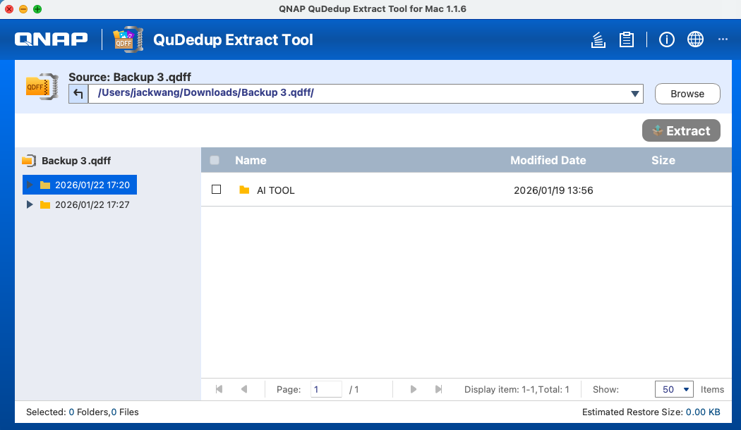

In general, it should work anyway with the desktop tool QuDedup.
But did it work for you that way?
QuDedup Tool can still function normally. However, unfortunately, QuDedup Tool does not offer a search feature, which is why I recommend you use FileStation.
That’s all correct, QuDedup works in a very rudimentary way. But there’s no search function, hence my feature request. And in File Station, files that I know are definitely present are not found when searching through an entire archive—so that doesn’t work either. That’s why I’m asking if it works for you or anyone else.
