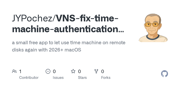

this bug is really frustrating !

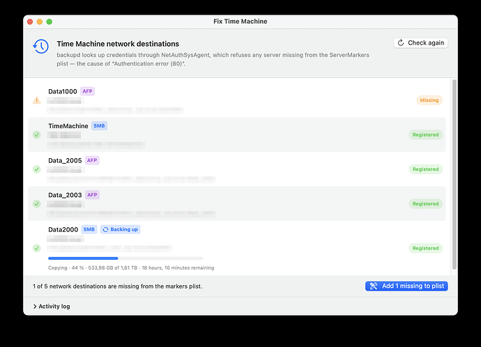

I made a small free app to fix this
