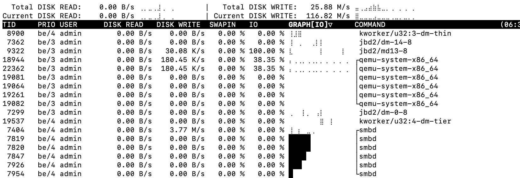

I installed IOTOP, and the most IO consuming processes are : smbd and some jbd2 / dm-xxx processes

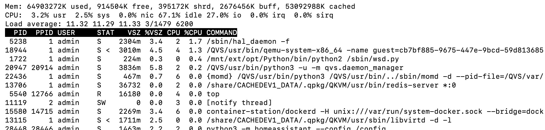

OK. Can you show me a little more here of your TOP output? And what NAS is this?
I’m asking because I see your Load average is running at 13. Unless you have 13 cores in your NAS, you will be bottlenecking and this could cause some of your issues. Something is chewing up a lot of cycles. Doesn’t matter that your CPU usage time is mostly idle. Let’s take an expanded look at your first few processes.
Please also send the output of IOTOP.

Hi,
My NAS is a TS-473A…
Here is the top :
and the iotop :

It looks like process jbd2 is taking a bunch of the IO time:
The jbd2 process in Linux is part of the journaling system used by filesystems like ext4. It helps maintain the integrity of the filesystem by logging changes before they are committed, allowing recovery in case of a crash.
Are you doing some scrubbing or a RAID rebuild or anything?
If not, I would check the health of my disks. That process is taking a lot of IO time doing something…
