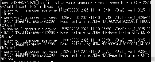

After moving to the shared folder you want to check via ssh, you can use the following command to retrieve files for each user. Please give it a try.
find ./ -user qnapuser -type f -exec ls -la {} + 2>/dev/null | sort -k 5 -r | head -n 5
Please replace the username after -user with the one you want to retrieve.
The part at the end “|head -n 5” displays the top 5 files with the largest size. If you want to list “all” files, please remove this part.
Thank you.
返信、ありがとうございます。
必要なリストが出力されました。
