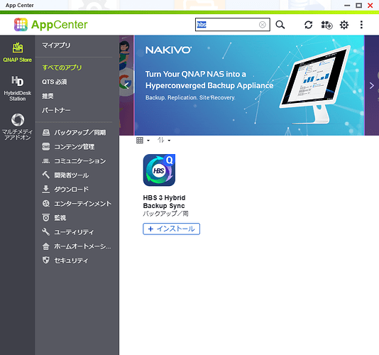

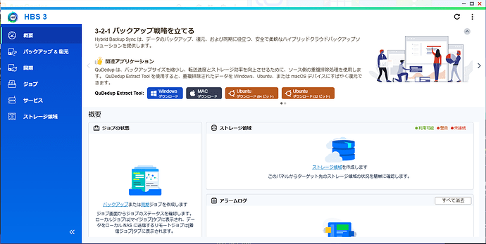

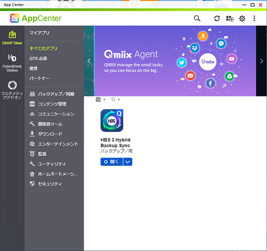

Access the QNAP NAS settings screen and install HBS 3 from the App Center.
If you enter “hbs” or similar in the search box, the application will appear, so install it.
Once the installation is complete, click the “Open” button to open the settings screen.

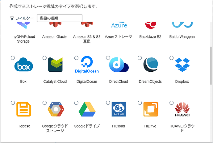

After moving to Storage Space, click “Create.”

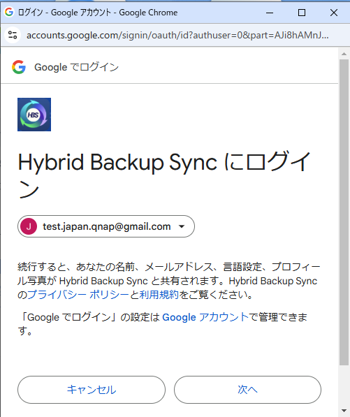

Select “Google Drive,”

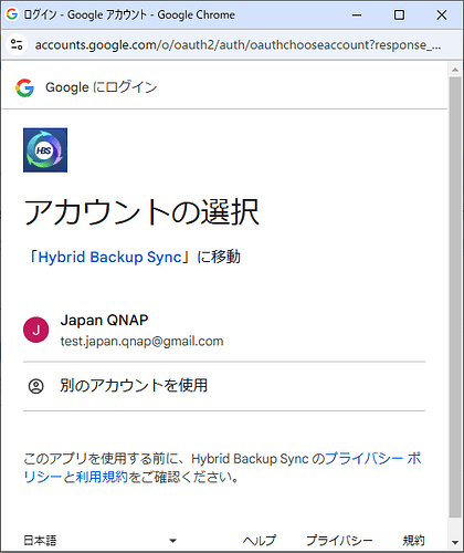

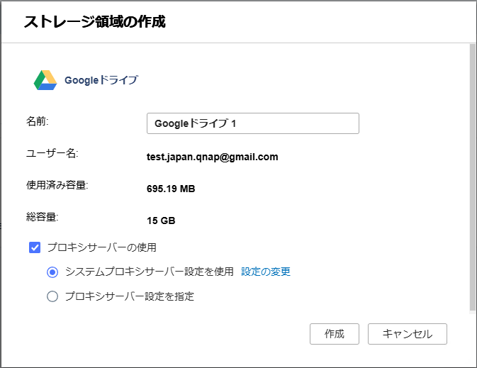

Choose the account,
and add it.

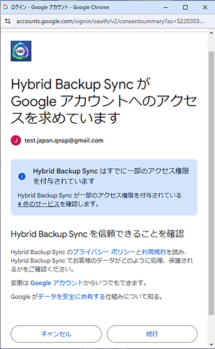

Allow HBS 3 to access Google Drive.

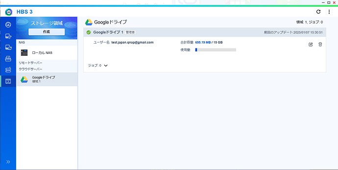

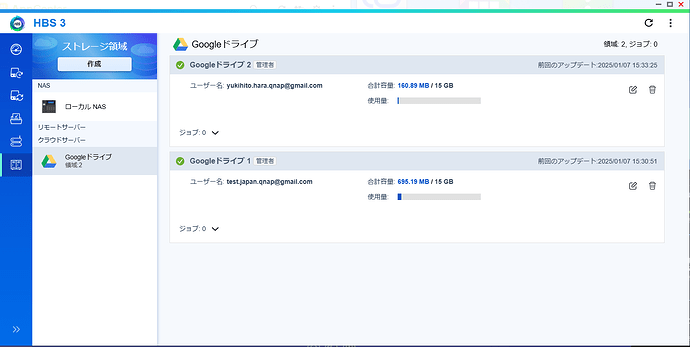

Click “Create” to add the first account.
It will also be displayed in the list of storage spaces.
Add the second account in the same way.
It was added like this. If two accounts work, three or four should also be fine.

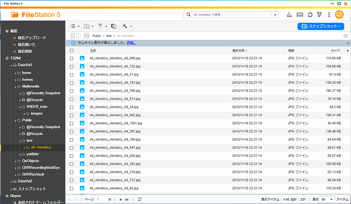

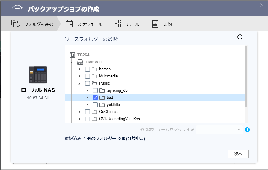

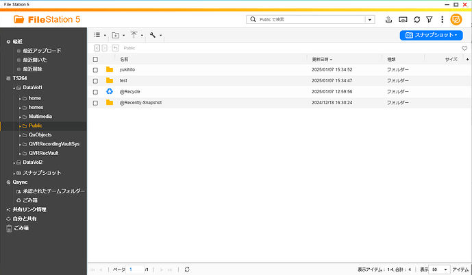

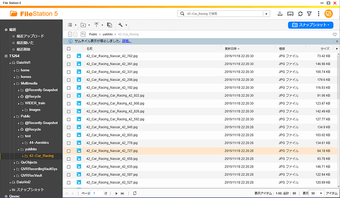

Under the Public folder, create folders named “yukihito” and “test,” and create some dummy data as backup targets.
I created them like this.
Both are around 50MB or less.

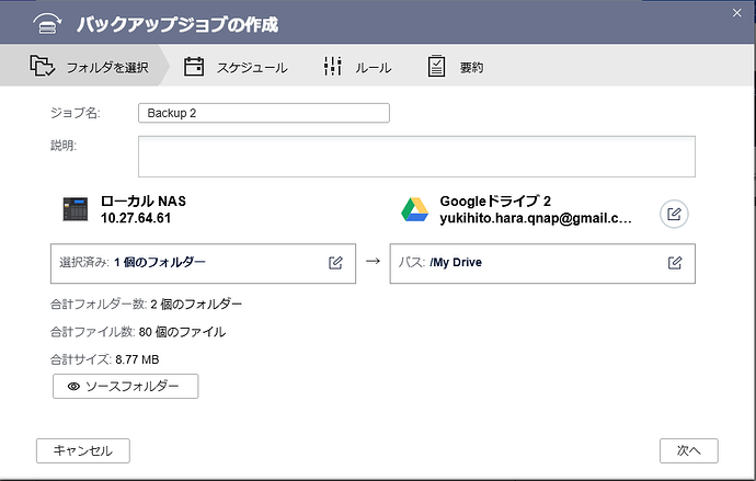

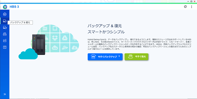

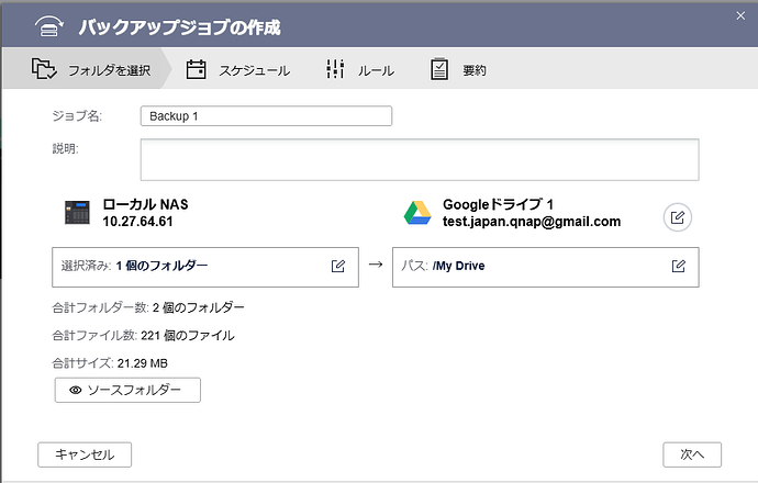

Create a backup task and execute the backup.
Move to “Backup & Restore” in HBS 3 and click “Backup Now.”
Back up the “Public\test” folder
to the test account.
Back up the yukihito folder
to the yukihito account.

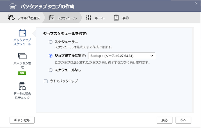

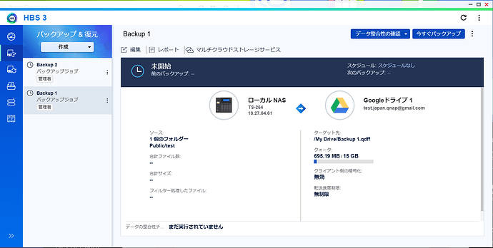

With HBS 3, you can “execute another backup job after the previous backup job is finished,” so after the test backup is done, proceed with the yukihito backup.
The backup jobs have been created, so click “Backup Now” for the test one to run it manually.

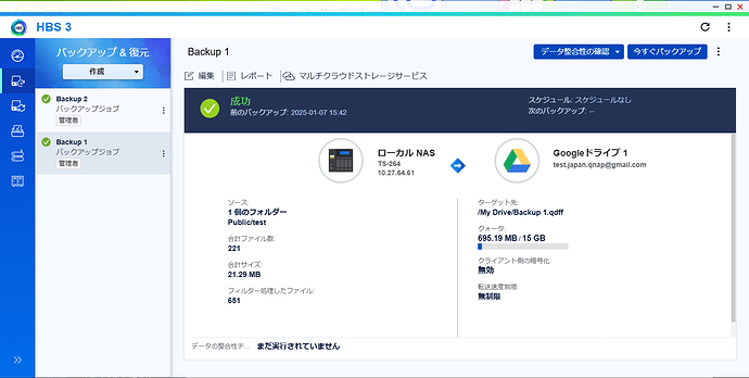

After a while, both backups completed successfully.
From the above, it is clear that it is possible to back up from a QNAP NAS to separate accounts on cloud storage.
