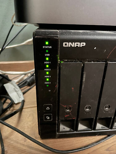

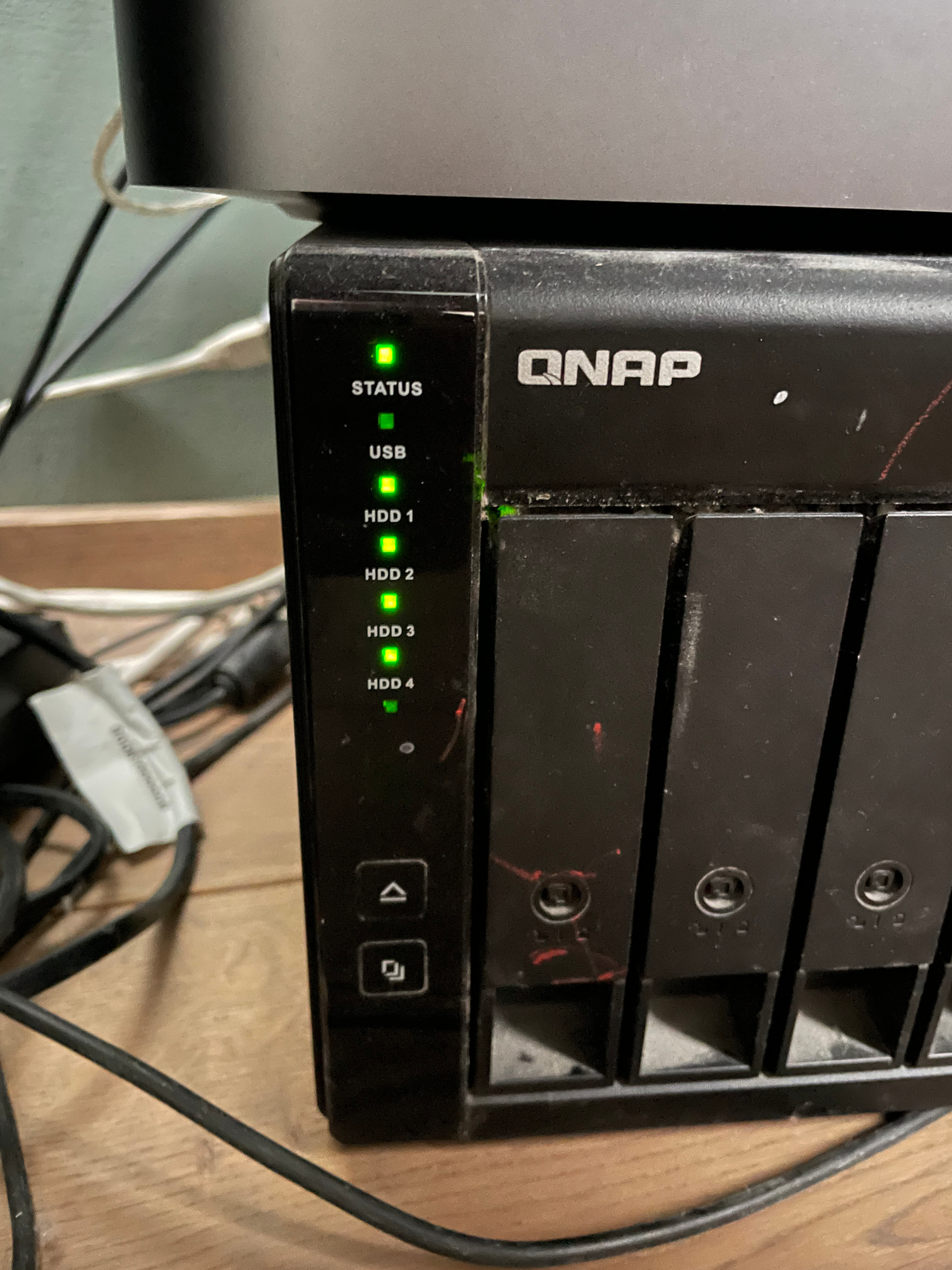

I have a TR-004 connecte to a mac mini. I have 2 RAID 1 volumes, each based on a pair of identical drives. Recently, I experienced a power outage and after that one of the RAID volumes is not mounting. In the QNAP external RAID manager everything seems fine - volumes in “normal” state, all drives are “good”, also the LEDs on the enclosure are green and the log is not showing anything extraordinary. But one volume simply won’t mount. Any ideas how to investigate this more? This is hardware RAID mode, so the TR-004 looks like an ordinary USB drive and I am not sure how to get more info.

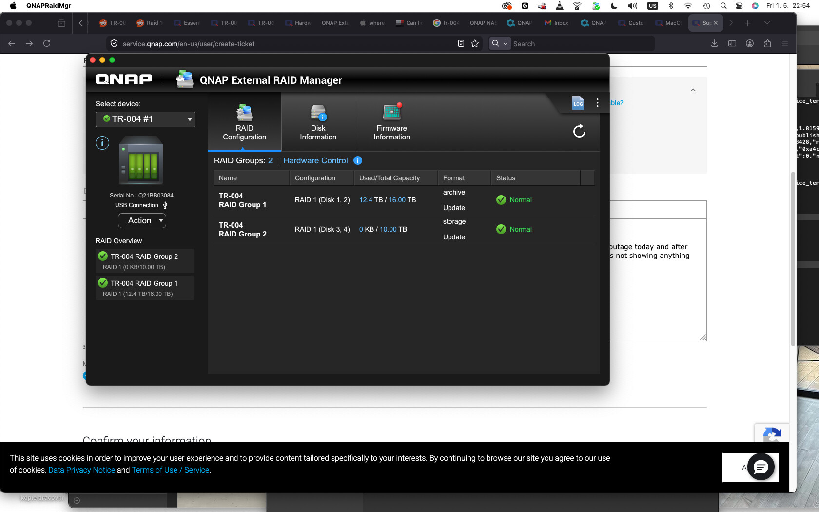

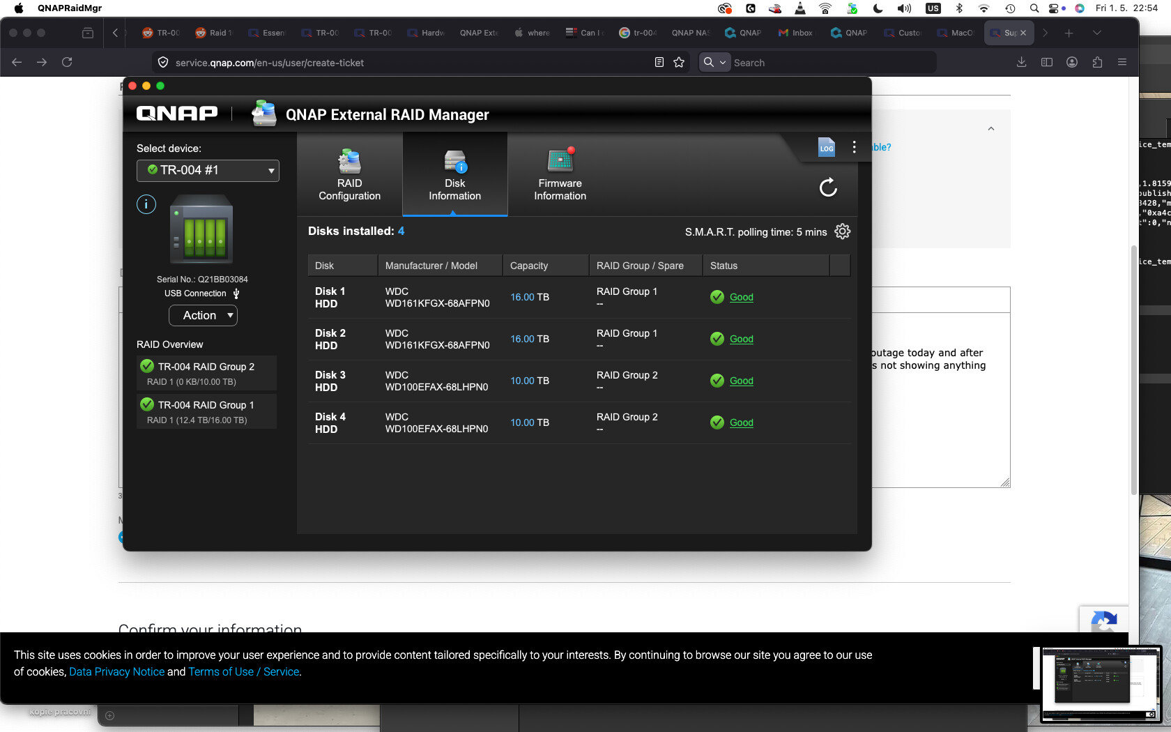

Could you please provide a screenshot of your RAID configuration, as well as a photo of the physical RAID button on your TR-004? Thanks!
Sure here are the screenshots

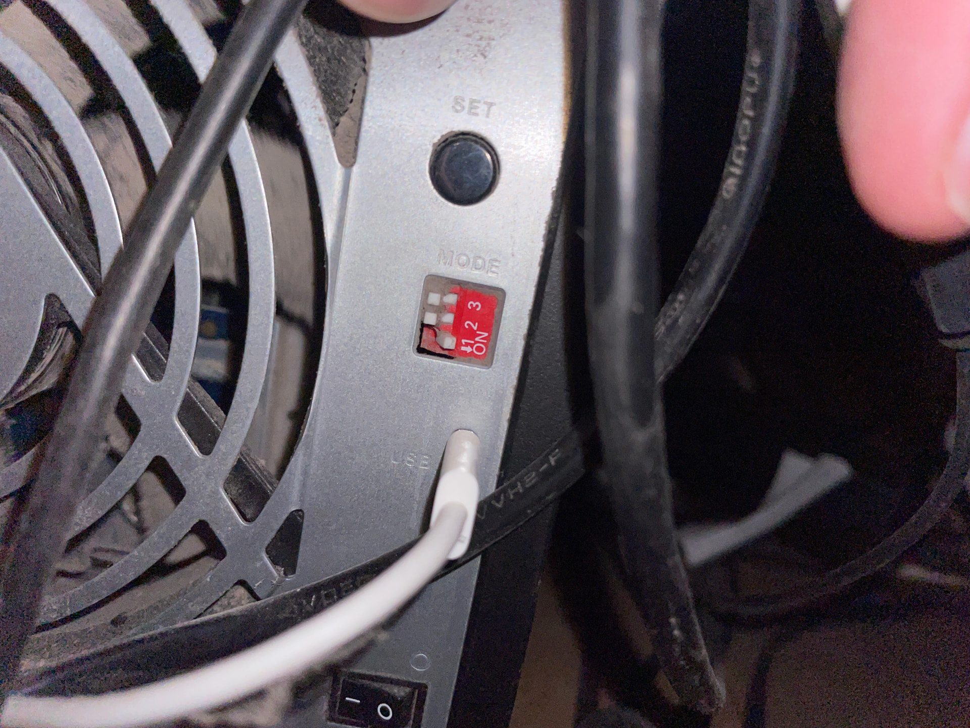

@dotcom, can you please post a photo of the DIP switches on the rear of the box?
With that much crayon on the front, grubby little fingers might have had their way with it.

Indeed, little fingers were my first suspect but I can’t see how they could cause such damage. The drives were well seated and I have also tried to re-seat them.

I attach a photo of the switch, I think it is in correct position for RAID 1, right?

Multiple RAID on TR is always a bit weird..I thought it has to be in software control mode for that. (otherwise RAID1 with 4 drives would do a RAID10)
