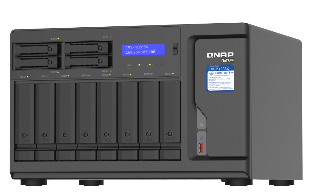

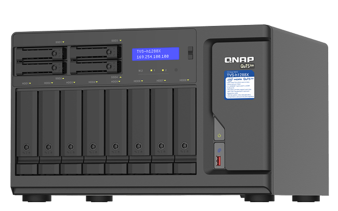

My TVS-h1288X certainly can (‘beefy’ Xeon W processor)
