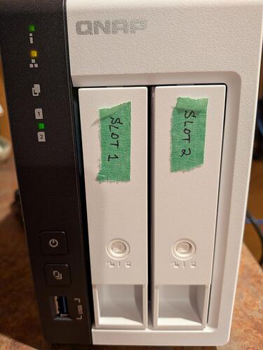

Hello QNAP Community,
I am looking for some guidance as a new user of a TS-216G 2-bay NAS that I would like to learn more about regarding definition of the front LED indicators (see notes below for associated QNAP NAS hardware info). Since I have (2) drives installed (in RAID 1 config), shouldn’t both drive LEDs be reporting activity if both drives are healthy & functioning normally per the QTS web portal? Currently I only see activity from the #2 drive LED so just curious if I am misinterpreting something. Apologies in advance for any missing details or if this question has come up in the past, but please let me know what other information is needed & I certainly appreciate any assistance, thank you!

Yes, you should be seeing 2 LEDs on the front panel, one for each drive. It seems Disk 1 isn’t illuminated.

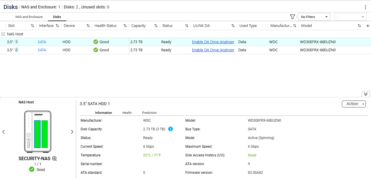

To test the LED: login to the QTS UI → Storage And Snapshots → Storage → Disks → select disk 1 → Action dropdown menu → select Locate. This should blink the red LED for disk 1 continuously. Does this work?
Appreciate the suggestion on how to test the disk LEDs, thank you. The LED for disk #2 seems to test fine but nothing happens for disk #1, while testing or normal disk activity otherwise. Very seldom do LEDs fail, especially on new out-of-the-box components, but that seems to be the case here unless there are any other suggestions. Kind of a nuisance but not a complete deal-breaker I suppose. :expressionless_face:
