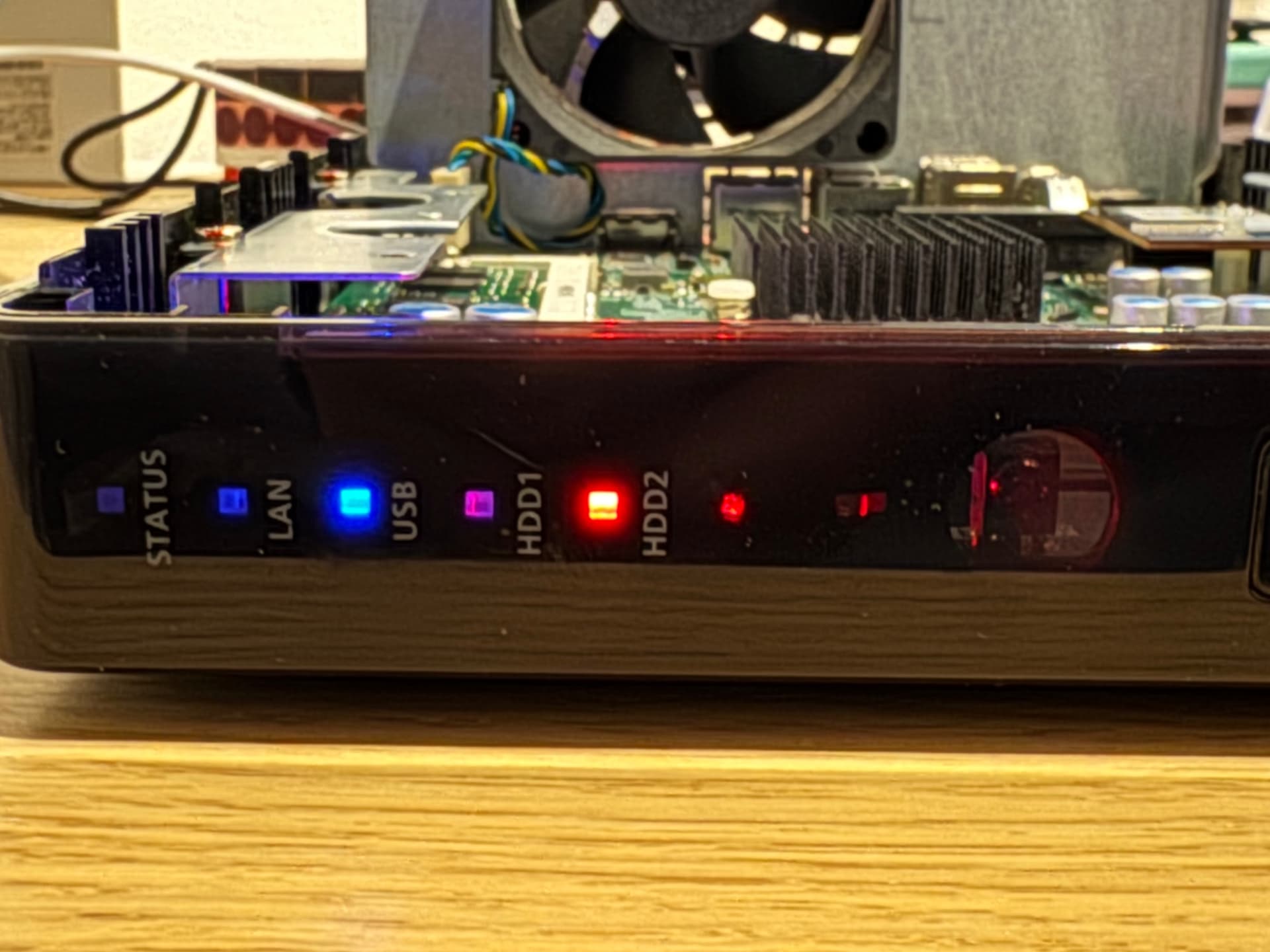

TS-251+ no longer boot after an accident, showing TWO solid red lights
A few days ago there was an earthquake where I live, and somehow a screwdriver fell onto my NAS that’s sitting on the ground. The NAS stopped working (as in, not able to navigate to the web interface), so I decided to power cycle it.
However, when I tried to boot it up, there’s no longer a beep, and it’s now a brick…
I tried doing some research, and at first I thought it’s the LPC clock, but it seems like everyone who run into LPC clock issue have all four red lights turned on. So, I’m not sure this is the same issue.

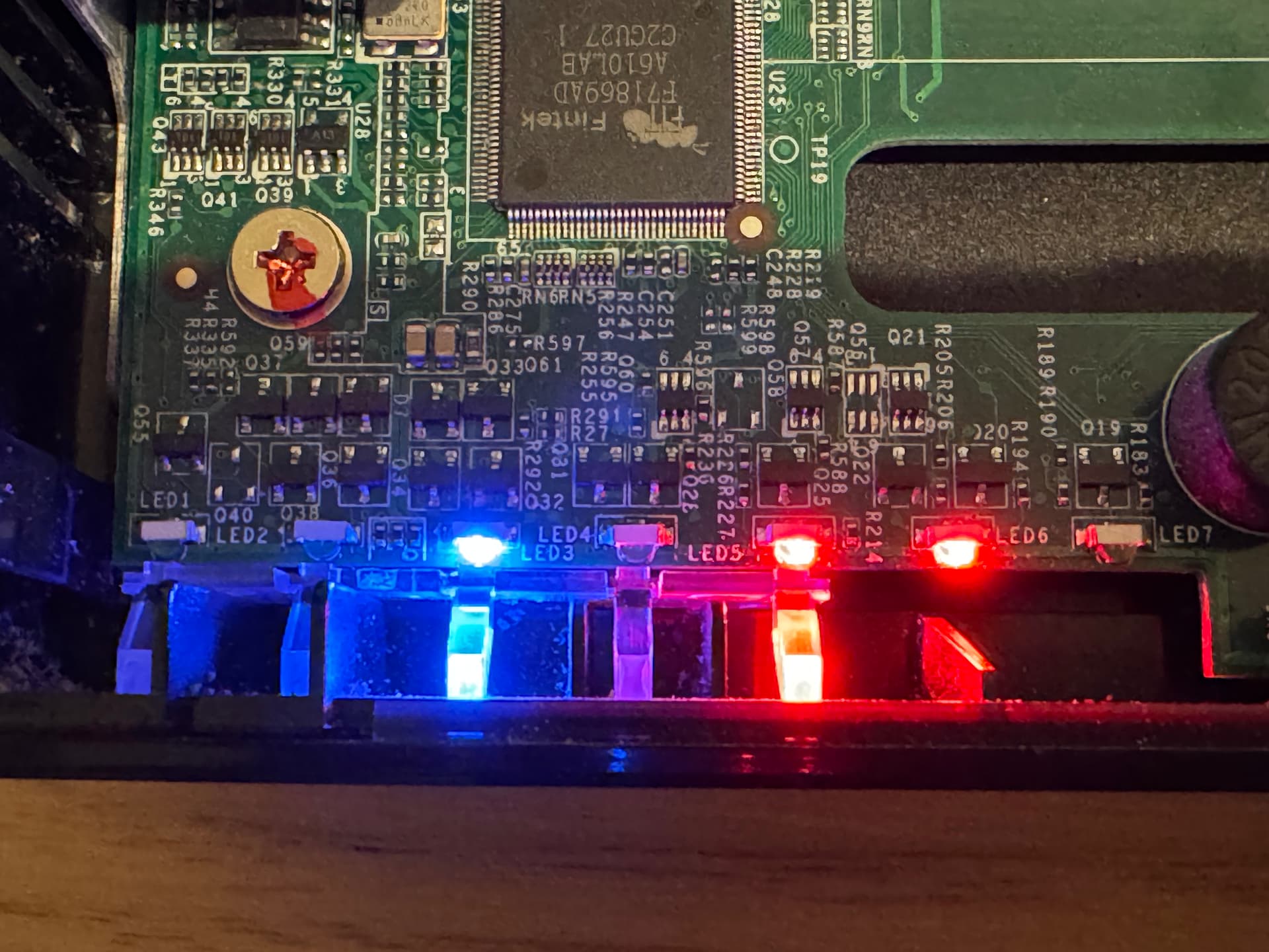

Here’s it from another angle:
You can see that it’s only LED5 and LED6 that lit up red, unlike other reports of LPC clock issue.
I’ve opened a support ticket with QNAP, but I felt like I should also ask it here in case anyone knows what these lights mean.
