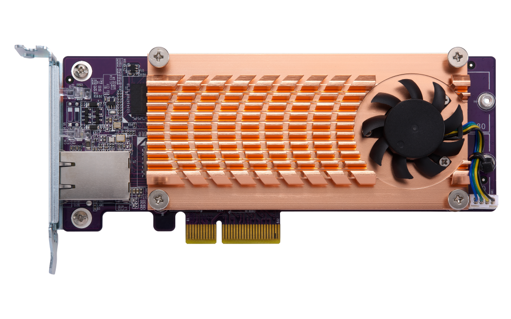

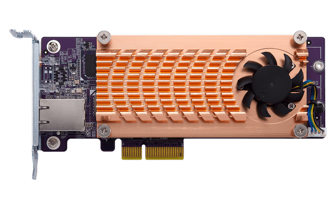

If you can find it, get this card (2x m.2 SATA and 10GbE)

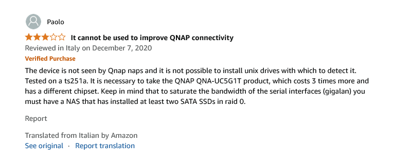

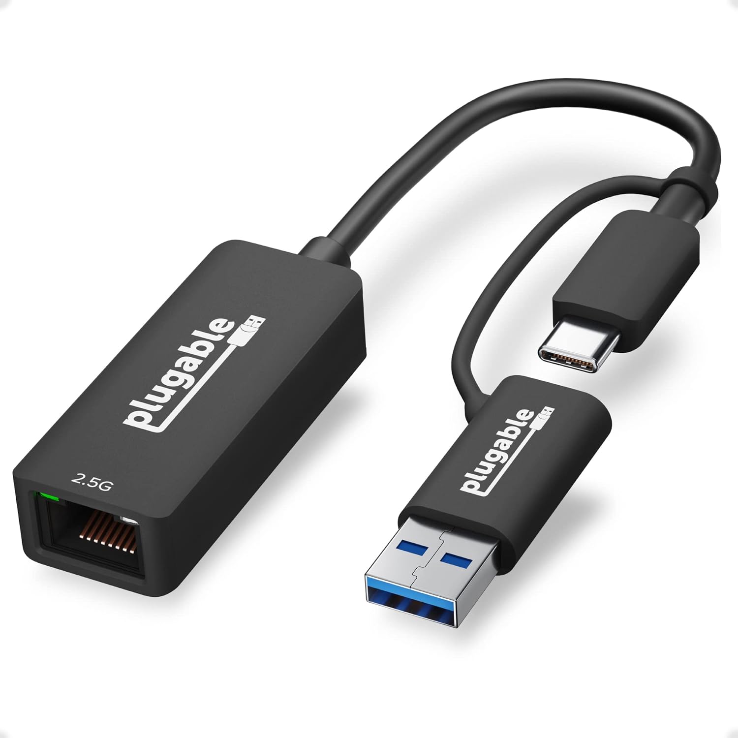

I found a few reviews on amazon saying that this usb 2.5Gbe card works out of the box, will update if it goes well.
I see reviews for this products that this does not work with QNAP NAS (on the QNAP side, not a client side) , QNAP units are notorious for VERY limited 3rd party compatibility, so if you do not see a products in the compatibility list, chances are high, that it will not work (or will stop working after a firmware update)
Unless usb drivers are in the firmware it is near impossible to know if this adaptor would work at all.

I am happy to report that the Plugable 2.5G usb mentioned above did actually work as a charm as soon as I plugged it in!
It took a bit of fiddling in Network & Virtual switch to maintain the same IP address on the network (swapping IPs between the 2 network interfaces) and granting docker containers access to the interface, but it wasn’t as complicated as I thought it would be given what I read about the previously used workaround and jumping through hoops that people used to go through to get similar products with Realtek RTL81xxx chips to work.
