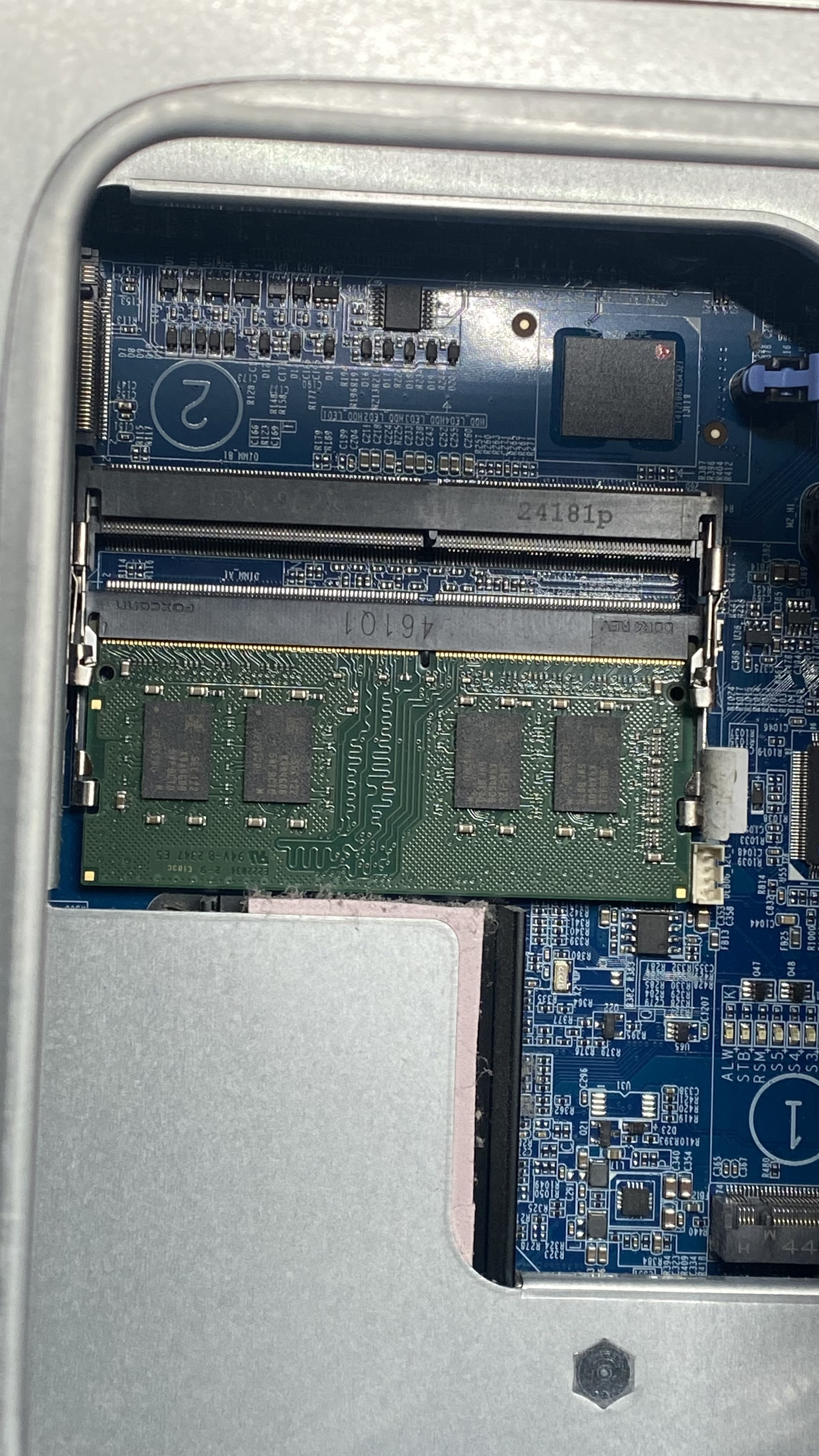

I read where certain newer models of the TS-262 one could add more memory. I have 4 gig and would like to upgrade to 8 or 16 if possible?
How can I determine if my NAS can be updated with new memory. If It can, any recommendations on specific parameters? I read that DDR4-2666 up to 3200 SODIMMS were the spec?
Open up your NAS and see if your RAM is soldered or socketed.
There should be a few discussions about what RAM models would be compatible(google), to be on the safe side, you can always buy the RAM at a place with a good return policy (and make sure to keep the old RAM)
@dolbyman, thanks for quick reply. Yeah, I opened covering and I don’t see any soldering. I see i think some clips on side i’ll figure out how to pop open. Here is a picture. I did google and that is where i found the recommended memory being DDR4 either 2666 or 3200 mhz…
I meant specific memory modules (that can be very tricky)

i think you can use both
For my TS-264 i use this
