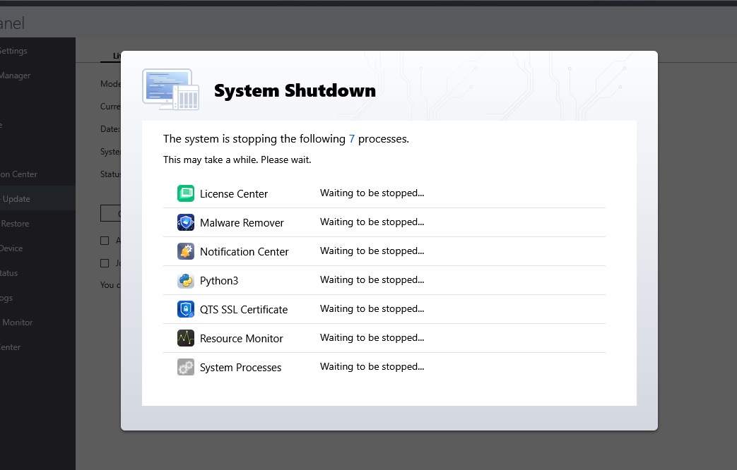

Hello, I noticed when I send poweroff via ssh the nas doesn’t shut down. In the GUI I can see “ The system is stopping following processes” and freezes. Only way to proper shutdown is the power button or kill -9 -1.

Scheduled Shutdown is OK. SSH shutdown used to work but I suspect firmware/apps issue, so NAS will be factory-reseted to cleanup configuration residue . What I found is WebGUI shutdown uses cgi script to close some processes/services first , which are hard to kill via ssh as they are respawned almost instantly. Sadly no API reference couild be found … so will rely on community support.
