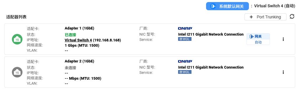

Hi @18015009618,
Thank you for providing the network adapter information. The network interface on the NAS side has been confirmed to be normal (1Gbps, MTU 1500).
