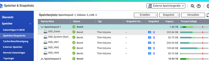

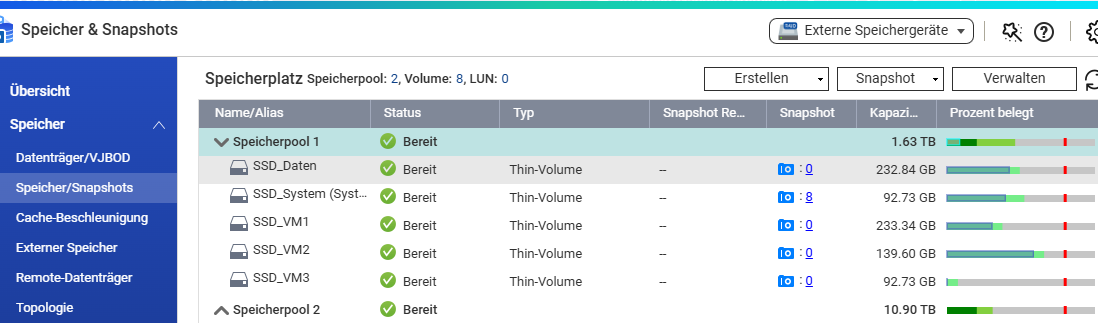

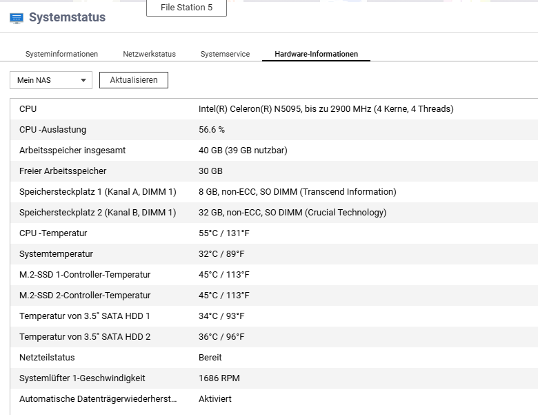

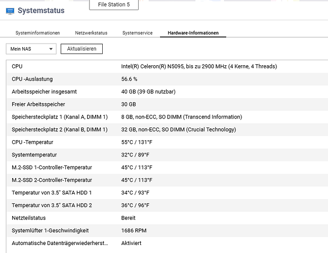

I have a TS-264.
You should start
  1. Install the ram, they first start with the new RAM can be a little be longer (5-15 min)
  2. Install the 2 SSD
  3. Start the NAS
QTS User Manuals
4. I use pool + thin-volumes
  1. Install the HDD
