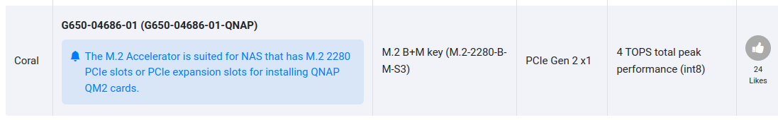

Thank you for your comment. According to the compatibility list, there is QNAPs QM2 card listed:
What confuses me, is that the https://www.qnap.com/en/product/qm2-2p QM2 is advertised as to “add support for M.2 NVMe SSDs to a QNAP NAS”. Coral Dual Edge is not mentioned.
Is there any experience using a QM2 card with 2x Dual Edge TPUs?
The Coral device you show above may need to be used on the internal M.2 slots. I’m not sure. You may want to contact QNAP about it.
