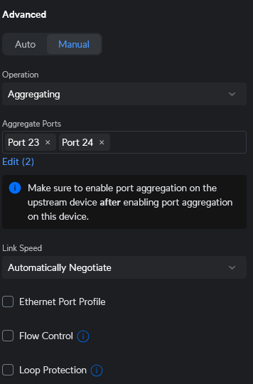

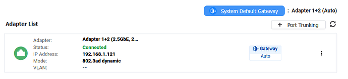

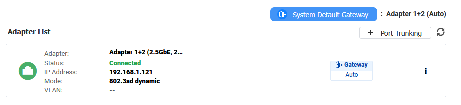

I set up port trunking on the NAS (802.3ad in layer 2+3 (MAX+IP) mode), and link aggregation on unifi, and unifi sees the NAS, I can get into the GUI by its IP address from my browser with no issue, but the samba share on windows seems to have disappeared. Any ideas here? Screenshots below.
and on unifi:
Actually, restarting the NAS fixed this - sorry, but leaving this thread in case it happens to others with such an easy fix =).
