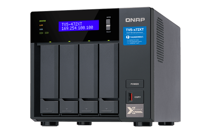

The x64 devices do not support ECC, the smallest 4bay one would be the TVS-472XT (forgot about those above)

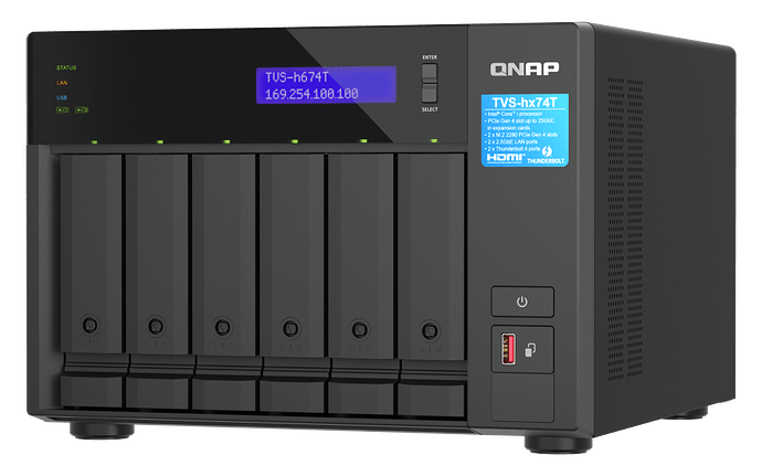

after than you have the TVS-h674T
Be wary of tvs-?72 serirs. Early versions had bad Intel chip on motherboard that is likely to fail. You can check serial number with QNAP to see if that particular unit is vulnerable. We had a TVS-672N fail 3 months out of warranty. $899 for QNAP to replace MB.
New devices ‘should’ have a higher production code than Q21 (allegedly fixed)

TS-h688 if you can find a used one (dicsontinued faster cpu model Xeon 1622) We had the slower version and sold it and bought the faster one for $900on ebay from someone that bought it and never usd it. The slower one might work for you if you don’t need a lot of cpu.
Both models I mention have two NVMe slots
He said 2.5 SSD. A lot of us don’t use M.2 because they are not hot swappable. Some at remote locations. You might be able to get an employee to swap an SSD over the phone but not to take the entire NAS apart.
