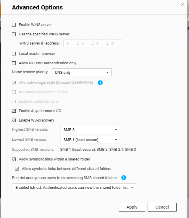

On the “offending” TS-879, the lowest SMB is v1 and the highest SMB is v3.

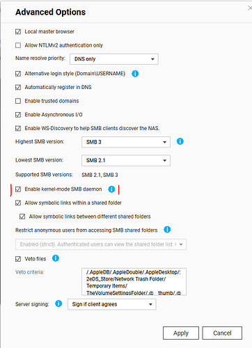

SMB on the TS-1685 is SMB3 to SMB2.

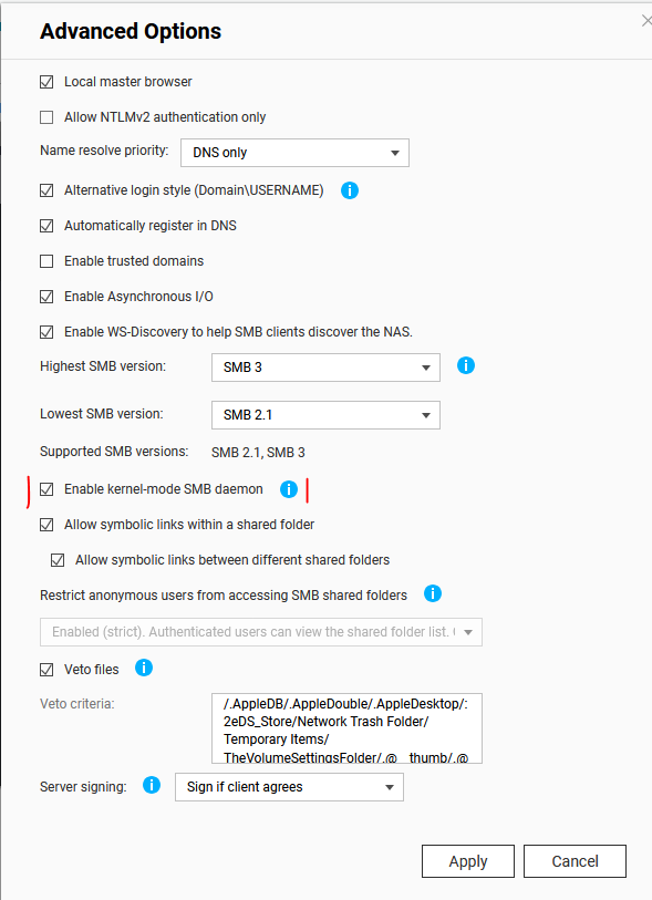

Not sure what is available on this older firmware, but see if you can enable kernel mode SMB (disables encryption) or lower the highest SMB level
