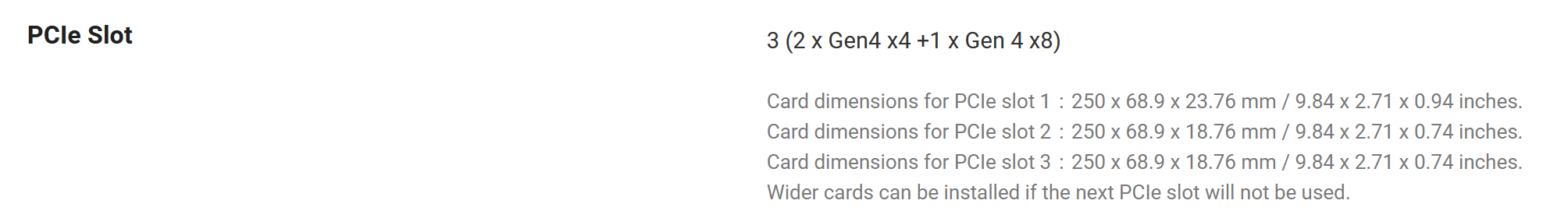

The list of compatible GPUs for the TS-h1887XU-RP is on the thin side, with a few variations on the GeForce 1030, or the NVIDIA P1000 4G (which I have) or the NVIDIA 620 2G. I’m running QuTS Hero 5.2.7.3297 right now.
Is anyone running anything different in theirs? I’m considering trying the Intel Arc 380 to see if it does more transcodes than the P1000 - reports say it can. Has anyone tried this hardware in theirs?

i think the intel arc card need some specific requirements to work (resizable bar) and im sure drivers are not available in qnap OS. I would see if you can fit a nvidia card in your unit. you can try to find a card that fits the size and see if it works. I know the nvidia drivers in quts hero OS support some rtx 30/40 series cards.
I already have the NVIDIA P1000 in the device. In checking other sites, I’ve seen that the Resizable BAR isn’t required for the ARC series to work. I guess I’ll look at other devices or possibly something else in the NVIDIA line.
