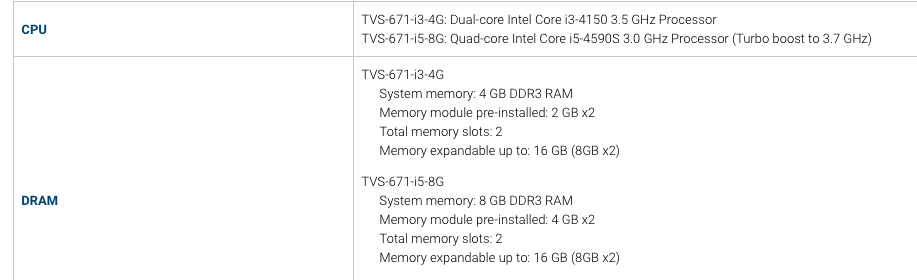

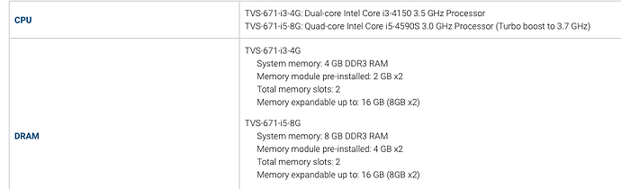

According to the QNAP specs, this model can accept a maximum of 16GB.
https://www.qnap.com/en-us/product/tvs-671/specs/hardware
Now, you may be able to add more but that may or may not work. For example, one of my models TVS-672XT is spec’d a 32 GB but I have heard people using up to 64 GB.
You model uses DDR3 RAM. Unfortunately, I don’t know the clock speed. You would need to look on the RAM that is in your unit and figure it out from the manufacturer part number listed on the memory module. It may be hard to find these days and very expensive.
Quickly looking on Amazon, it seems like 8GB modules are very common. 16GB modules not so much. A 32GB (2x16) is $300 but I’m not going to post the link as I don’t know if that is compatible with your NAS. It’s a PC3-12800, but there’s also a lot of PC3-10600 memory out there. So you would have to figure out the correct type of DDR3.
