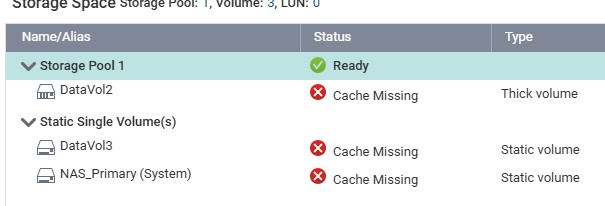

Woke up the other day with 500 warning messages that the cache drive was missing. “Failed to access the installed drive. Check SSD M.2 2”
In Storage> Drives - it showed as if the second M.2 drive was just missing. Guess it died after only three years. Since that point, none of the other drives/apps have been accessible and showing “Cache missing”. I ordered an identical replacement (WD Blue M.2 1TB). The other M.2 drive was showing as fine still. Got the drive today and swapped out the bad drive.

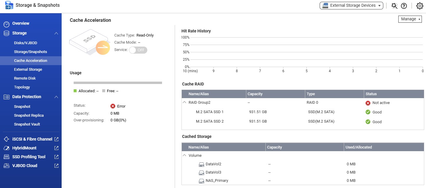

After booting up, it now shows two good M.2 drives, but I cannot find a way to “rebuild” the raid. After booting up I am still getting the following errors.
“SSD Cache RAID group ‘2’ is inactive”
“Failed to recover RAID group ‘2’. Storage Pool 256”

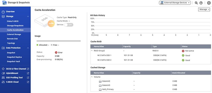

On the Cache Acceleration tab, the service is “Off” and greyed out. Under MANAGE menu is Remove and Settings, the other two are greyed out.
Any suggestions as to how to either recover the raid or is it safe/possible to remove the “Raid 2” and start over? If I do the latter, will it impact the access to the drive volumes in any way? At this point if I do have to rebuild, I will probably do a raid 1 configuration just in case the other drive fails in the near future.
Thanks for any assistance.
Your cache shows up as RAID0…there is no recovery from that

wait… are you saying that due to the cache failure, my three volumes (8 drives, ~70TB) are “LOST”???
Maybe not all but some is likely lost. Any data in the cache that hasn’t been flushed to the main drives is now gone.

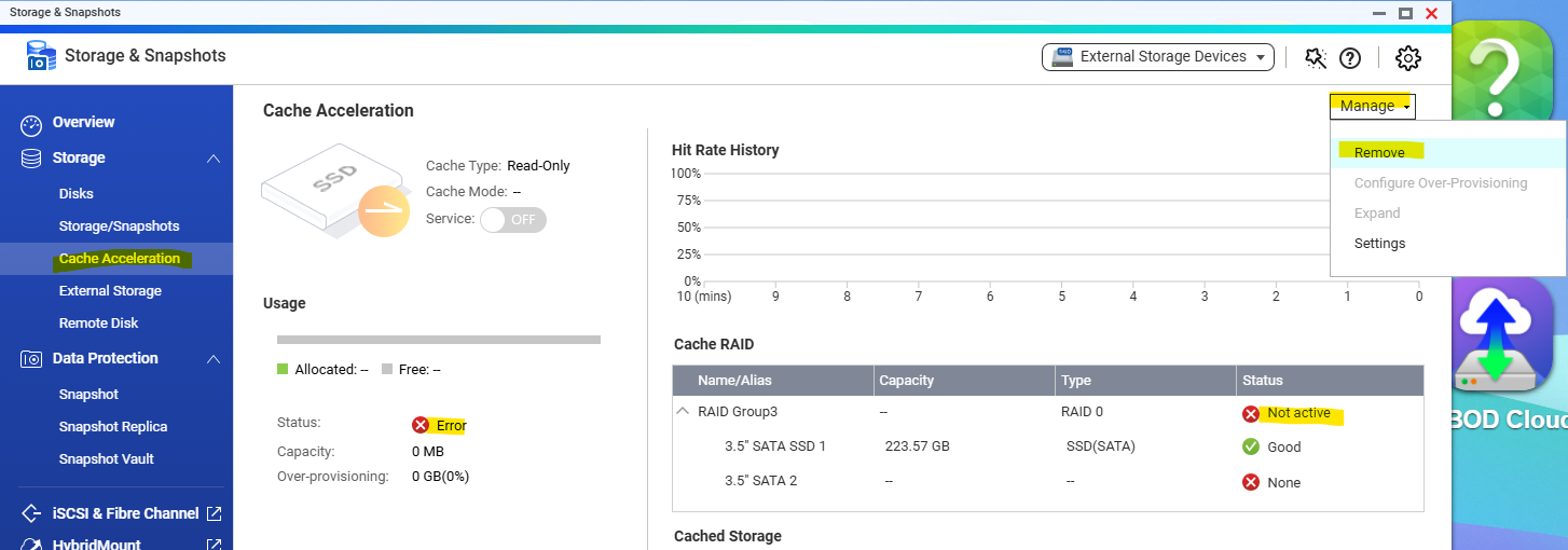

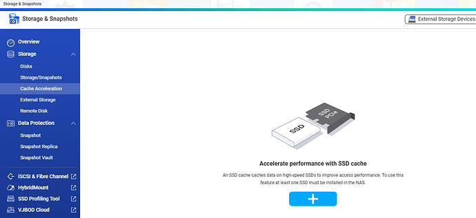

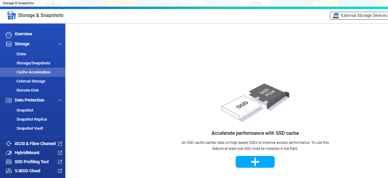

Additional information for everyone, here’s how you can remove your SSD cache directly through the UI:
  1. Storage & Snapshots > Cache Acceleration > Manage > remove
    Removed successfully

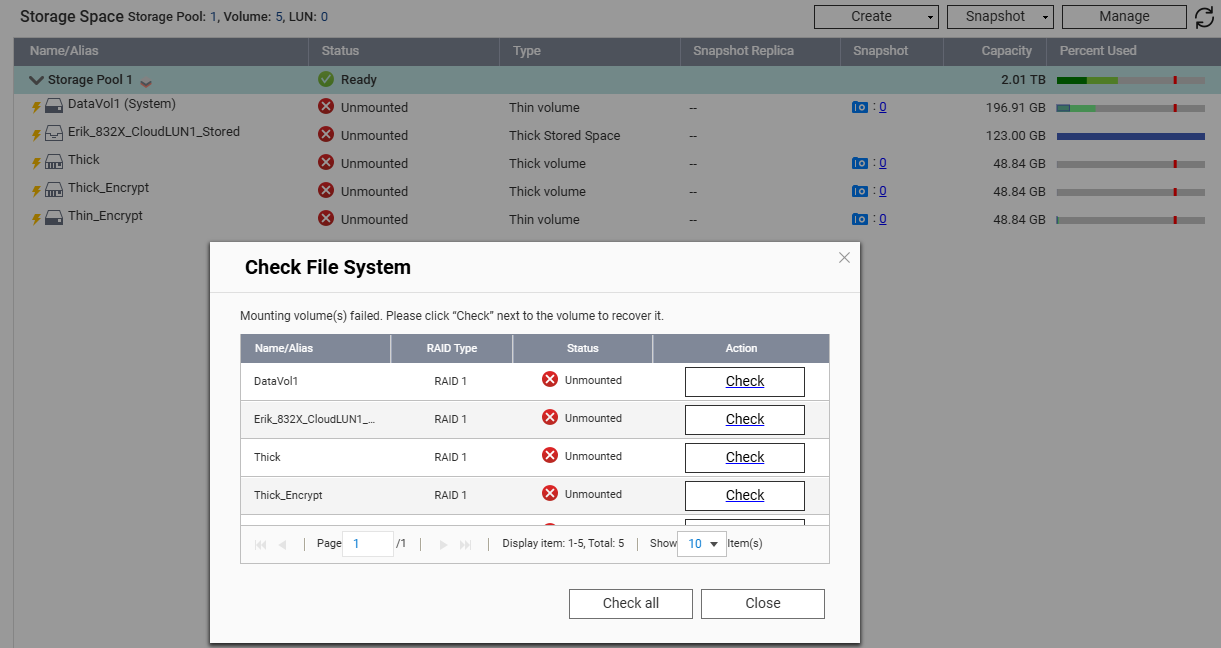

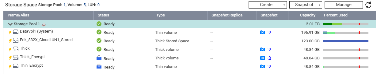

  2. After removing SSD cache , re-launch "Storage & Snaposhots > Storage/snapshots , it will auto popup “Check File System” dialogue

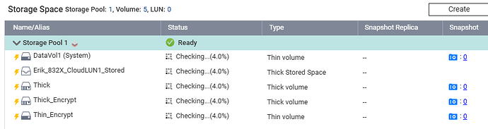

  3. To do “Check File system” (Click "Check all)

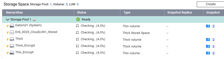

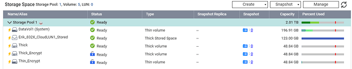

  4. All Storage back to Normal state

I forgot the detail, but from the screenshot by Steve, it seems the SSD can still be removed when it is already in Error status.
