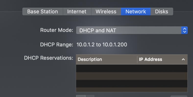

You don’t need the old router, just set the same DHCP range as the old had, just make sure the fixed IP the NAS has is not in scope (so start higher or end lower
Not sure the new router will allow that. They gave me one of the eero Pro 6E routers and the only configuration that can be done is over a phone app. which is very limited unlike what I previously had.
never heard of this device … but a quick google spat out
Thanks for the link and I went to it and followed it but it did not like the range of IP addresses I put in. I really don’t like these routers. Do you know that if I do the 3 second reset that it will release my static IP address and not blow away all my user accounts?
Check the link I posted, it tells you what settings are changed by the 3 second reset.
