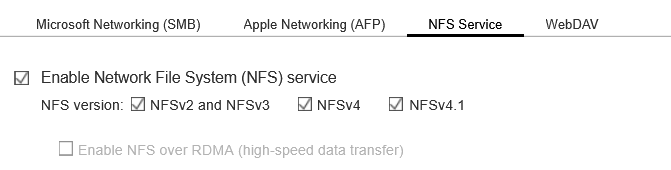

Do you have NFS enabled on the NAS? You need to do that and then you need to modify the permissions for each shared folder to allow NFS connections…
Could you please check if you have enabled NFS on the NAS?
Additionally, we recommend trying the showmount -e <NAS_IP> command to verify the actual exported path names from the NAS. Thank you!
NFS Is enabled:

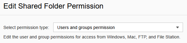

Yes, this is what I have that folder set to:
Firmware shows QTS.

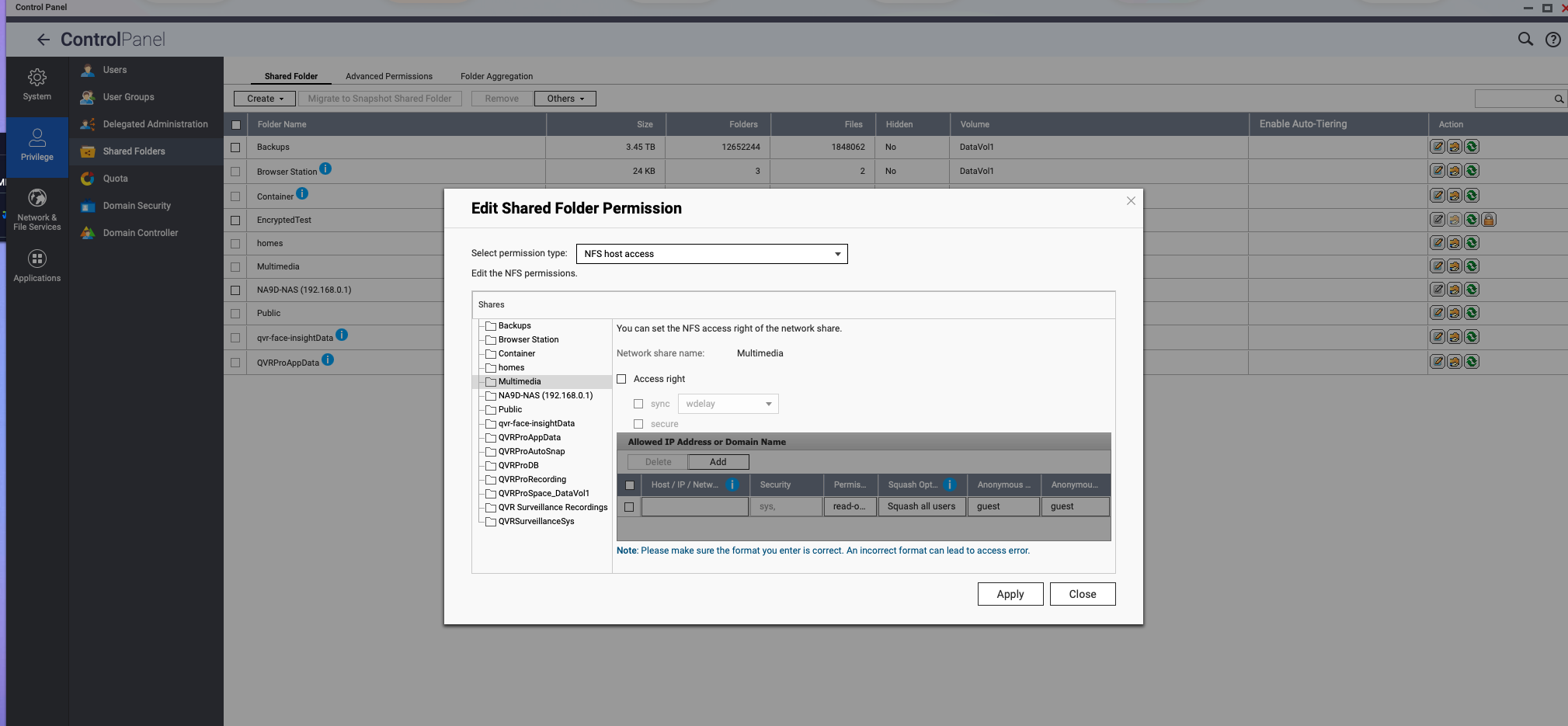

That is not NFS permissions. You have to go into the shared folder section of the Control panel and then explicitly set NFS permissions:
So in the image above Multimedia (which is a “shared” folder for SMB), is not shared over NFS.

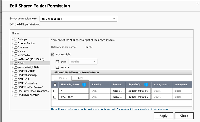

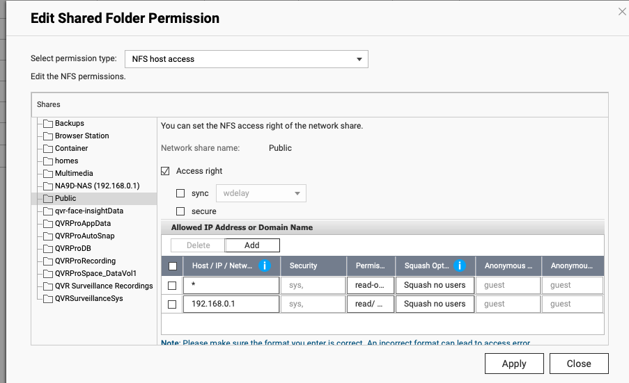

Below shows the share settings for the Public folder:
In this case, for public, any device can READ the public folder. Only 192.168.0.1 can have read/write accesss though.
Just because a folder is “shared” does not mean it is available over NFS.
