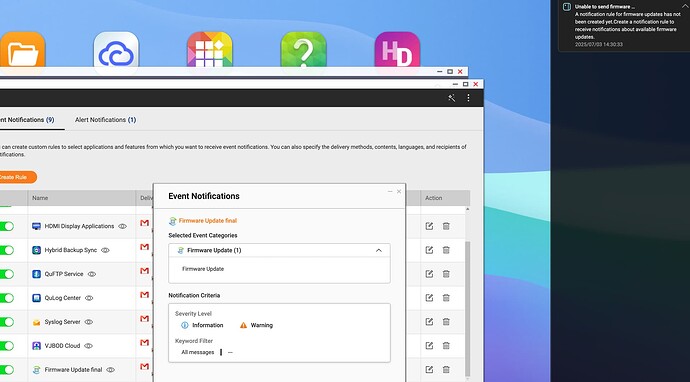

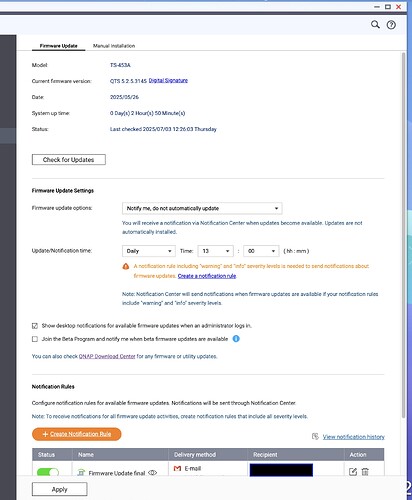

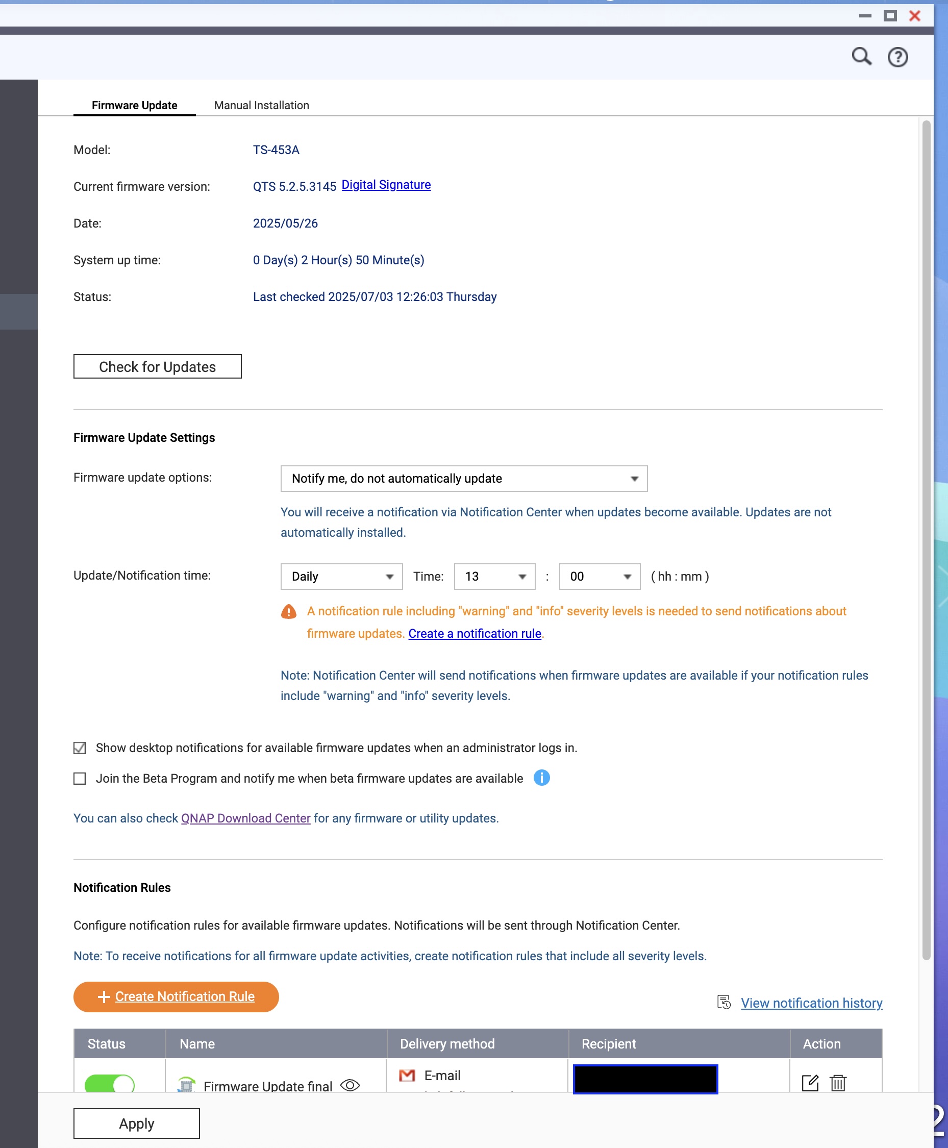

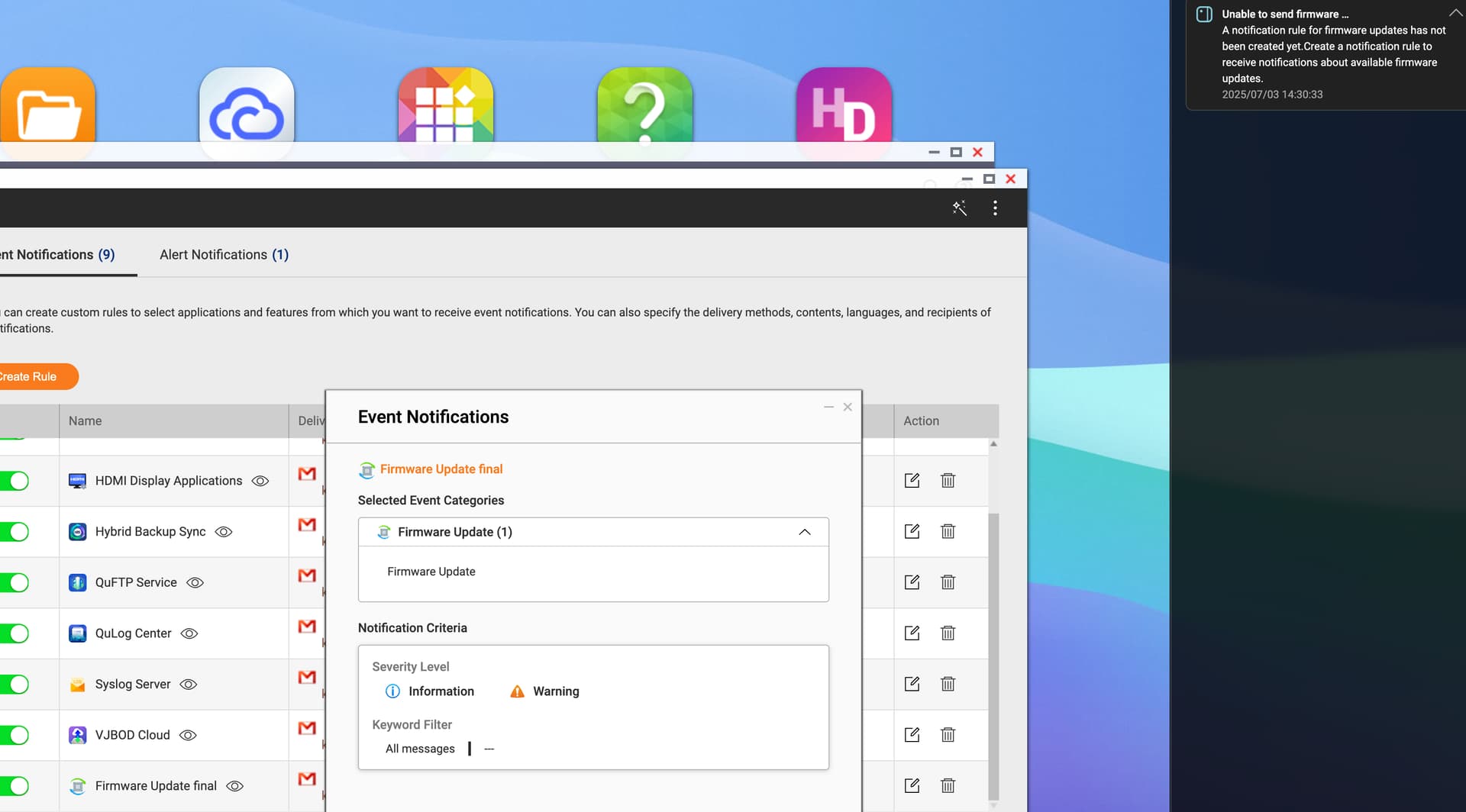

In my TS-453A, I have a continual Notice Board about firmware update notifications being disabled. No way to manually clear this Notice Board, and clicking on it brings me to the Firmware Update configuration page and starts creating a new rule for notifications.
But the notification rule certainly exists (I have re-created it several times, to be sure)
Only changing the Firmware update option to “do not notify me, do not automatically update” clears the notice board. Even setting it to Automatically install will keep the notice board there.

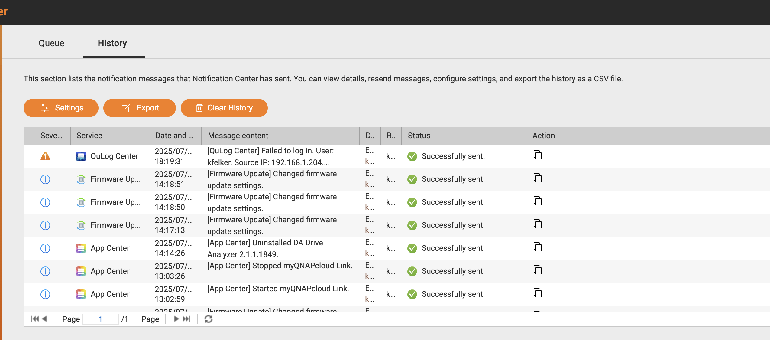

But I do have an active Email notification method and firmware rule setup in the Notification Center? I get email notifications when I change the name of the rule, etc. so it is working
Oh shoot. That’s what I get for not looking more closely at your pictures. That is weird. OK then. I would open a ticket on that…
