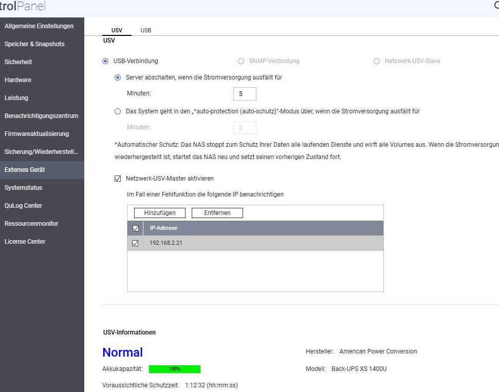

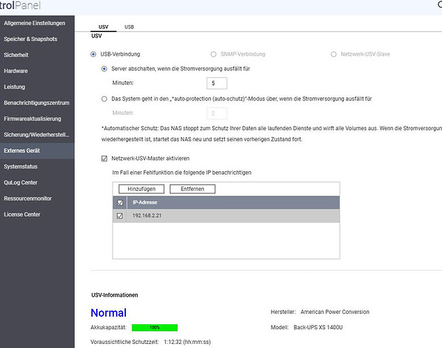

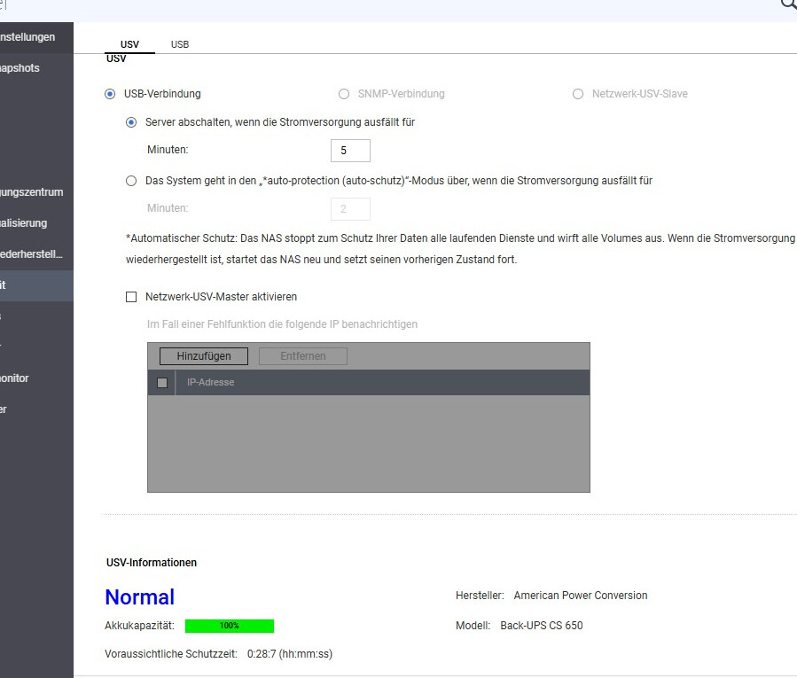

I use 3 APC. There are no problems. :+1:
