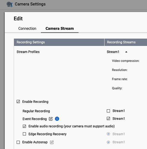

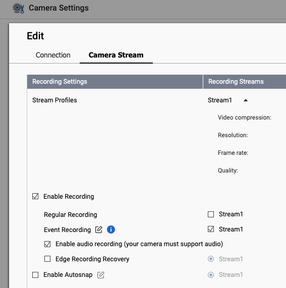

Hi @Lamers-IT sorry that the Surveillance Station has been End of Life and no longer provide updates, we don’t even have the Qmon app you mentioned.
It should be possible to set it to only record video when motion detection is triggered like QVR Pro.
If you can provide more information such as NAS model, firmware model, Surveillance Station version, etc., or a screenshot of your settings, we should be able to provide further suggestions.

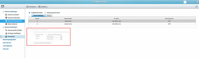

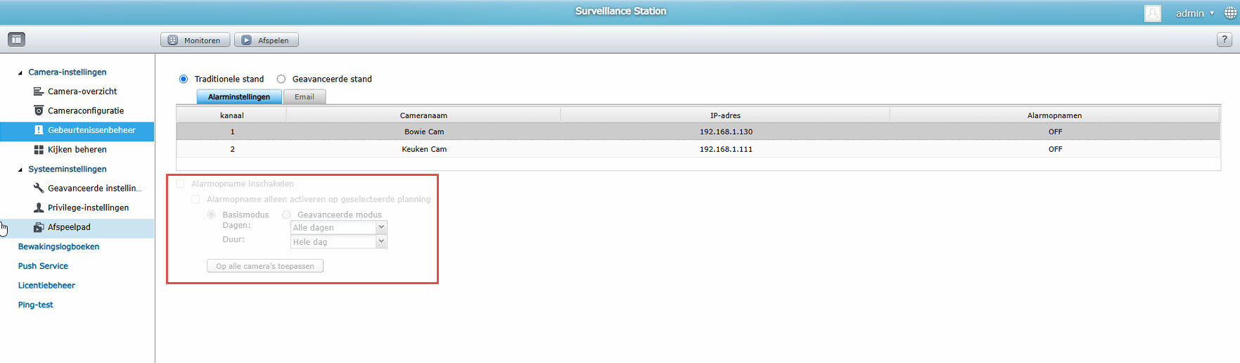

The setting from your print screen is not what I I see
Here is my setting (as you can see Alarmopname (Sorry it is Dutch) is greyed out
