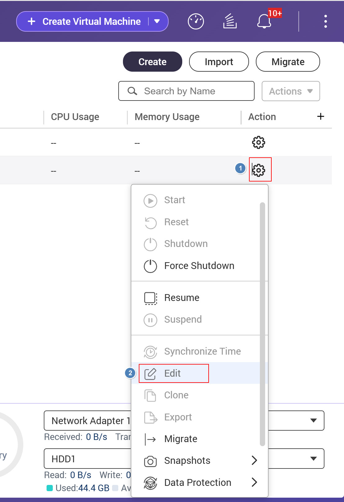

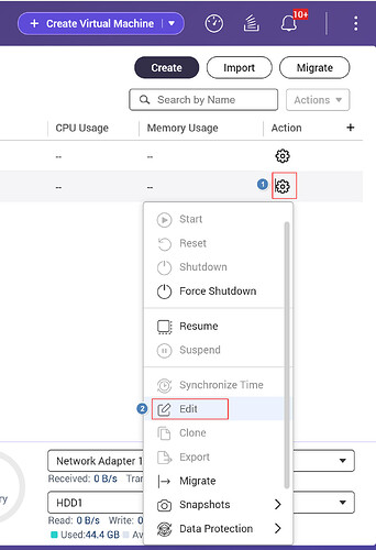

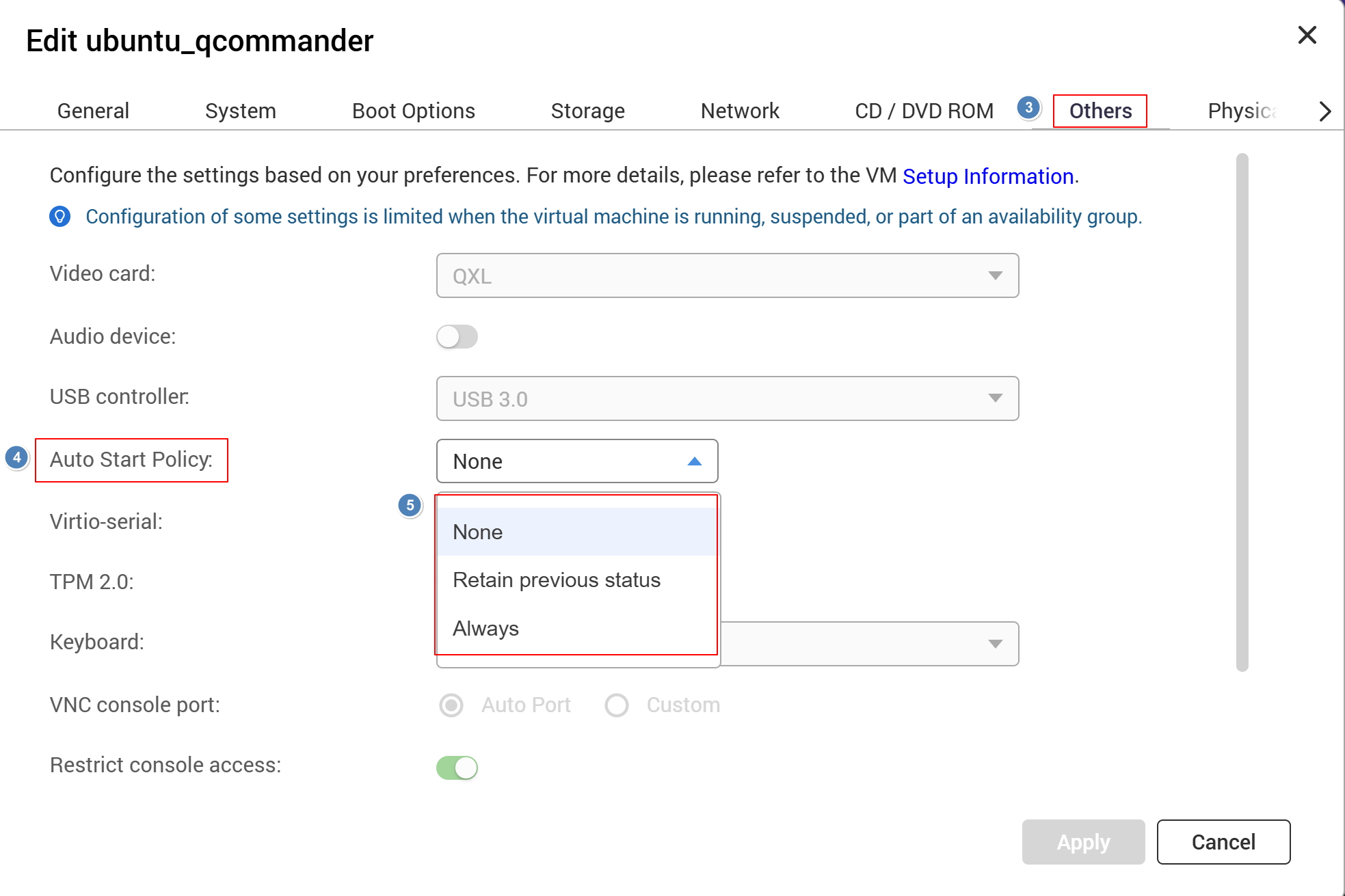

Regarding the auto-start policy behavior for your VMs, here is an explanation of the two policy options:
  1. Retain previous status: When this is selected, the VM will return to its previous state after a FW or QVS update and reboot. This means if the VM was Powered Off, Paused, or Powered On, it will remain Powered Off, Paused, or Powered On respectively after the update.
  2. Always: When this is selected, regardless of whether the VM was Powered Off, Paused, or Powered On before the update, all VMs will be automatically transitioned to the Powered On state once the system or QVS app restarts.
We hope this clarifies the expected behavior and helps you choose the setting that best fits your needs. Thank you!
Thanks for the clarification! The auto-start policy is helpful — I’ll set it to “Retain previous status.”
