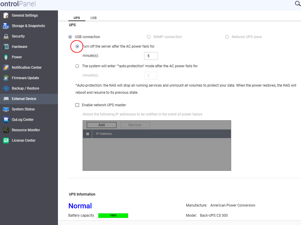

Hello,
i use only “Turn off the server …” and it work fine with all my nas
