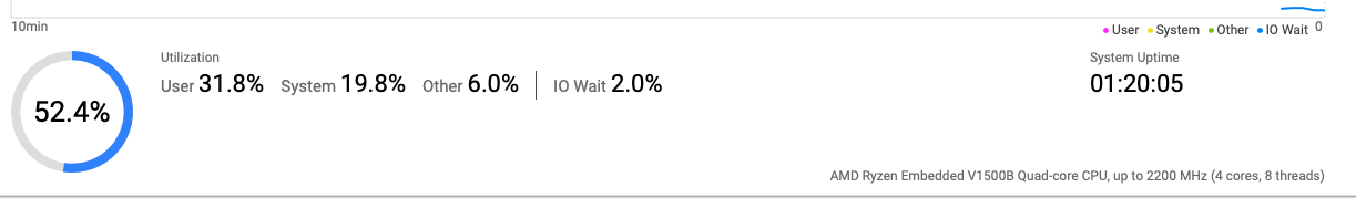

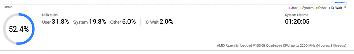

What are your system load averages?
I have 8 drives. Four of them are Western Digital HUH721010ALE600 10TB drives. These are in a RAID 5 configuration and is DataVol1.
The other 4 drives are 3 WD20EFRX-68EUZN0 2 TB drives and one WD1003FBYZ-010FB0 1 TB drive in a RAID 0 configuration.
I also have a crucial M.2 2TB SSD cache drive installed
Probably at least 40 percent. It’s always seemed high. On the TS-451 it was typically like 80 to 85 percent. The 10TB drives were in the TS-451. For the last hour and 20 minutes the NAS has been up the resource monitor shows:
