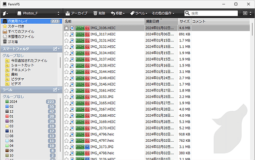

This time, as an experiment, I created folders with identical contents on both a local drive and a network drive, and then created automatic sync profiles for each.
On the local drive, labeling of files in the folder started immediately after the profile was created (see image).

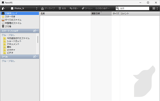

On the network drive, although the profile creation was completed, none of the files in the folder were displayed at all.
However, I noticed for the first time this time that if you add files to the network drive’s automatic sync folder (profile) while it is open in FenrirFS, only the added files are recognized.
If you switch to another profile or close FenrirFS, any files added during that time are not recognized.
On local drives and RockDiskNext network drives, any changes that occurred while FenrirFS was closed are immediately reflected when you reopen it.
