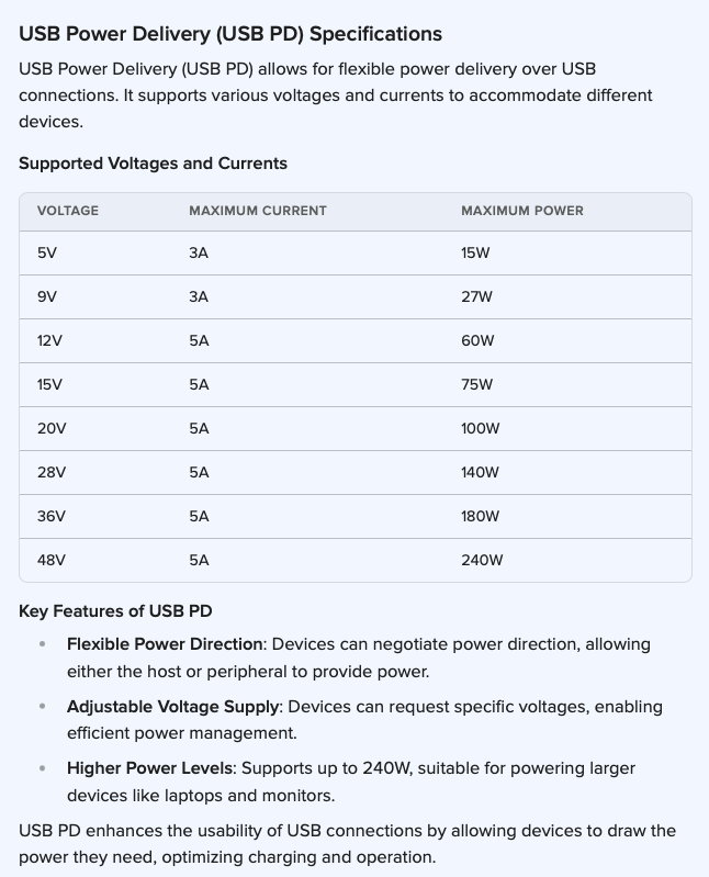

In a battery charge cycle. the battery has a chip on it that sends information back to the USB PD source about what it needs (ie: what voltage level, how much current, etc). When a battery is empty, the system will dump as much current as the battery allows. This is called constant current mode. The voltage at this point can vary. Once the battery is close to being charged, it switches to what is call constant voltage mode. At that point, the voltage remains fixed and the current will vary and gradually decrease to 0 as the battery becomes fully charged.
If you are not charging a battery but instead are just a “sink” device, the PD source will supply whatever voltage and current that sink device tells it to send. There are particular standards. All new devices with a “wall wart” are basically going to be USB-PD moving forward thanks to the European legislation. While I am more of a fan of the marketplace determining the winners and losers of technology as opposed to legislation, I think replacing all those stupid coaxial connectors of various sizes with a single standard is a brilliant idea.
Also, USB-PD is NOT USB-C. It uses the USB-C connector and USB-C can have PD (or not). PD is strictly power delivery and you can power just about anything with it. The next standard will be going up to like 250 Watts or so.
But back to the OPs post - just because the USB-PD device can support 140 Watts, it doesn’t mean it will support 140 Watts at 12 Volts. Do some research on the USB-PD current and voltage standards. You are limited in USB-PD to a maximum of 5 A. So if you want to go higher in power output, you must raise voltage.
The latest PD spec supports 240 Watts but to get that you have to use an output voltage of 48 Volts.
I would be careful about trying to just use a USB-PD supply at 12 Volts because that means your maxim power is 60 Watts. If your NAS is nominally running at 50 Watts, that means at peak times, it is probably hitting well above 60. This means if it needs power, it won’t get it which will cause things to behave badly.
Now if you want to get complicated and use a 48 V output and then add a DC-DC buck converter to drop it down to 12 volts, have fun! :smiley: That would be a big power supply.
