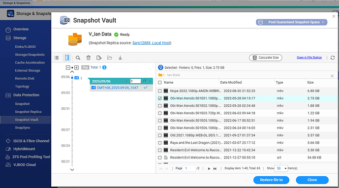

That article does a great job explaining how to set up the snapshot replication job and how to clone it from the vault. What it does NOT do is explain how to restore the data back to the original NAS. The clone just clones the data in the snapshot to the local NAS - it does not transfer it back to the original NAS.

Usually, after you’ve made a snapshot backup to another NAS, you should be able to just hit the [Revert] button to get your data back.
Snapshots are basically like taking an image of the data as it exists at a certain point in time. The snapshot itself is tied to a dataset — on QTS that means the whole volume, but on QuTS hero it can be just a single folder.
So, after you hit the [Revert] button (like I mentioned before), if what you want is just to make another copy of the files instead of rolling everything back, that’s when you’d use the [Clone] button in the bottom right.

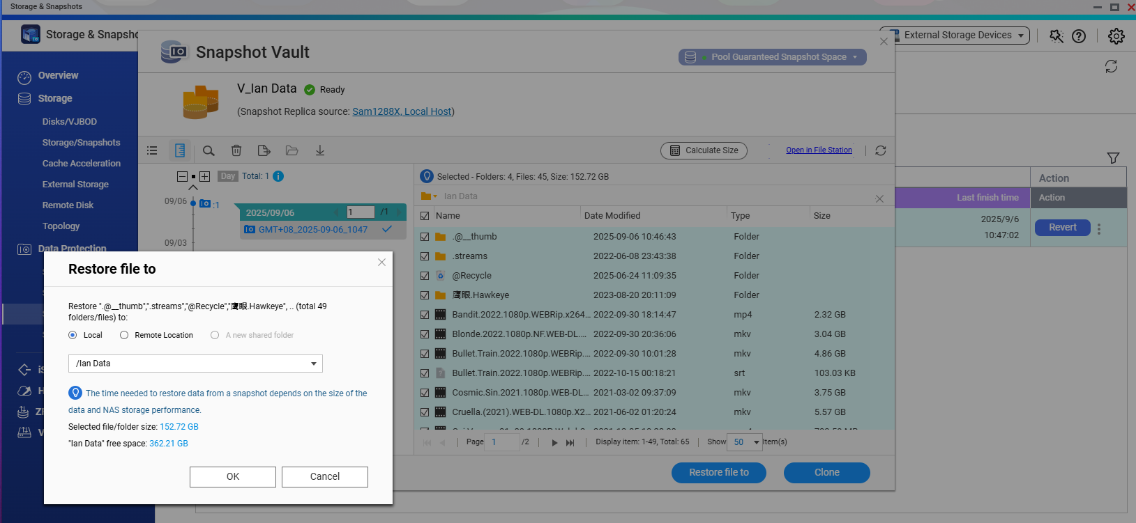

And if you’re trying to restore the snapshot back onto the original NAS, then you’d actually want the [Restore to] option.
By the way, if you’re doing a full restore, you need to select the entire dataset that was included when the snapshot was created. But if you only want to pull back certain files, you can drill down into the snapshot and check just the ones you need.
But “Restore To” does not restore it to the exact spot you came from. You have to choose a shared folder on the original NAS and then restore. Then once restored, you have to move the folders back to their original location.

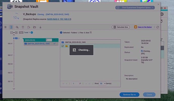

I’m also having a problem now of it just showing “checking” when trying to restore the snapshot:
It stays this way forever…

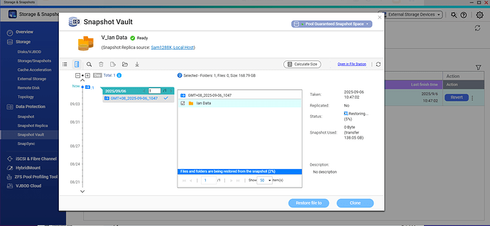

Yeah, basically you can restore straight back to most of the original locations — except for system and /.
So if it’s data under /(root) that you want to put back in the original location, you’ll actually need to go one level deeper and then just select all
Sorry to hear your setup ran into that stuck issue. just open a support ticket or reach out to Steve — our tech support team will help you check it out.
