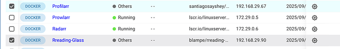

I have been successfully deploying apps like PiHole, Sonarr, and Radarr until something went wrong with the deployment. The new apps I am deploying initially have ports, but in a bit, the ports disappear and the app is inaccessible through the browser. The pic below illustrates what I have explained:
I have restarted the NAS as well as Portainer, but to no avail. I have even redeployed them repeatedly, and that hasn’t worked either.
Hopefully, someone can show me what I am doing wrong or what could have gone wrong. All help will be appreciated. For me, moving from Synology to QNAP has been a little rough. It seems QNAP is more suitable for people who know exactly what they are doing. Synology seems to work for noobs.
Regards

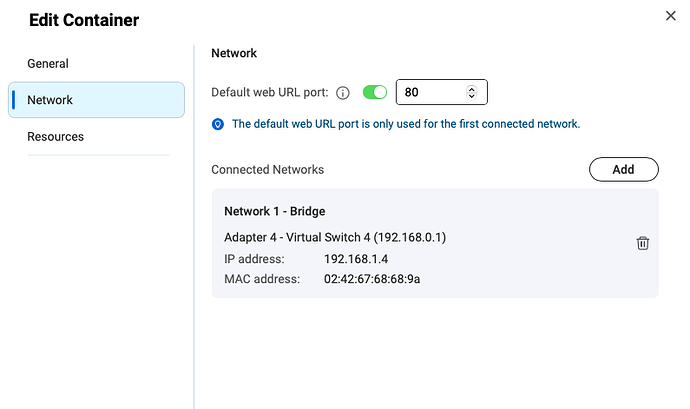

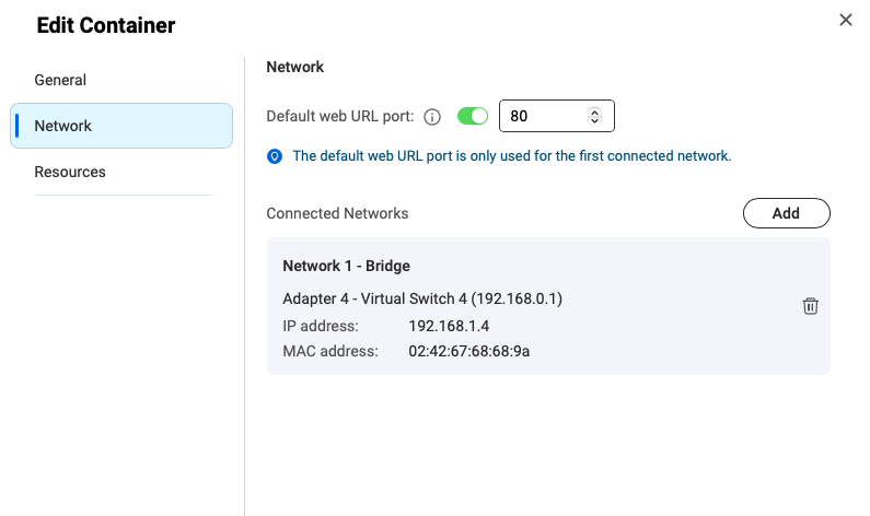

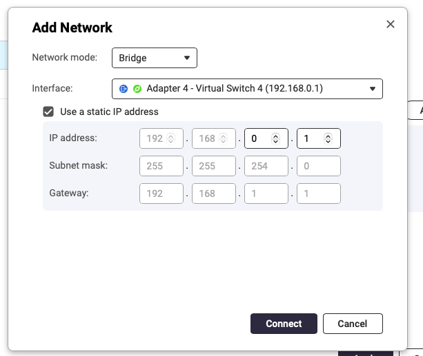

1.) Open Container Station.
2.) Select your particular container app and then click the “Edit” button in the upper right:
3.) Select Network. This is how my PiHole instance is set up
You will have to delete the initial set up which would be NAT. The click Add. Select Network Mode as Bridge and click to use a static IP (absolutely needed if you are using PiHole, etc).
The default address will be the address of the NAS (in my case 192.168.0.1) but pick another address that is outside of your DHCP pool on your network. Fill out all the normal network stuff and off you go.
This should help you quite a bit. Please let me know if you still need help.

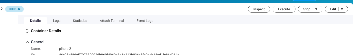

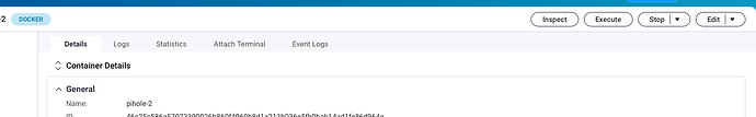

Hi,

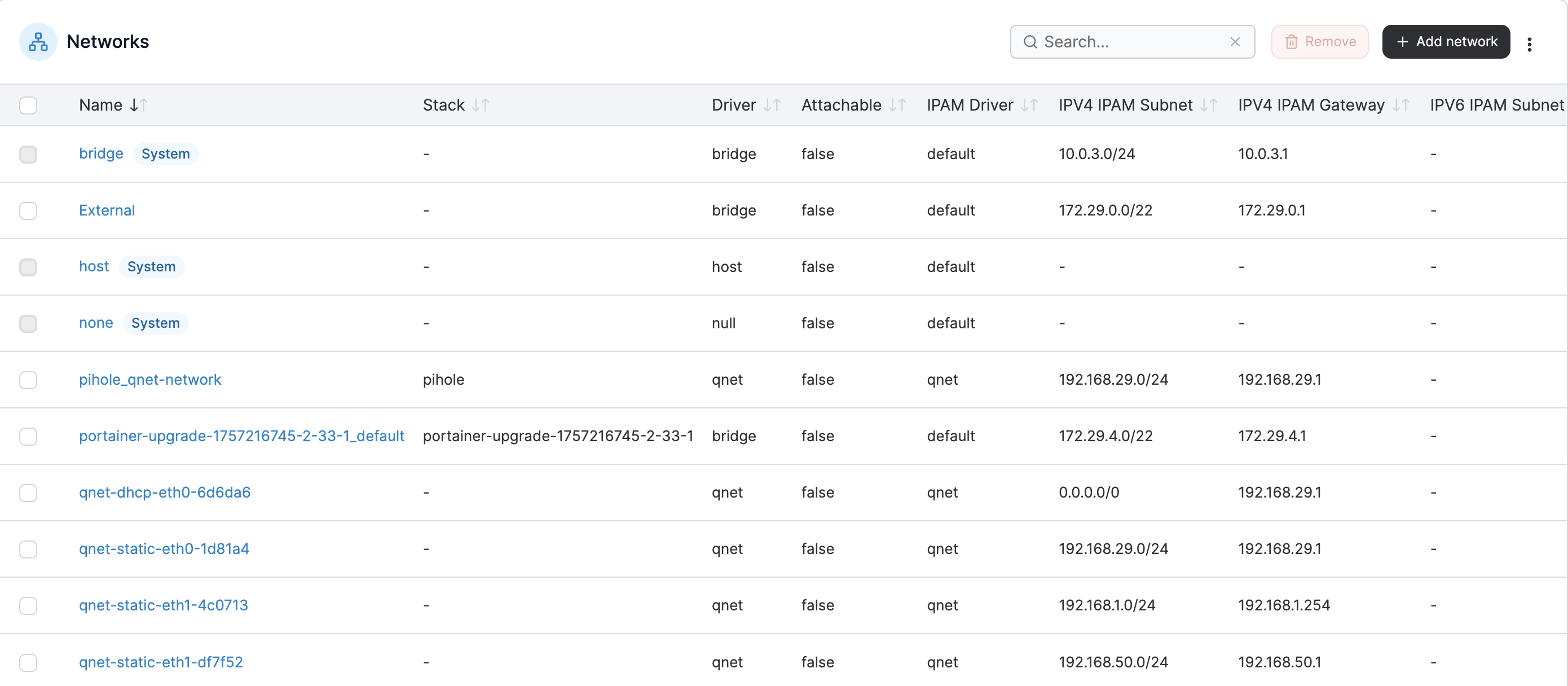

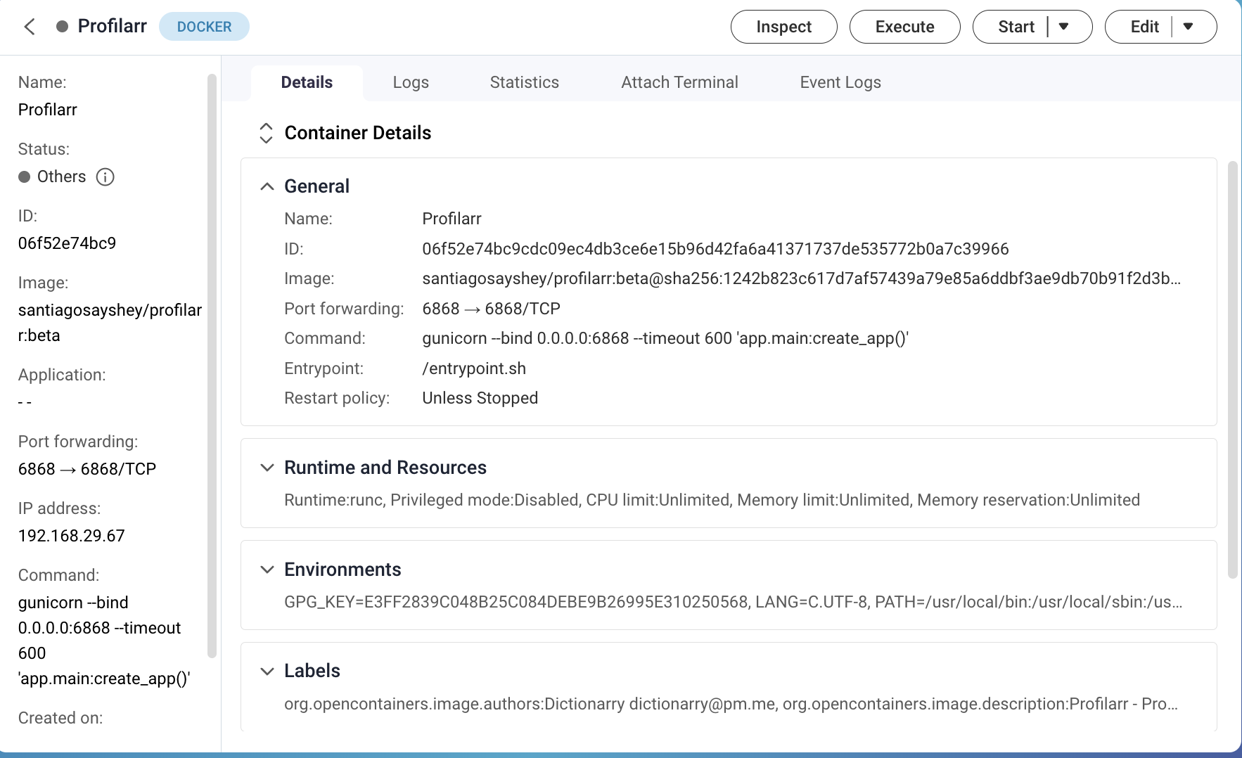

Thank you for responding. I have been doing what you say for most deployments. My Pihole works precisely as you mentioned. I have stopped it currently as it is slowing down the web as well as not allowing some allowed sites to open.
Nonetheless I did exactly as you mentioned and got the same result:

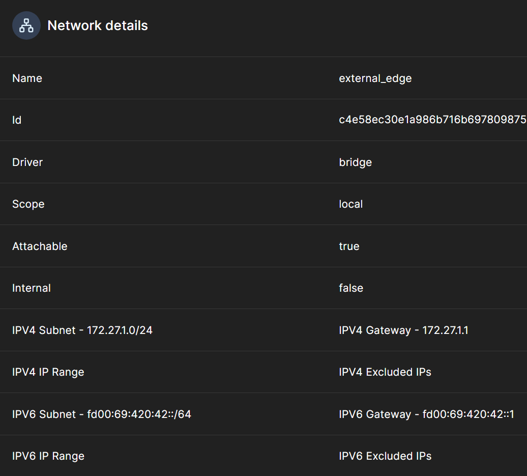

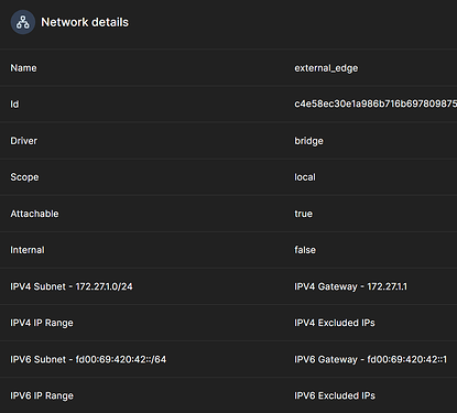

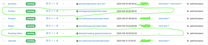

I deployed this using Portainer. I followed what was mentioned in this guide (pasting the time link):
I created a network called external and started deploying Sonarr, Radarr, etc, which are working fine.
Hope this helps you in helping me.

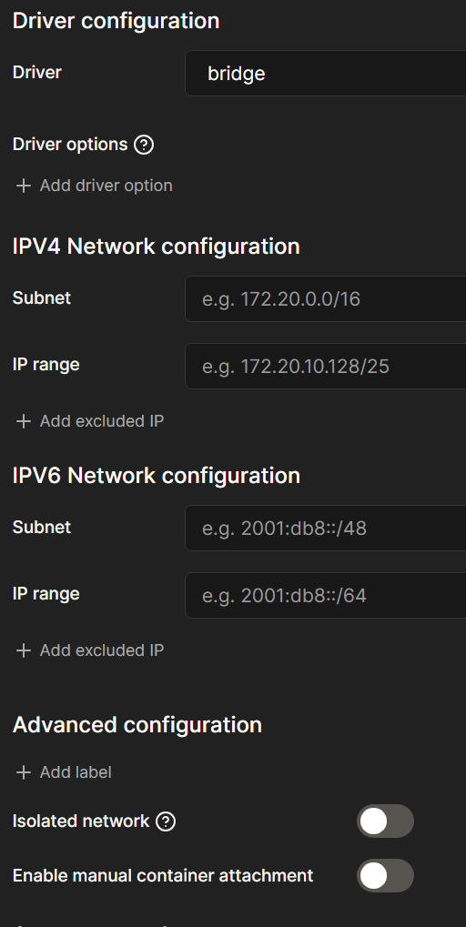

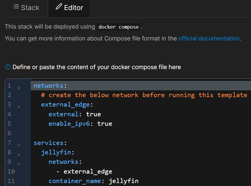

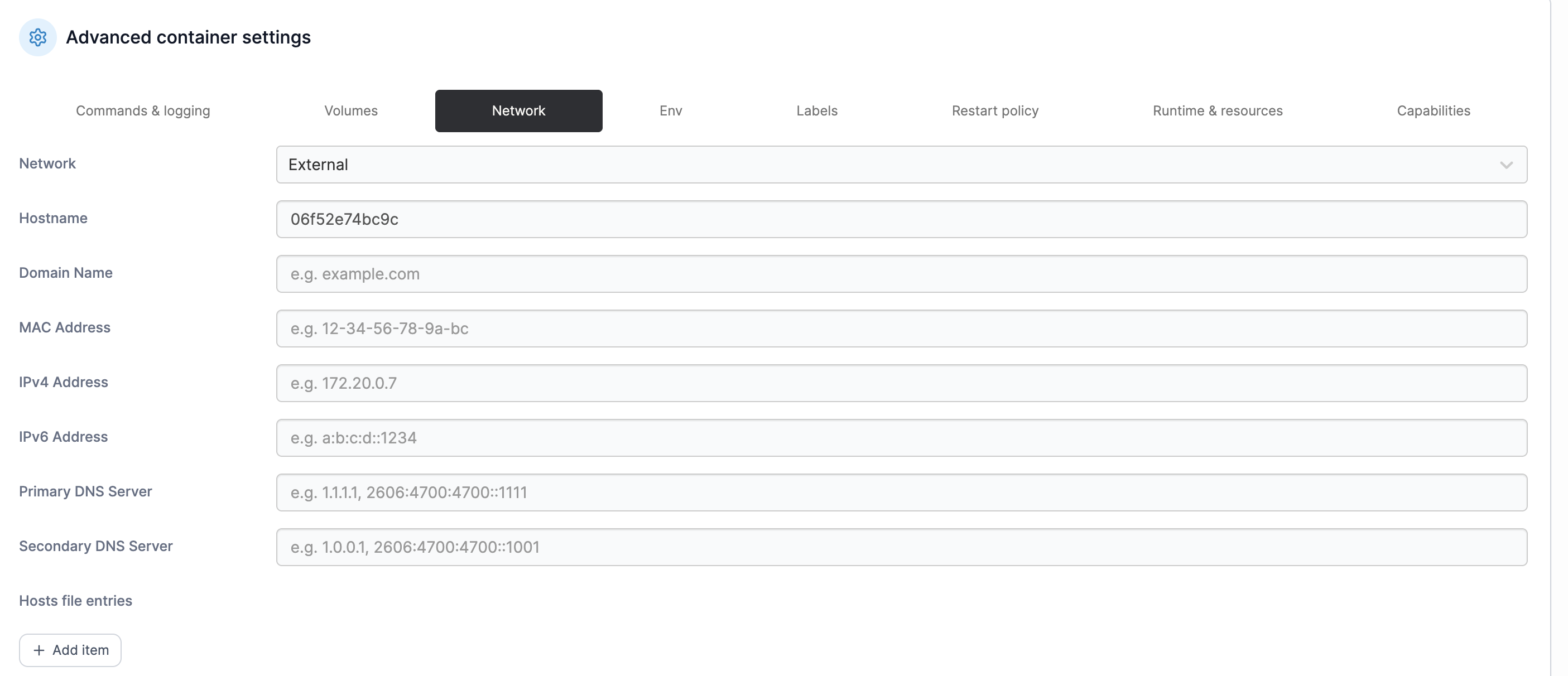

If you are going to use Portainer GUI I think you need to flip “Enable manual container attachment” ON.
I setup mine with a little SSH
docker network rm external_edge
docker network create \
  --driver "bridge" \
  --opt "encrypted" \
  --scope "local" \
  --subnet "172.27.1.0/24" \
  --subnet "fd00:69:420:42::/64" \
  --ipv6 \
  --attachable \
  "external_edge"

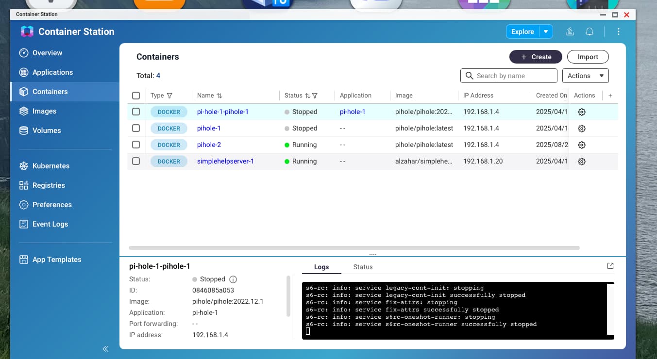

Pihole will block some sites by default - like if you are on Amazon and click on on a “sponsored” item. It’s likely going to be blocked. You can whitelist and change things to allow sites to load.
It really should not slow down your browsing one bit, not if you have it set up correctly and all.

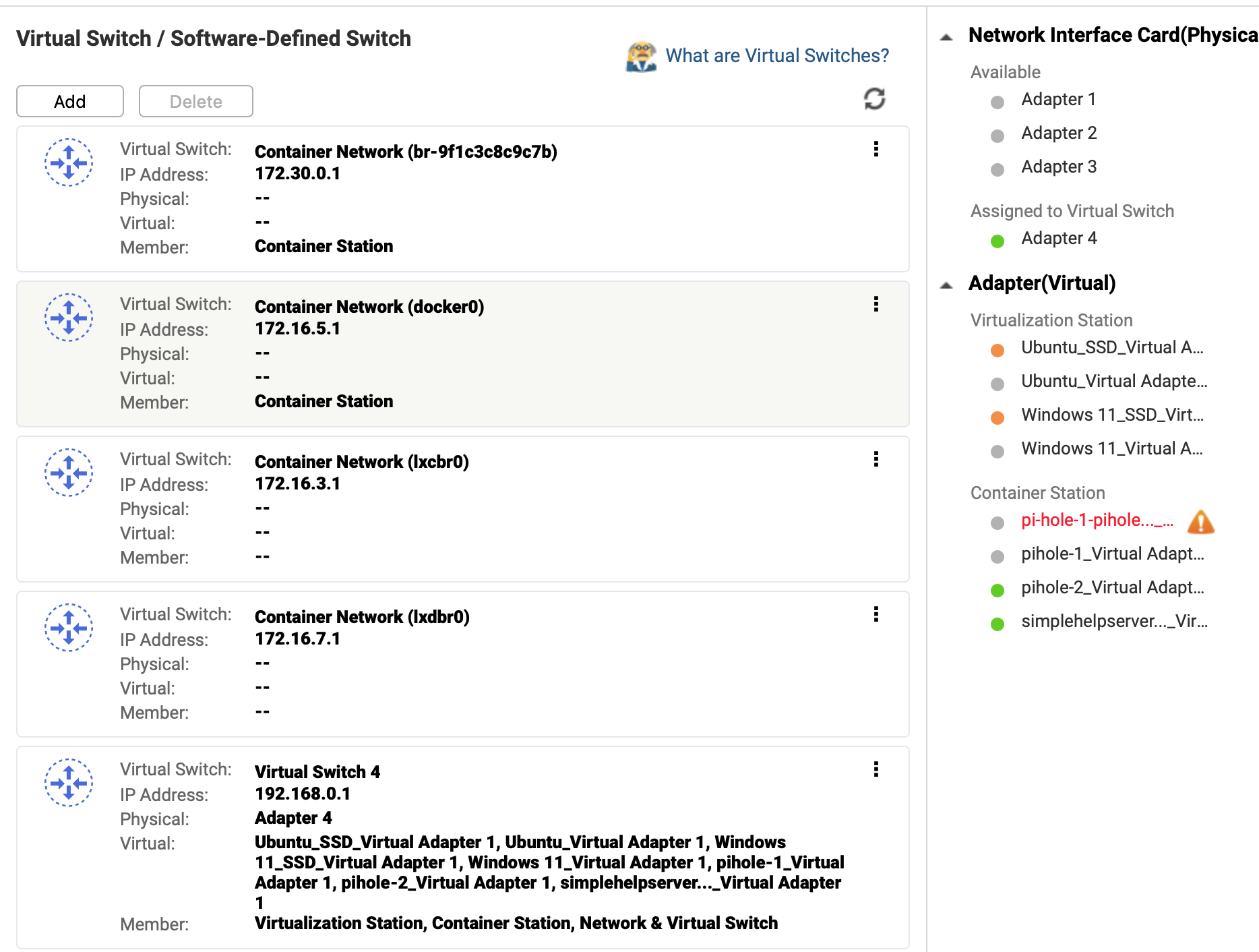

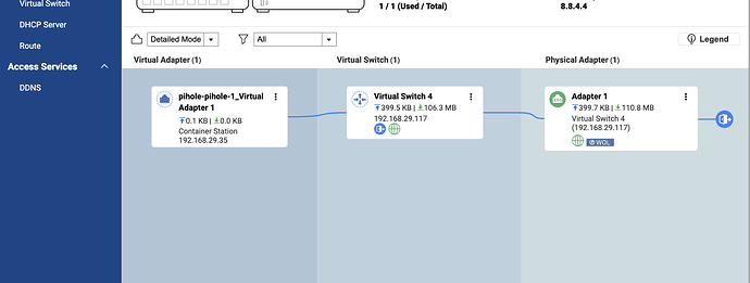

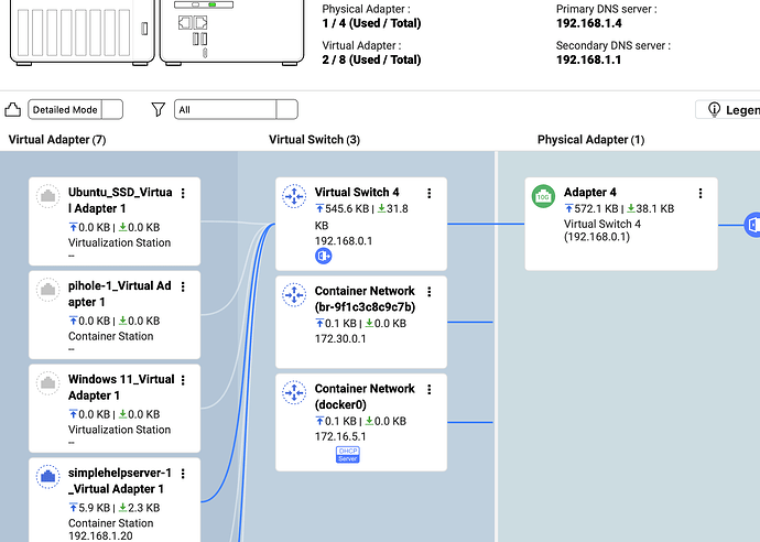

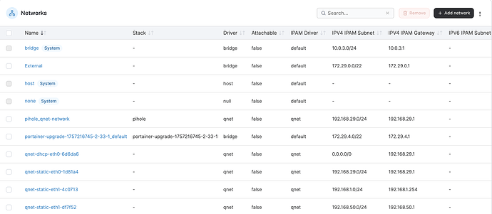

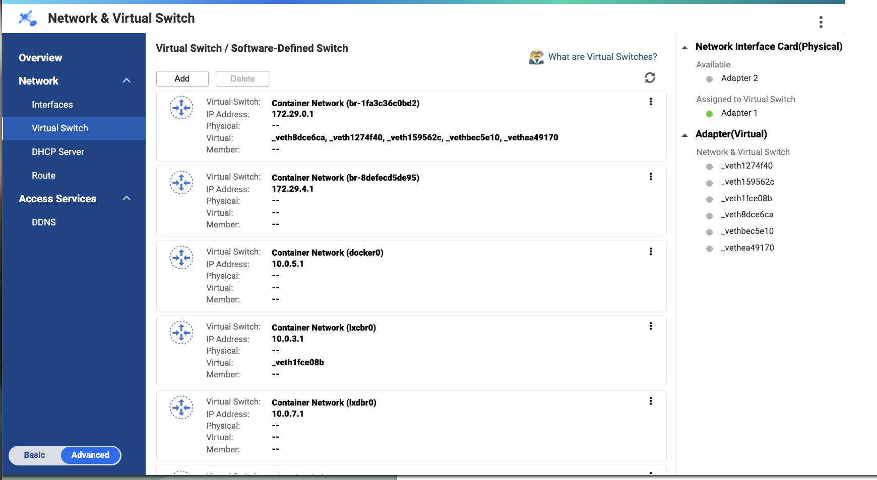

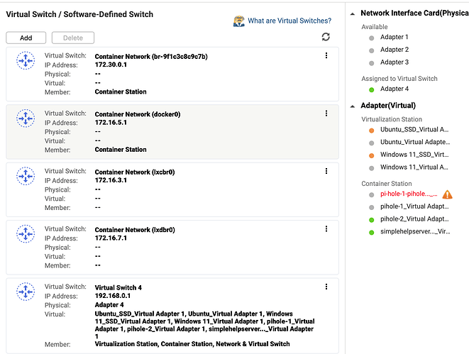

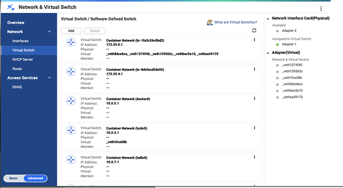

You showed your “Networks” image above. What page is that from? That is not from Network and Virtual Switch. That is not what NVS shows. Is that from Portainer? Why are you running Portainer? You already have Container Station on the NAS…There is no reason to use Portainer and that is likely part of your problem.
In NVS, you see the networks like this:
And:
I have no idea how you have your system set up since it’s way outside Container Station and it’s possible you have multiple NAT layers or routing paths which is why you get disconnections and slow pi-hole performance. I’m sorry but I cannot help you further since you are not using ContainerStation and I have no idea how Portainer works or how it should be set up.

Hi @Weedy - “Enable manual container attachment ON" how do I flip it on?

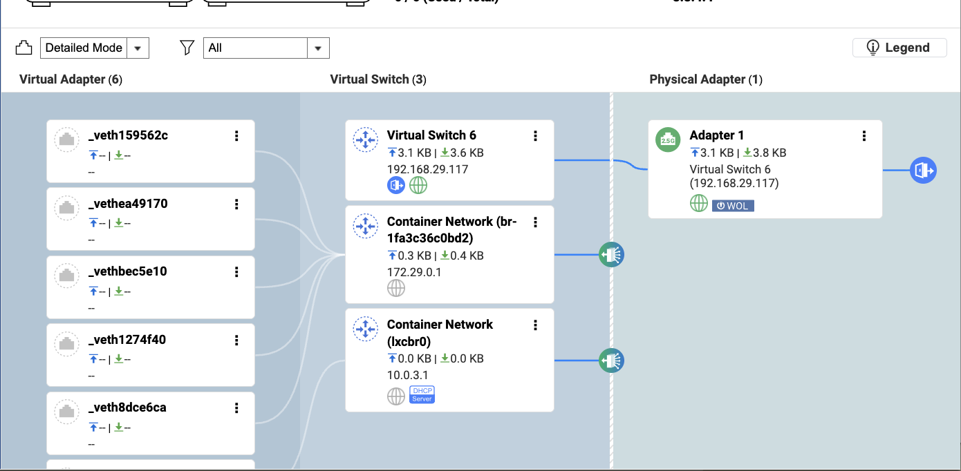

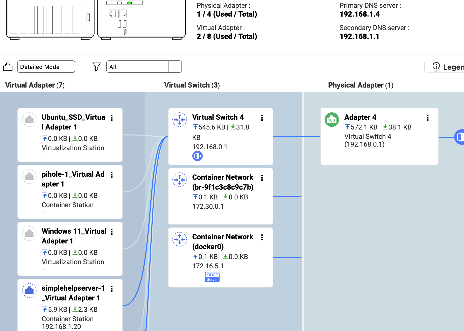

Looking at your virtual switch config, all your containers are on the 172.29.0.0 network which is different from your LAN of 192.168.29.0. I think therein lies your problem. You are having to NAT for every DNS lookup and relying on the routing provided by NVS. Take and put your Container Network onto your LAN in bridge mode so you don’t have to do all that extra work.
When you made the bridge, the toggle is right there.

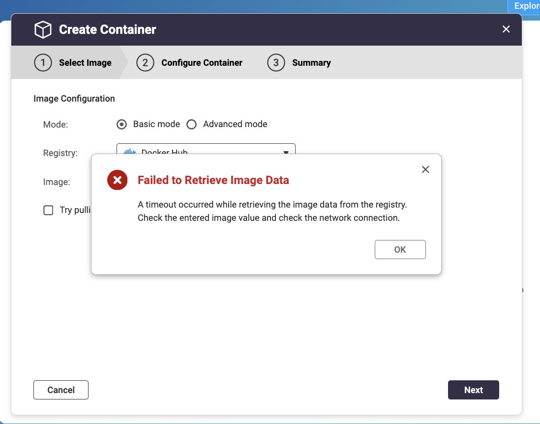

Also, another issue has crept up where I can explore for apps but I cannot create them. I wonder how to take care of that:
Does not work whether I use the basic or advanced mode.

@Weedy, I figured out ‘enable manual container attachment’ on the Portainer deploy page. I don’t see the driver configuration set up anywhere.

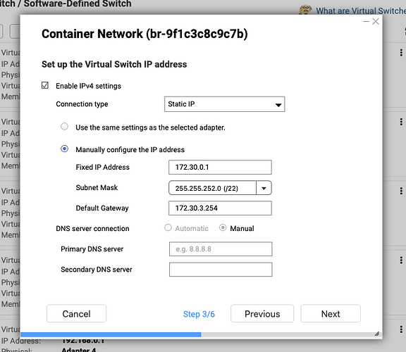

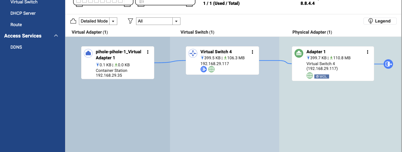

You can’t delete the virtual switch. What you can do is move those items to be utilized by your main NIC.
I don’t know how Portainer does it but it ContainerStation, you can set the network mode to bride and chose an IP address, etc.

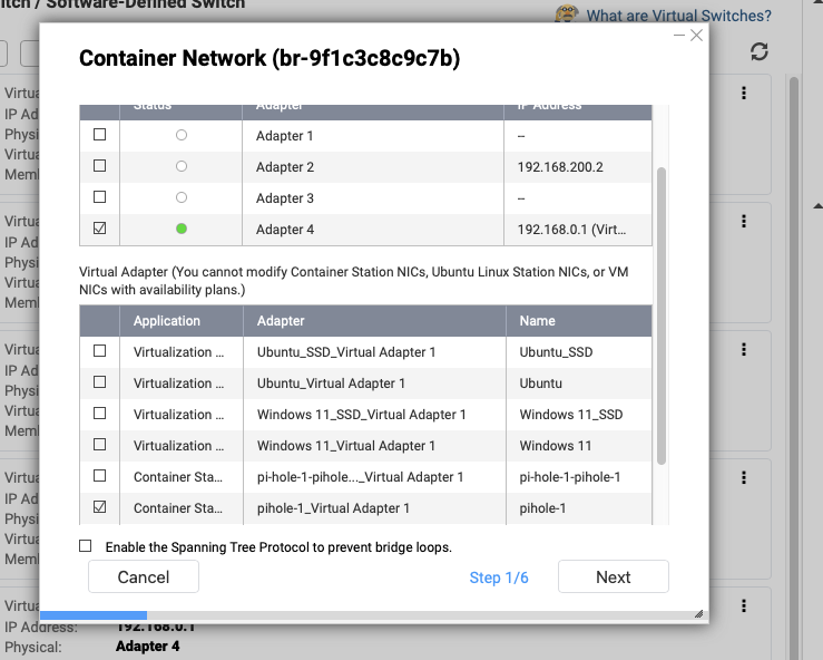

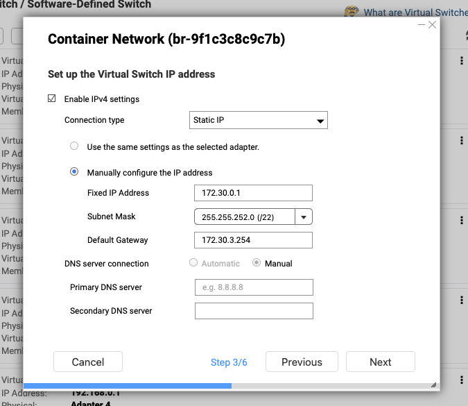

You can move your container network to the main LAN in Network and Virtual Switch. Right click on the container network and select “Settings.” Then you chose the adapter and the application:
Then click next. Click next again and you get:
Here you should be able to set your IP address, etc. Again, YMMV because you are using Portainer. I am not 100% sure how to guide you.
Yes, virtual adapters are used all the time. I’m not sure why you were not having luck creating the container.

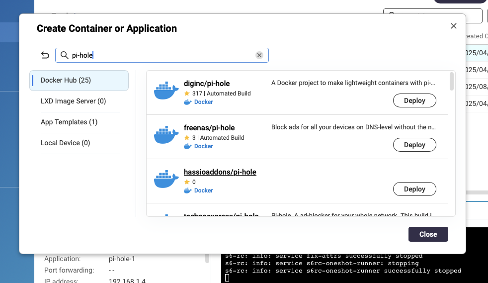

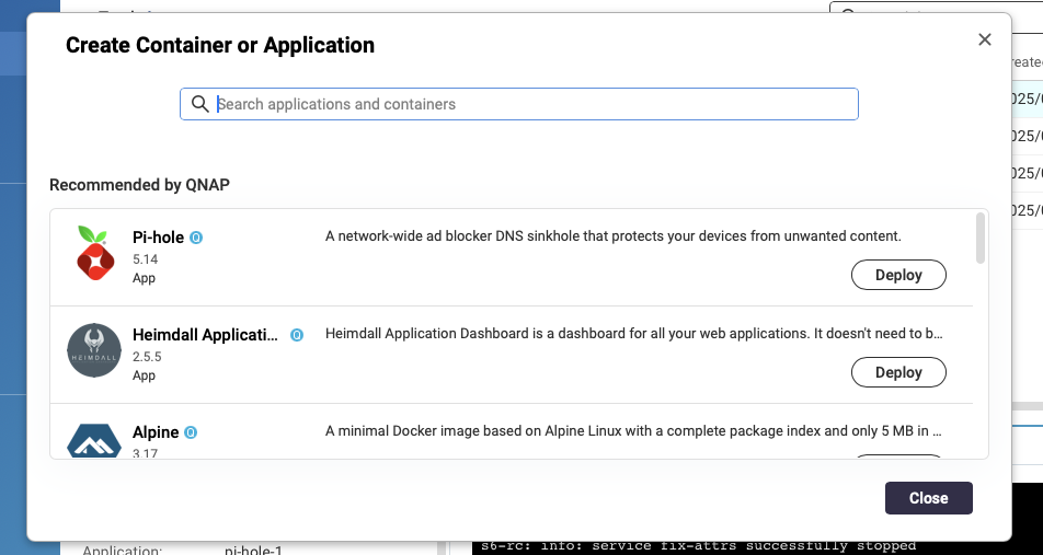

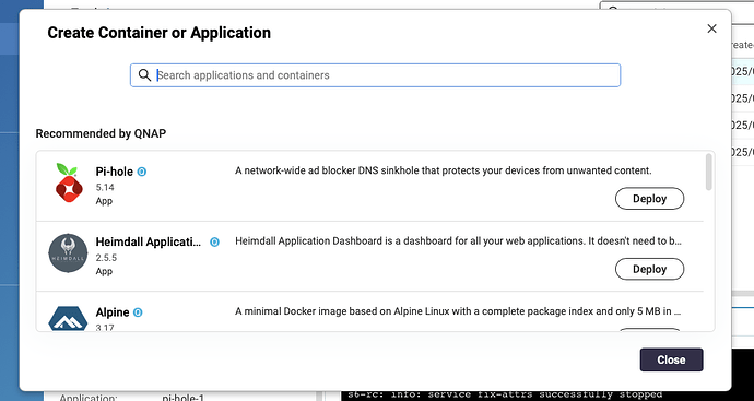

One of the QNAP staff members yesterday posted a very good tutorial on installing PiHole. I’m not sure if the version that gets installed in that writeup is the latest build but it’s a good way to start.

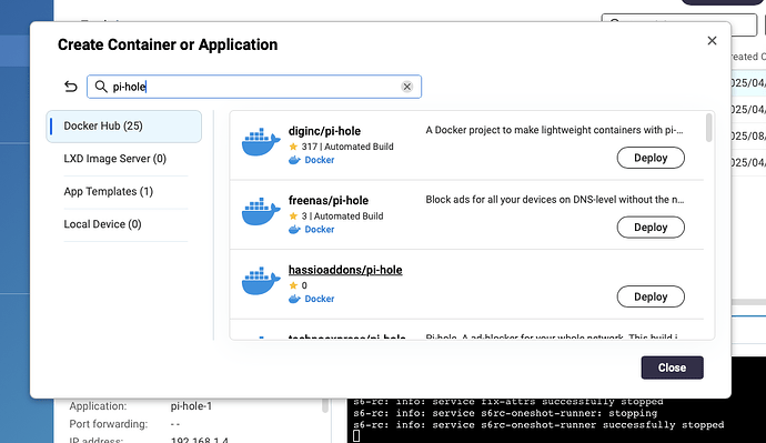

But in CS, don’t try to enter the name of the package in the Create Container page. In the main page, click on Explore:
There’s Pi-Hole right there. Now you can also Search for pi-hole in the repository…
Do it this way and you should have no problem deploying…

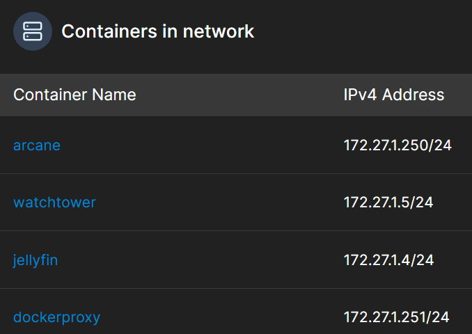

One thing with good tutorials (the one you used, the one I used). They had us keep apps outside of CS data directory. So it’s really easy to back up everything and move containers off the NAS if the time comes for a more powerful machine. I have everything under /share/docker/ (QuTS)
