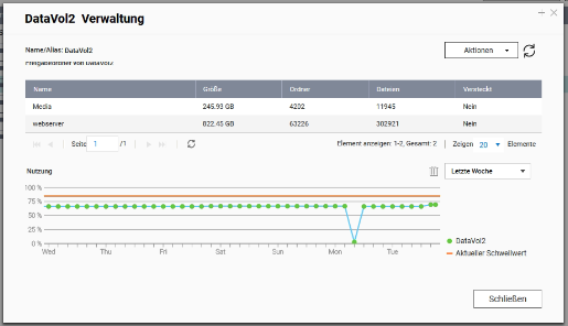

Here the picture where you can see that almost all files are gone.
I’m absolutely sure that there is no such bug deleting files. I’m pretty sure that someone is deleting the files. Go and enable enhanced logging to see who accesses the files and whether it is reading/writing/executing/deleting.
I think this could be done with security center

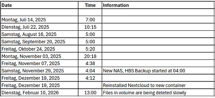

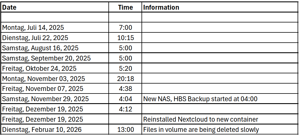

Hi, i was never able to enable a better detail level of logging, so finaly i bought a newer qnap. Unfortunately also here I had the issue with data loss, so at the end i recreated the main container accessing the nfs shares, and the last time i had a data loss was now Febraury 10th 2026.
I never found out what is deleting the files but still have an eye on it.
