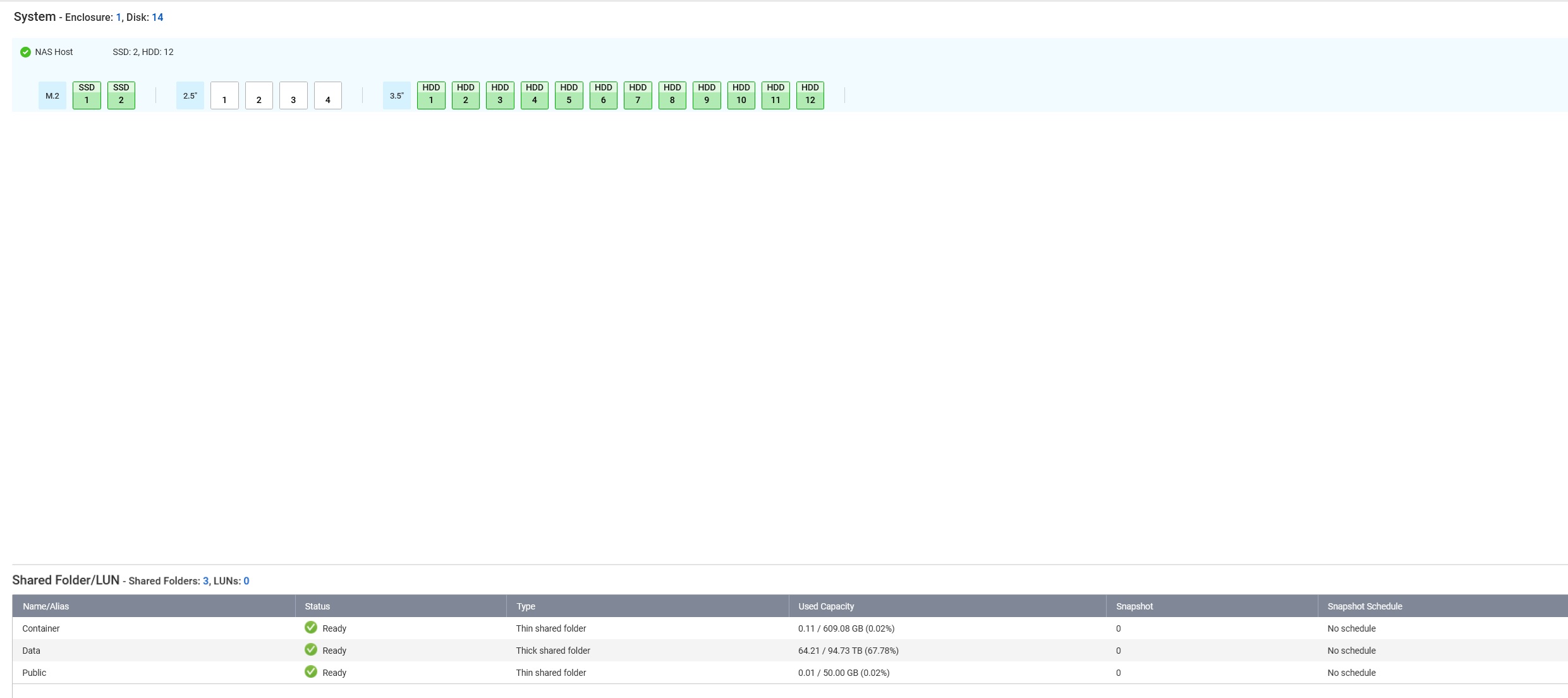

I have a Qnap TVS H1688X with a qnap Intel E810 100Gbe card and 10TB (WD Gold) x 12 in raid 5 Stroage pool 2 plus 2x1TB Samsung 990 Pro NVME in Raid 1 for a storage pool 1, this is connected to my qnap switch M7308R-4X via 100gbe DAC cable.

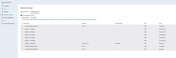

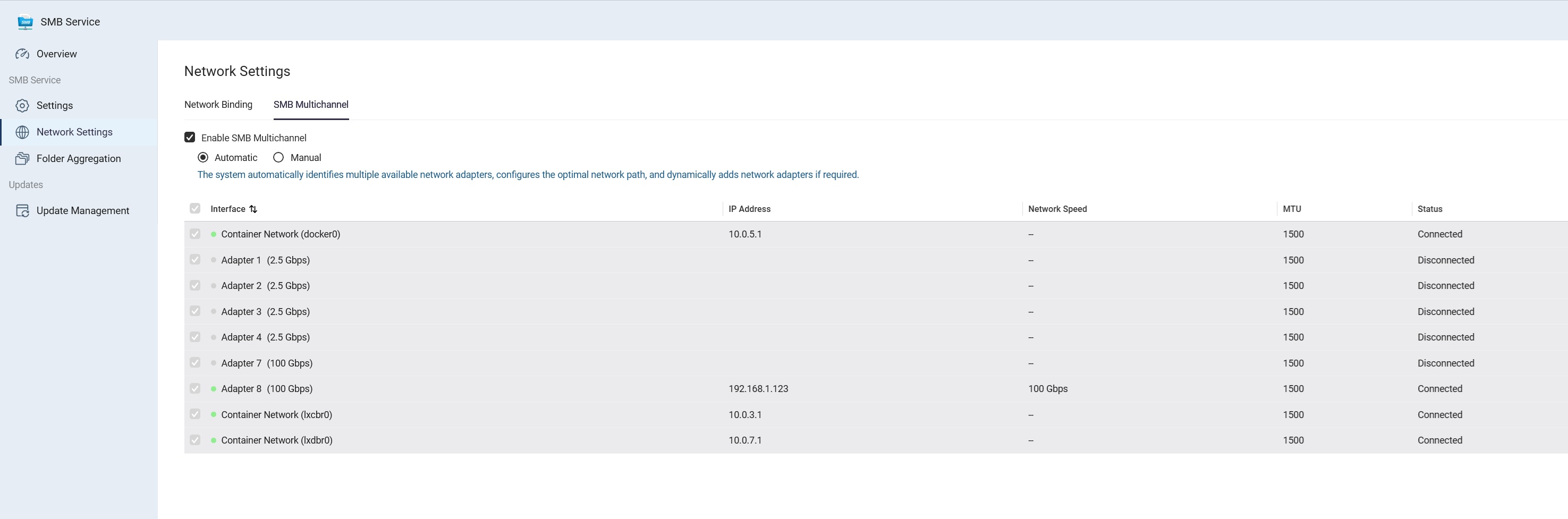

The Intel based windows 11 enterprise PC also has Intel E810 25Gbe card which has Dual fibre cable going to the switch with SMB Multichannel enabled.

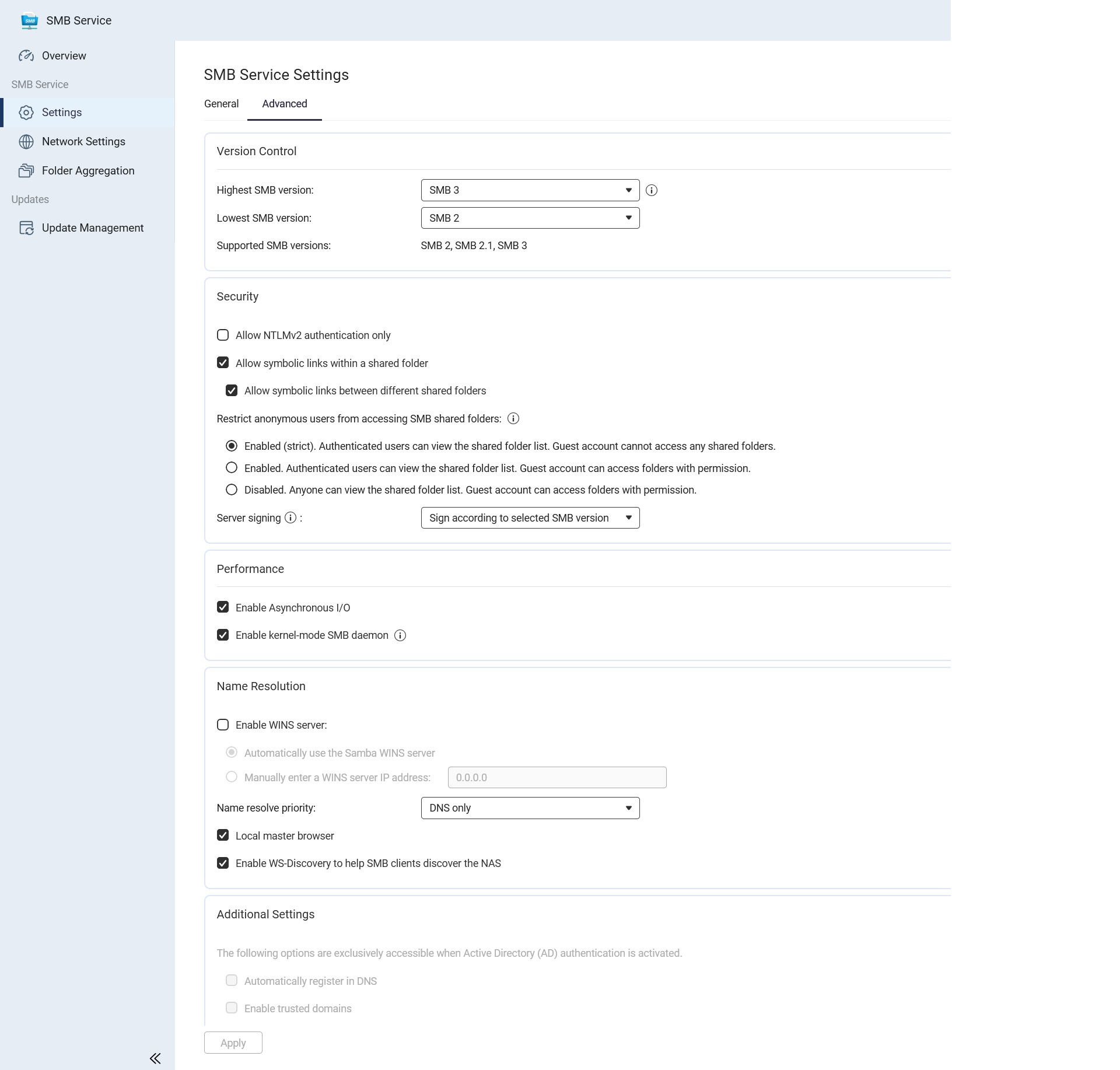

Am I missing a setting or something?

The MTU I changed to 1500 after i was having issues on my PC’s AV (Eset) if i set it to 9000 MTU.
