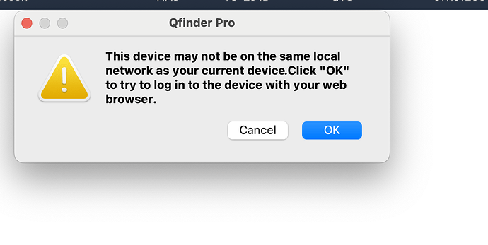

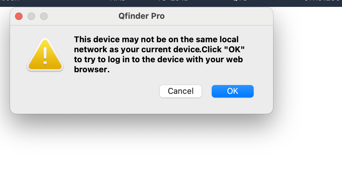

I am running a TS-251 and on QTS 5.1.9.2954. I cannot log on to the NAS via the IP Address. When I select the NAS in Qfinder, I get this error message.
What should I do here?

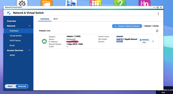

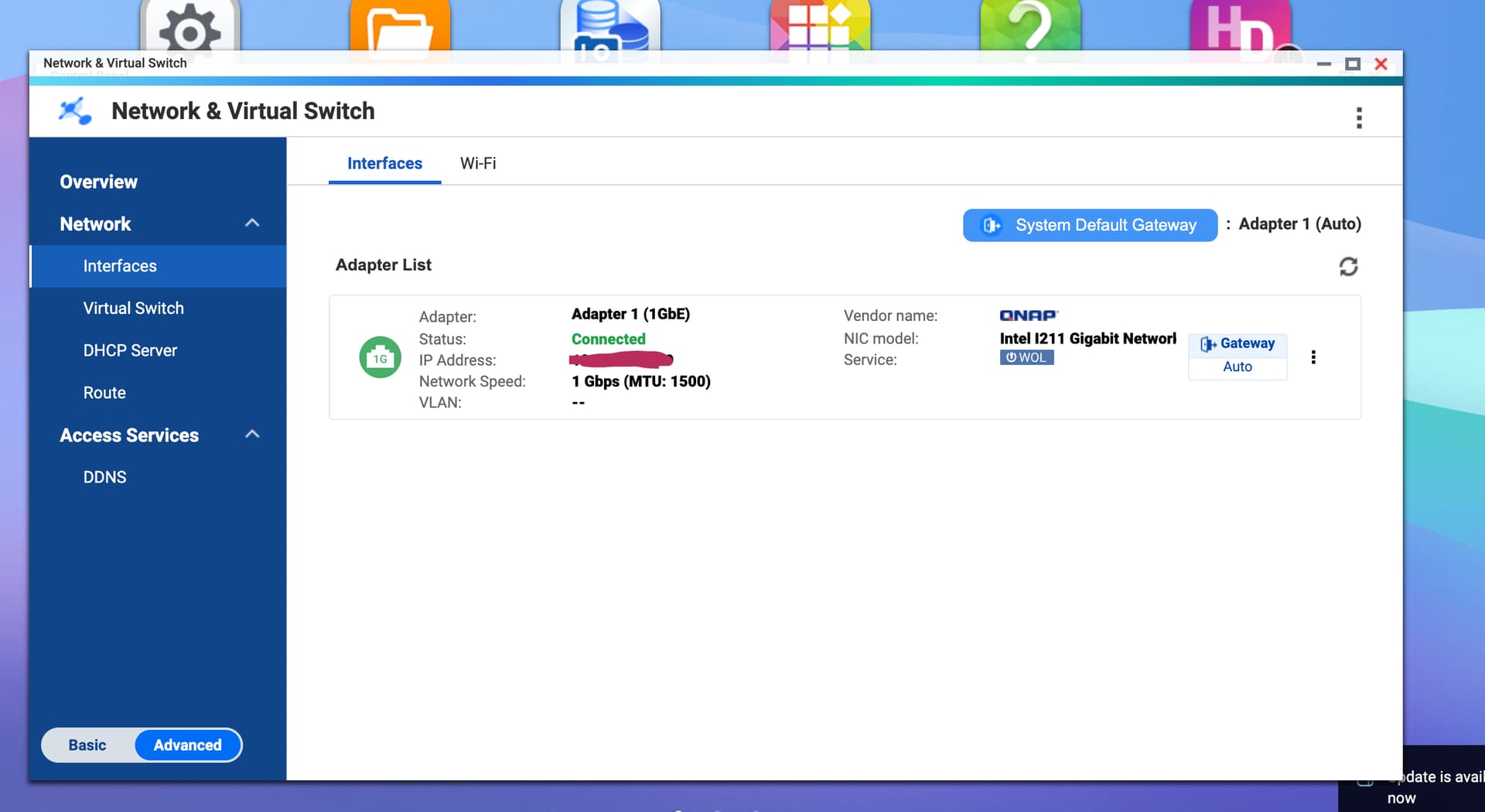

Since can log in via myQNAPcloud, should be able to go to Network & Virtual Switch to check its current IP, and then log in using that IP? (And confirm whether the group IP is the same as that displayed by Qfinder)
Thanks. OK, I checked that.
The IP address that is listed there is the same that I have had, but I cannot use it to access the QNAP. I can access other services that are installed on the QNAP remotely (e.g. Emby)

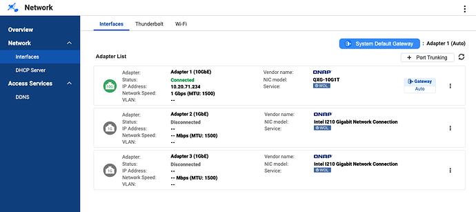

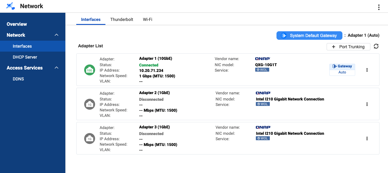

Hi @dm, I just tried it here with one of my NAS. That site couldn’t connect to the NAS after providing the cloud key.
