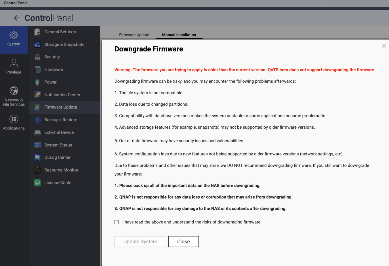

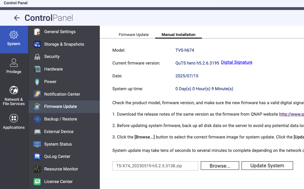

Hi @dons1960 we have reproduced a similar issue. With the same QVR Server version and camera configuration, the QTS 5.2.6 uses more CPU resources than QTS 5.2.5. We are currently investigating the cause.
If you want to downgrade the firmware, you need to download the QTS 5.2.5 firmware file from the website.
Then go to the Control Panel → System → Firmware Update → Manual installationand use that file to update system
After uploading the firmware file to the NAS, a “Downgrade Firmware” confirmation window should appear. Click “I have read…” to process with the downgrade.
Or you can refer to this page to downgrade
