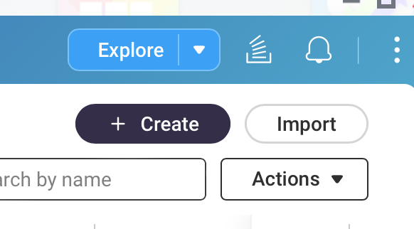

How did you use CS to make the container?
I imagine if you started with a application we wouldn’t be having so much trouble, did you use the + Create button from the container tab?

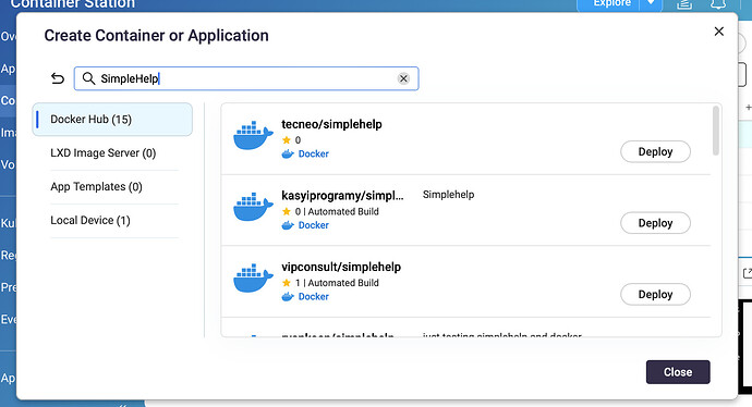

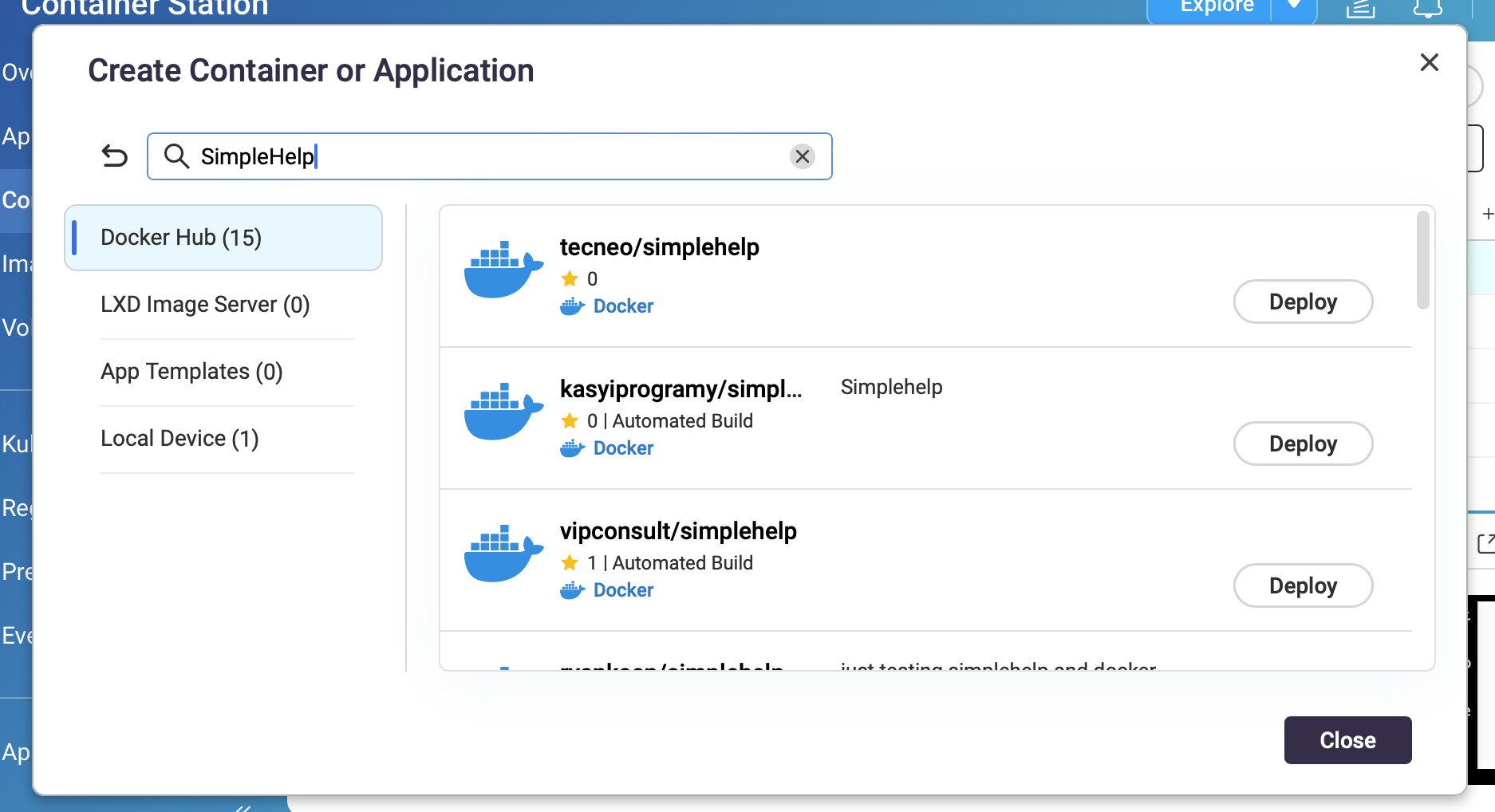

I used Explore:
Then I searched for SimpleHelp:
And picked the one that I could find that was the newest at the time. Since then there have been updates and I need access to the file system to basically replace the files.

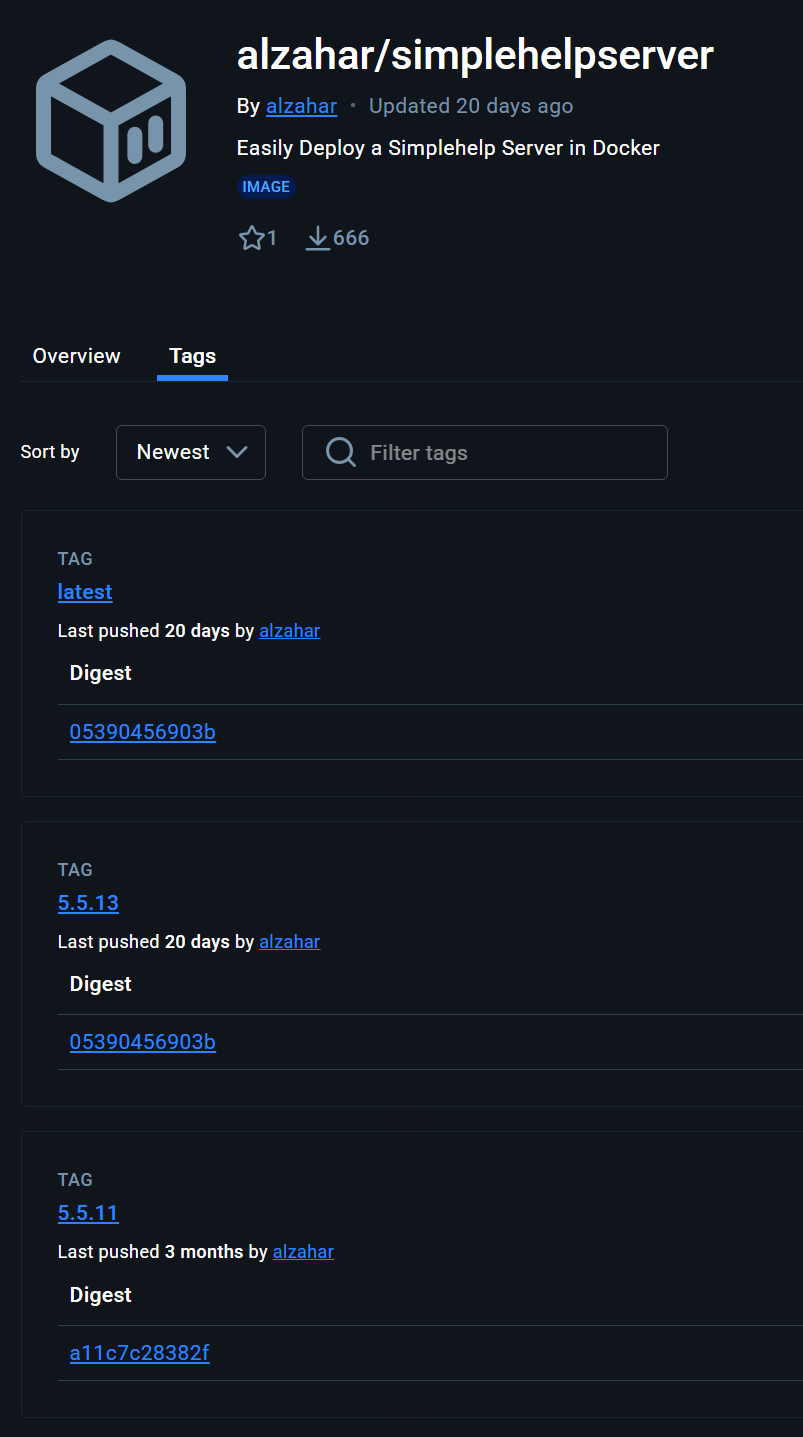

The newest package is from this guy.
Which copies in the software from who knows where

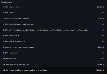

The “5 year old” package
Runs wget raw to grab the software at build time directly from SH website.
And the final image is smaller.
I got my original package from the alhazar package you show above.

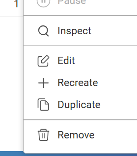

You would then Application → Recreate it. Every time you create the container with the image tecneo/simplehelp made it calls wget and downloads the server at build time.

Well, this is interesting… I have been working to install things using this package here. You say that it is supposed to get the very latest from the SimpleHelp website. But it doesn’t. The latest is 5.5.13. But what came up when I built it was 5.2.1. That could explain why I was having some issues with it ready my config file. Seems like wget is not “getting.”
Hmm…OK. Why isn’t this updating. So my issues were 100% related to trying to use a newer config and client software to log into a 5 year old server package. I switched to the Alzahar/Latest and that got me to 5.5.9, but the latest and according to the package there in your images it is 5.5.13.

Why am I not pulling the latest package?
