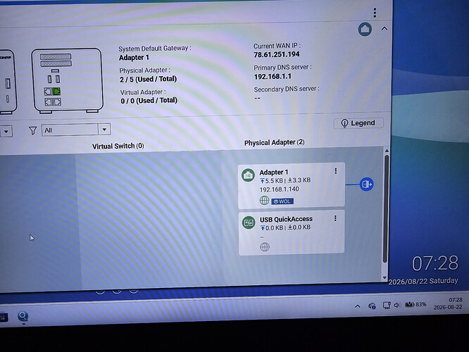

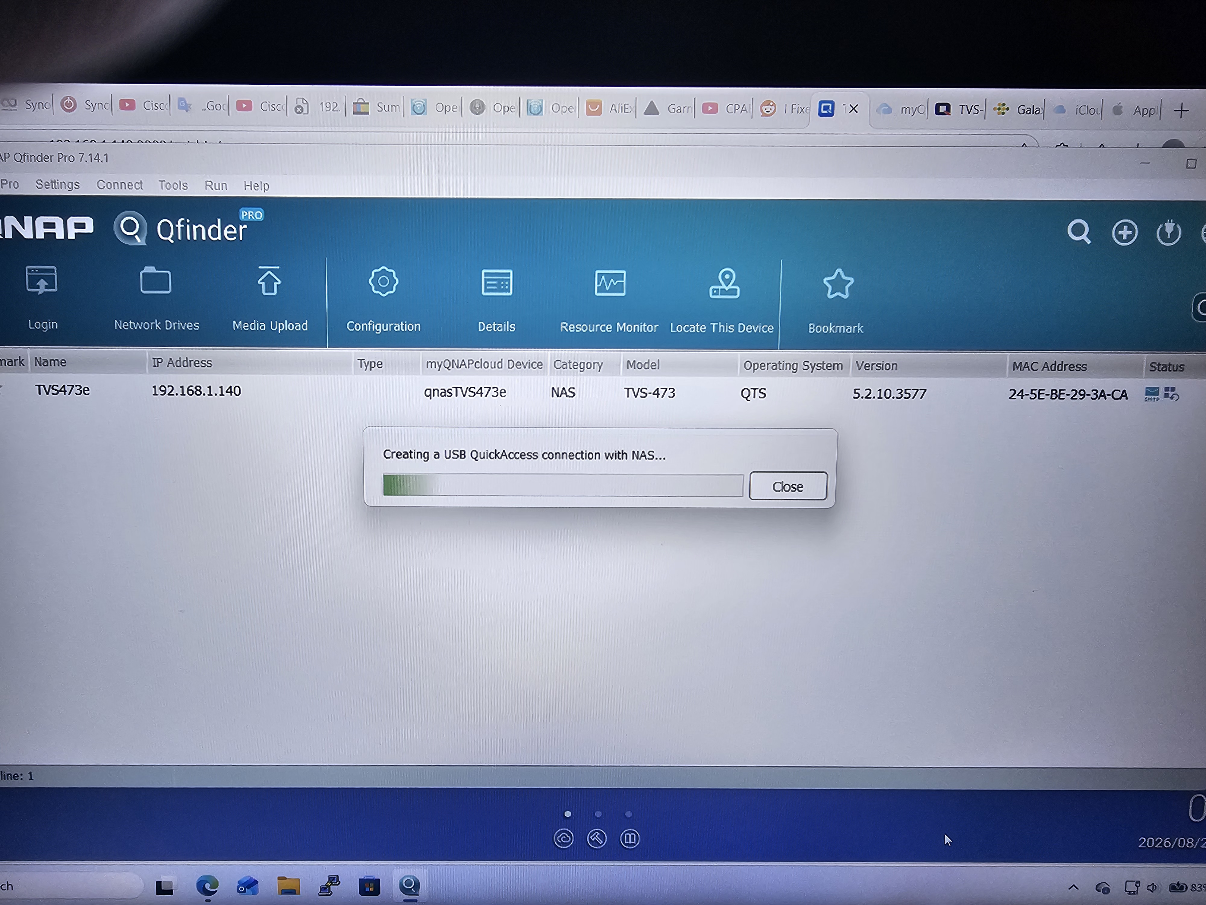

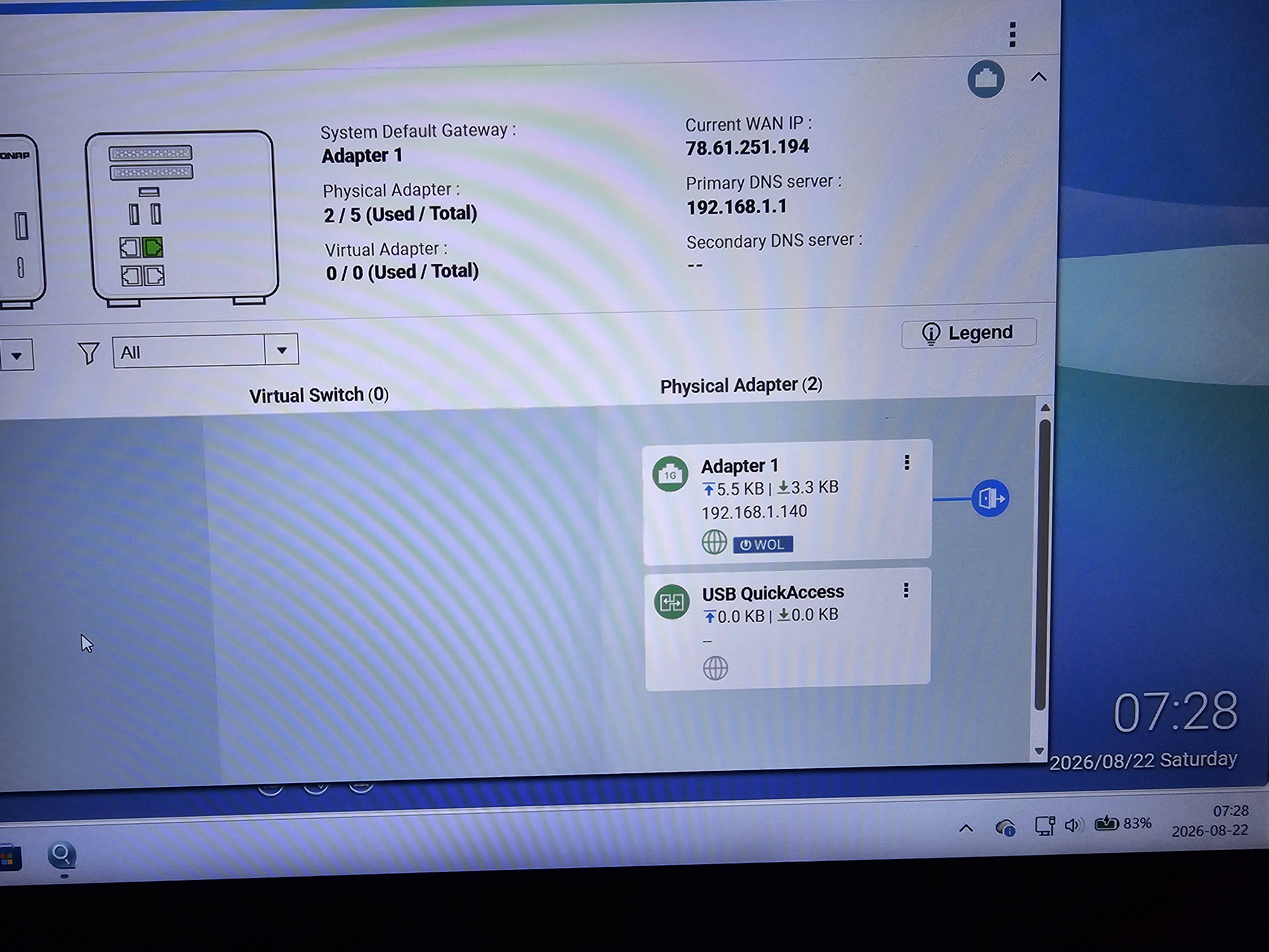

This is what happens and it doesn’t connect.
When the network cable is unplugged, the address received from the USB Quick is 0.0.0.0.

Qfinder does not connect to me. The QuickAccess icon does not appear. The cable is short and I tried another one with the same result. Qfinder finds the NAS with the 0.0.0.0 address and there is no access.

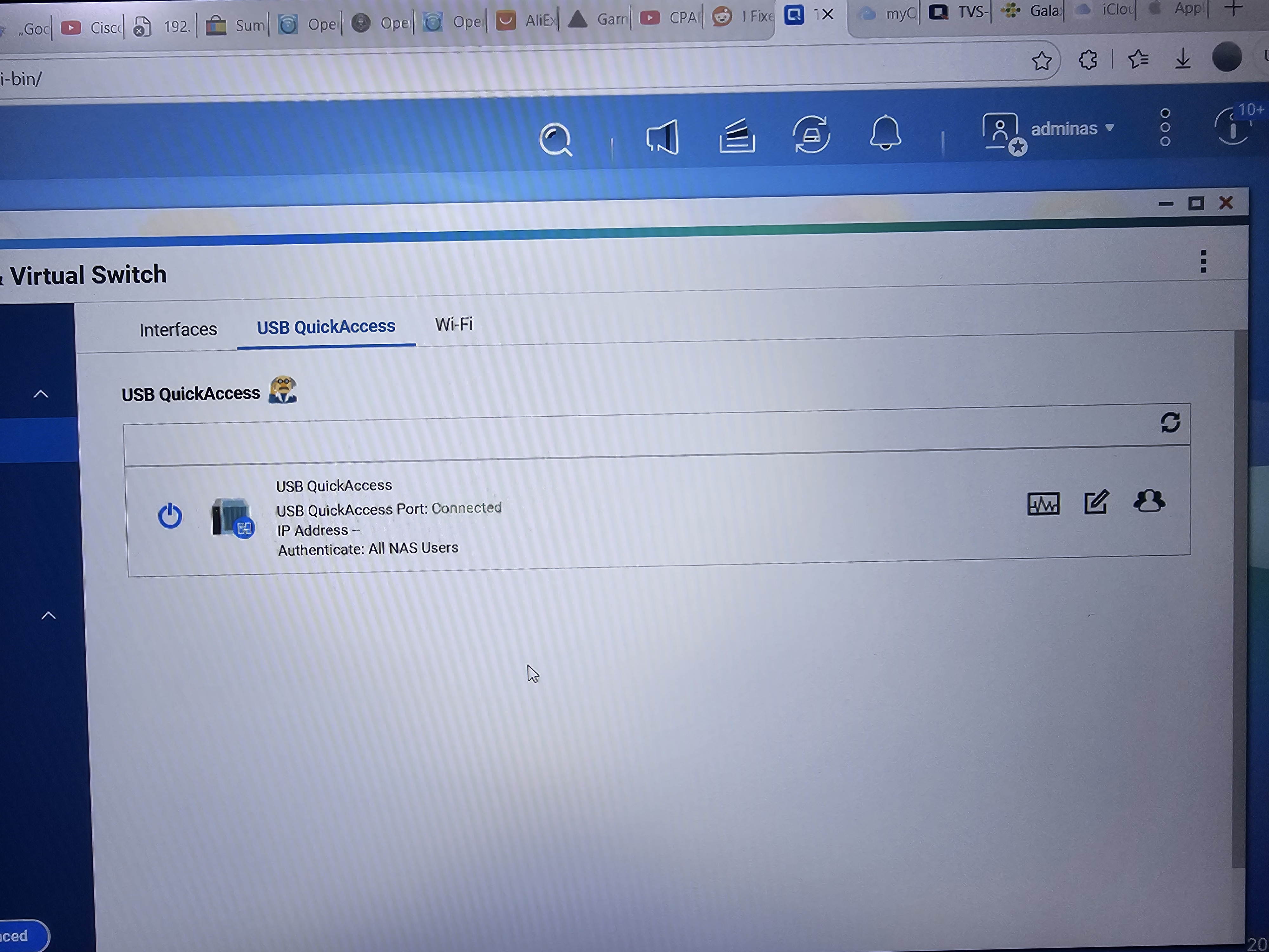

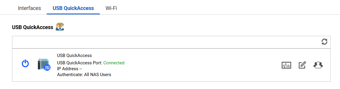

I can’t configure anything on my device. It simply doesn’t allow me to change anything in the areas related to USB QuickAccess.
It shows that it is connected but there is no IP address.
